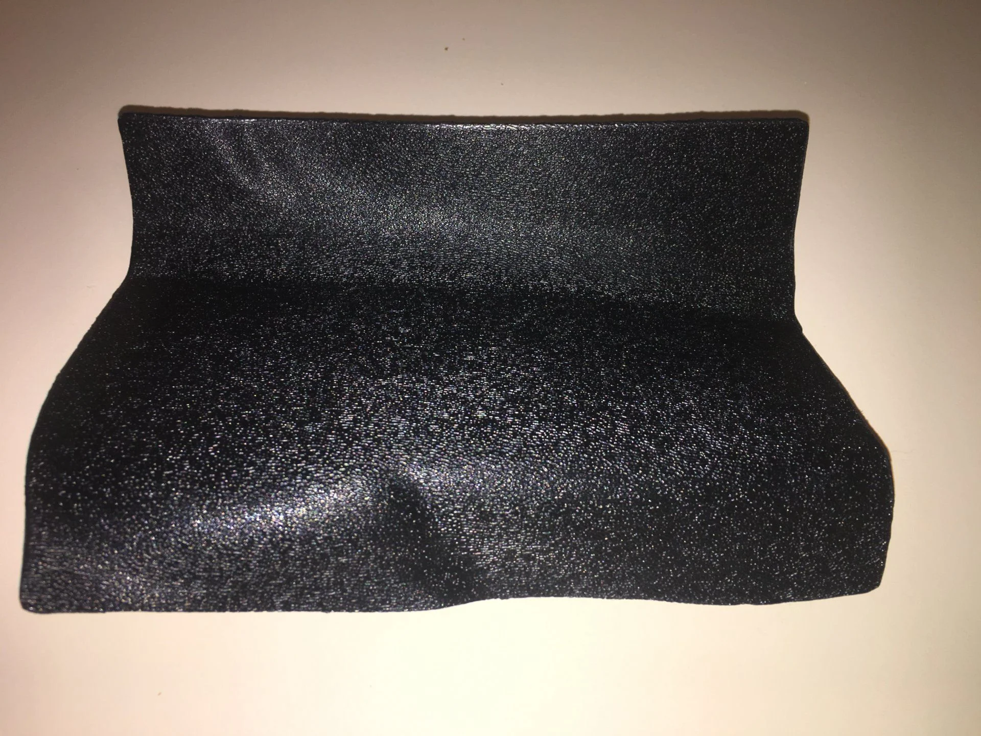

I decided to do something about it and picked up a 6"x12" sheet of 1/8" ABS plastic on eBay for $3.49 shipped. This is an ideal product for the application as one side is textured (to match WeatherTech's finish) and the other side smooth for easy adhesion with 3M Velcro strips:
After a half hour of forming it with a heat gun I trimmed the sheet down and came up with this final product:

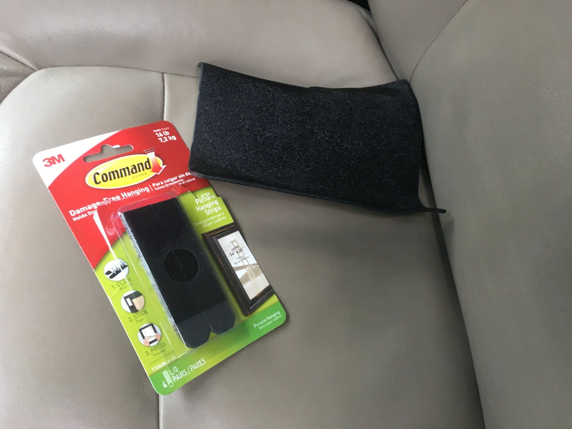

I then used some 3M HD black Velcro strips (two to be exact) to adhere the dead pedal cover to the plastic pad on the foot rest:

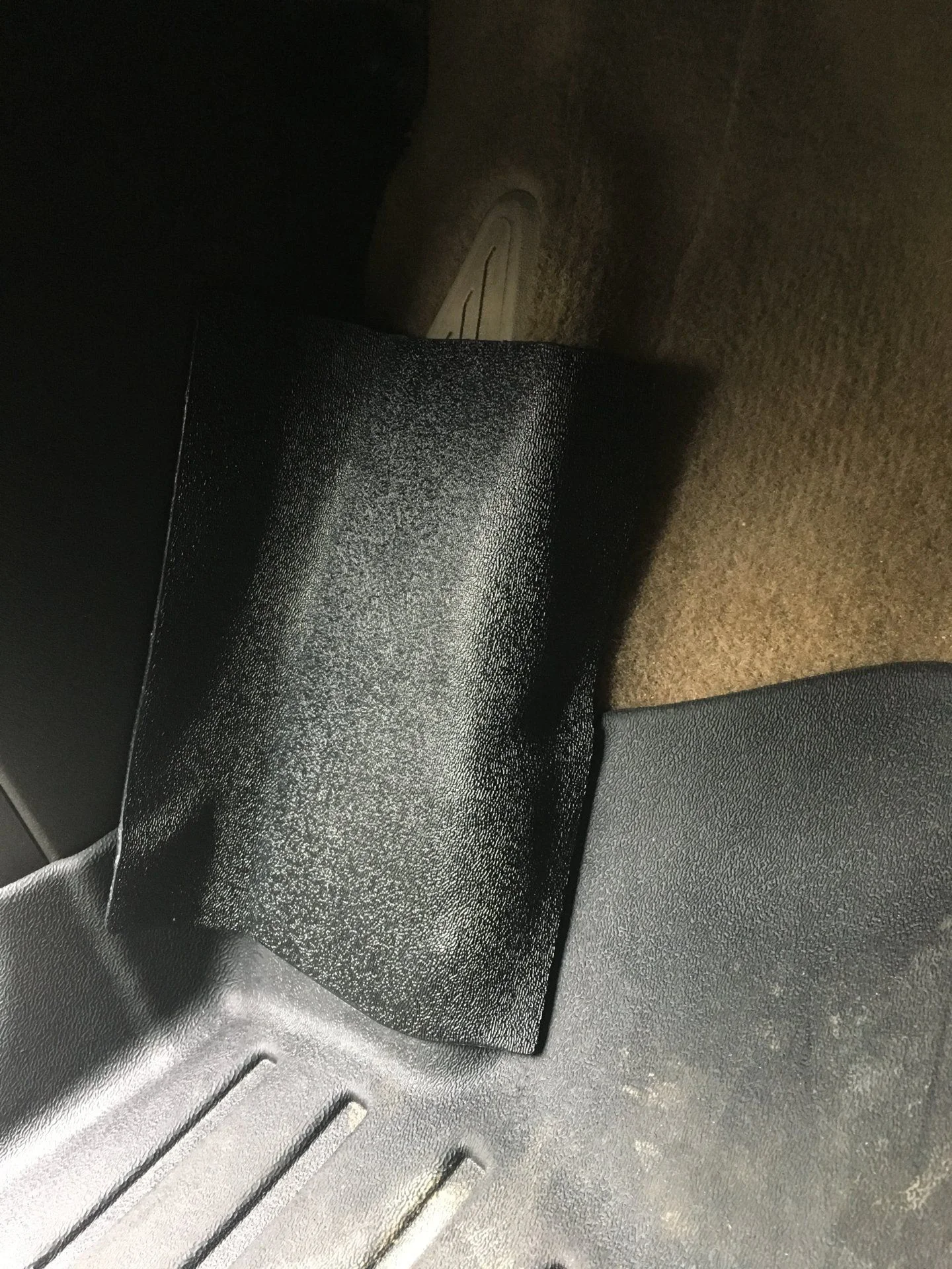

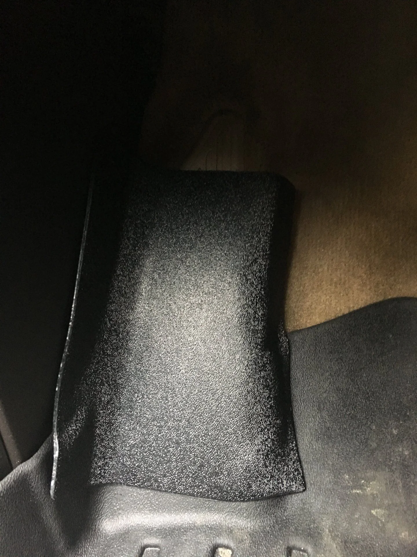

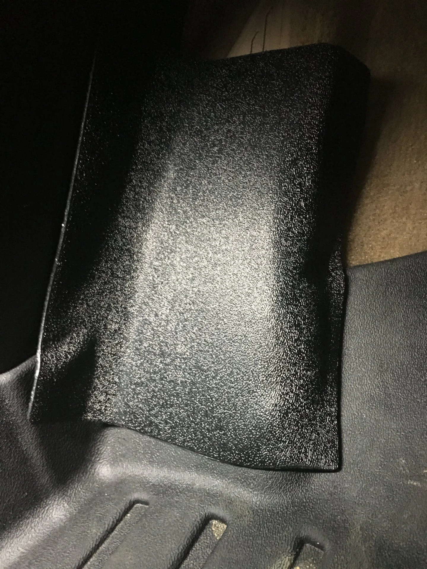

Installed on top of the dead pedal and WeatherTech mat:
I decided to leave the top 1.5" of the pad exposed as my foot does not rest much higher than about an inch or so above the top of the floor liner. I also found that the bigger the piece of ABS, the more wobbly and unstable it was on the dead pedal. Therefore, I trimmed it to only protect the area needed. A lip was left on the side to protect the OEM kick panel from the edge of my boot.
