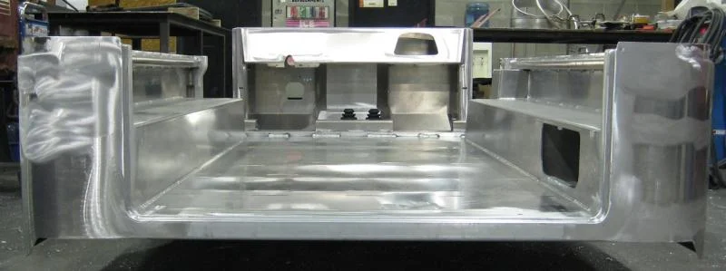

Wow, that's beautiful!!! Are you going to be setting/mounting the doors, limiters, etc. yourself? Or is that one of the to-do's that Aqualu will take care of before crating?
Can't wait to see it painted. Are you going to bedliner or paint the interior?

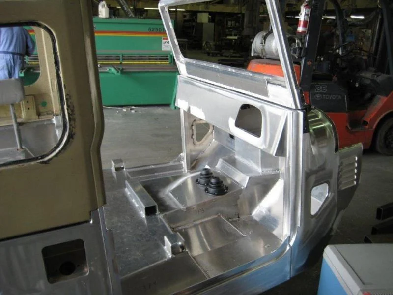

Oh man! I sure wish they had those tubs before I cut out all the crap on Patches. That is beautiful.:clap: Only problem I see is that the openings at the bottom of the rear doors may not be rounded enough for the 79-84 rear doors. Has anyone had that issue, or am I imagining things?
Josh
Josh
That was one of the things Todd and I discussed today. He was going to fill that area in with aluminum on the rear to match the current radius on the stock tub.
So no....you are not imagining things. :)
I will be mounting and drilling in everything in on my end. I sent the hardtop sides with so that they could make sure everything fit up perfect on the first proto type.
Thinking the SEM bedliner bottom and interior right now.

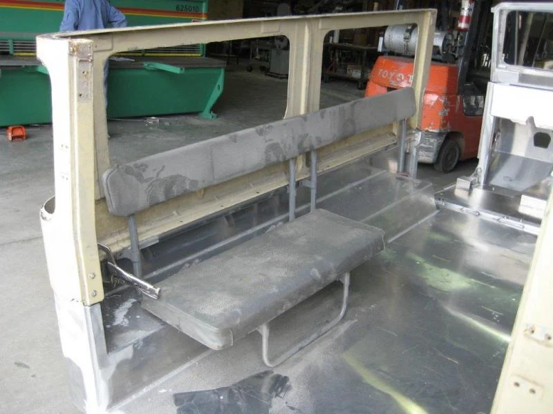

Front seats will be stock buckets. The right seat will the the bucket that came with troopy, the new Left bucket seat will be the same style, but out of a US FJ40.
As far as the rear I plan on installing the stock rear bench seats facing inward, so no change there. Now...that being said, I do want to fab up something for 2 child seats....since I have 2 little ones now. I haven't figured out all the details yet, but I plan on fabbing something that bolts to the fasteners that will now be coming through the floor and bolting to the stock frame mounts. With this aluminum tub the bolts come all the way through the floor now from my understanding. So that will allow me to use those same bolts and make something that I can bolt a forward facing seat too, and then fasten the child seats to that. Or make something very specific that the child seat bolt to. Either way I want to make something that when the kids out grow it I can just unbolt, put the bolts back in, and make it look like nothing ever happened.

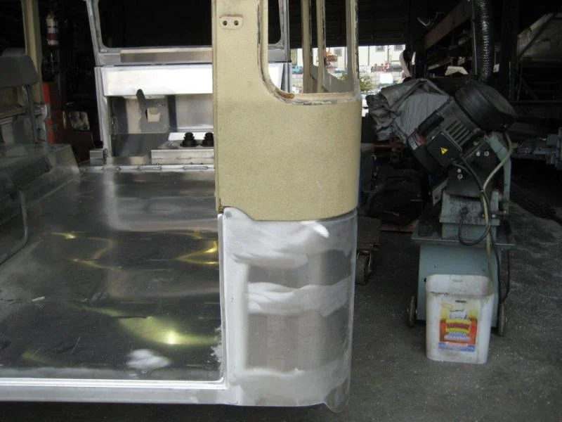

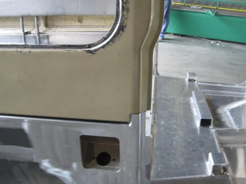

Just got a little update from Aqulau. Couple pics of the rear sill where they filled in with aluminum to match the radius of the rear ambulance doors.
