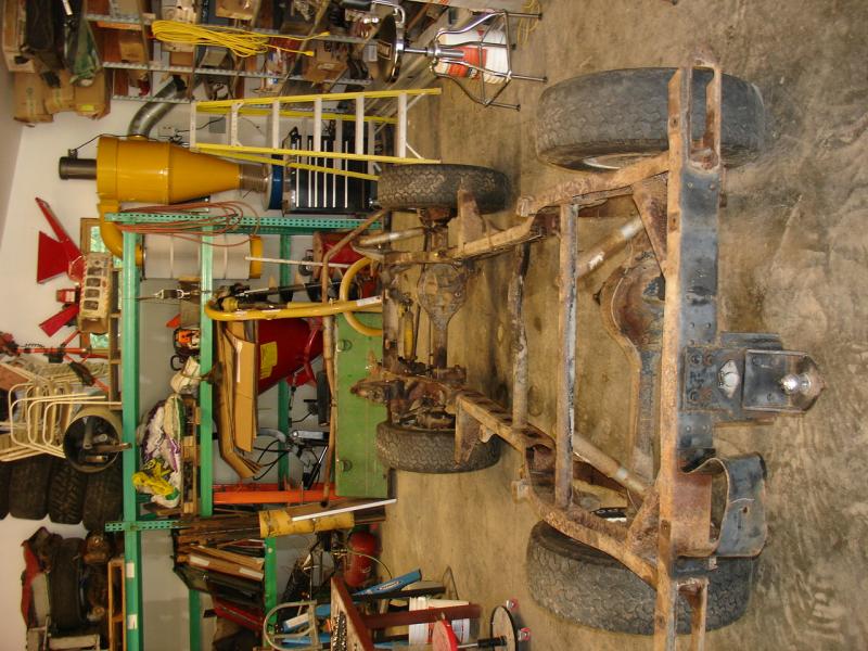

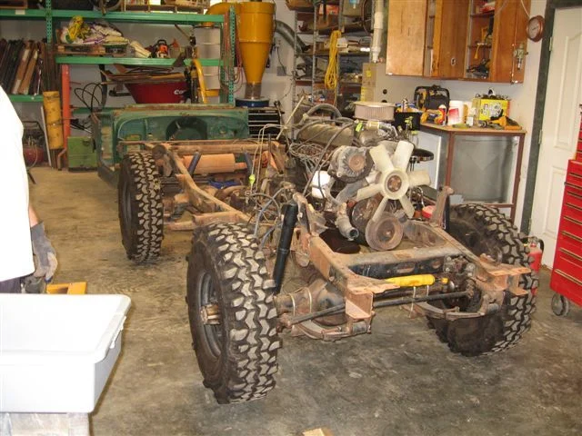

down to a rolling chassis

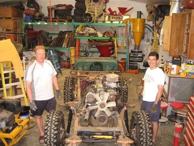

Down to a rolling chassis. We rolled the 75' in last night, and now I get to strip this down. I already have begged Erik and Rob to assist me with the GM Saginaw power stearing conversion. Once I get it to a rolling chassis, I will see if anyone can help me understand the tricks to this process.
The question I am pondering is that I want to switch the front to disk brakes. I have two options.
1. I have a front axle from a mini truck, that we can take a part and put on -- I have no idea what year or what this came from though.
2. I have a 79' fj 40 front axle with factory disc brakes that I could swap out the entire front axle, however I have no idea what gearing is in it.
Any thoughts?
pics
pic of the chassis
opt 2 is the easyer one, to figure out the ratio hold one hub and count the number of times you have to spin the pinion to turn the ouher hub 1 rev, and devide by 2. a 79 should be 3.7:1. any questions give me a call

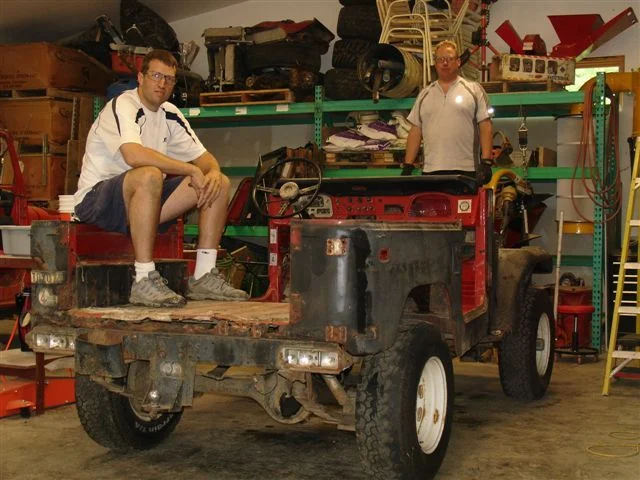

My friend from Chicago Kyle was in town and wanted to play out in the garage, so we tore down the 75' today. A few things
1. We found a bunch of rust on the piece of metal between the windshield and the black dash pad. looks like I can weld a patch into the back of it and then seam seal it.... any thoughts?
2. I wanted to try and start the motor, since I have never heard it, and could not get it to fire. I was getting a very weak spark off of the spark plug wires and (using ether) could not get fire.
My question may sound silly, but it has been a while since I played with ignition. I connected the battery positive to the resistor, and the resitor then went to the positive side of the coil, the negative side then went the distributor on the connection on the side (points). I got a spark off the plug wires, however it seamed really weak. Any thoughts what I am not doing? Or what could be wrong?
3. It appears to be a california car, any thoughts on the smog equipment? SHould I just cap off the stuff, or is there I should undo, that voodoo, that california does.... so well.

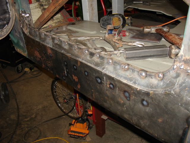

Off with the rockers
Well, my other buddy, Rob (prior life body man) came and helped the other Rob and I out and we got both of the rockers off.
I was on the fence about just cutting out the bad part instead of taking it all apart, but now I am so glad that I was convinced to cut it out. At some point in time, someone just left the old rusty rocker on, beat it in a little, and scabbed a piece over it, hiding the rusty mess. So, we cut it all out.
We also cut out the scabbed pieces that went where your feet are at. Again, they were hiding the rusty parts. I will cut out the old and replace with some parts from my donor vehicle.
Here are pics of the progress....
Thanks to Rob and Rob...... :clap::clap::clap:

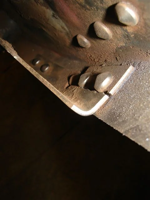

Well, the question I keep asking is when should I stop.... well, I discovered that the prior replacement of the floorpan was not quite up to my standards. The old flange of the old floorpan was not removed on the backside across the entire tub, so the new flange was welded to the old rusty flange which was falling apart. They also tacked the top, however I just want to do this "right". So, out came the floorpan. It sure looks different. Appears that I need to take and make a little patch where the floorpan attached to the back, but we should be done taking metal off.
Here is a pic of where we are.
Oh, and my buddy Rob (shorty) got the replacement foot area from my donor rig straightened up and it is about ready to weld in.
My other buddy Rob got the passenger side floorpan out and ready for replacement. I need to bend a piece at the welding class this week for the passanger side and we should start welding.
One question.... Anyone have measurements where I can check to make sure we didn't twist anything before we weld it back up?

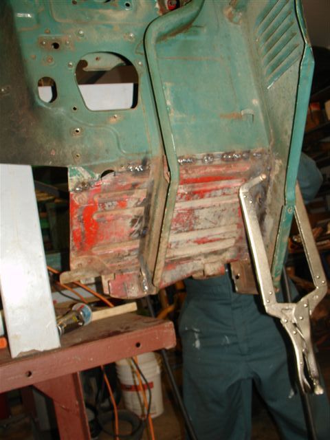

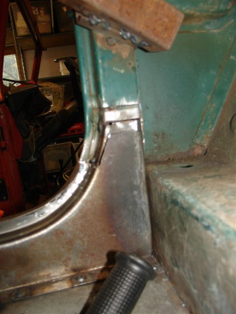

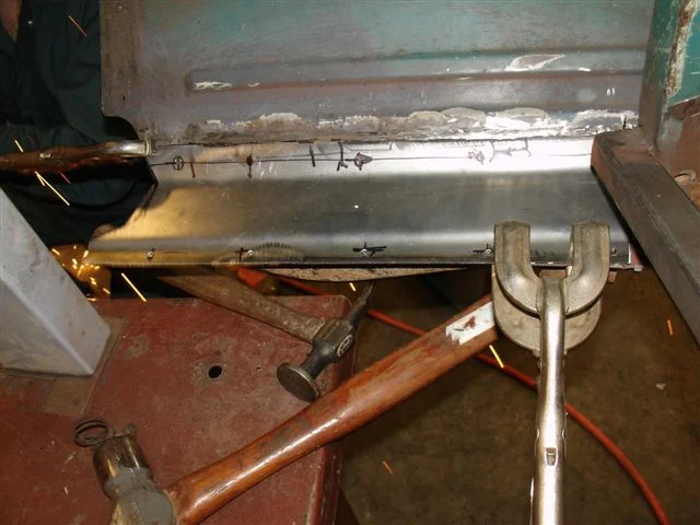

Finally, after a month of hacking all of the rust off, we are finally putting nice shiny metal on the FJ>
Thanks to Andrew and the welding class brake, we fab'd a new piece for the passenger side feet area that fit like a glove. (how about a "fit like a sock" given the area). A little welding and it looks stock.
On the driver side, after a little TIG welding some areas at class, and a little more fitting, Shorty (smile Rob) welded in the replacement foot area. It looks awesome. You might think he knows what the heck he is doing.
Elsewhere, after pulling off the old floorpan we found some rusty areas behind the driver seat, so we cut it out and replaced it also.
Lots of progress!! Next up is to do a bunch of grinding and cleaning, then start fitting the floorpan after working on some level work.

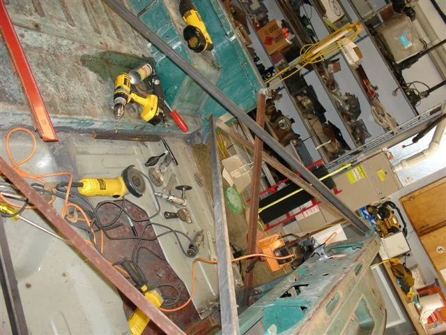

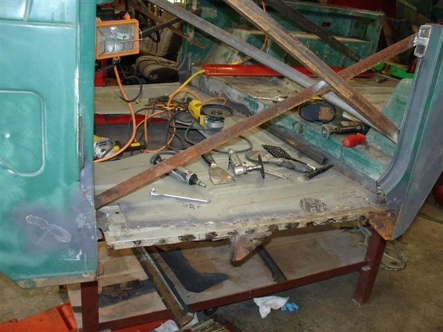

update
So, you all have been there, but I keep taking pictures after a bunch of hours working and they don't look any different than last time. Hours of welding and griding don't make the panal look much different than when it was hanging there. Sort of depressing some days.
Well, the good news is that the doors fit finally. The drivers door was an absolute head scratcher until shorty came over, did his magic, and as Julia Childs would say "wholla we have the chicken!"
So, both doors are hung and fit good, the inner and outer rockers are welded in place, and about 80% of the floorpan is welded in place -- I need to get it off the bench to weld the final parts. A couple more hours of welding and grinding and I think we can take out the temporary support metal and get this back on the frame.
Andrew is going to set me up with some new mount material, so I should be ready.

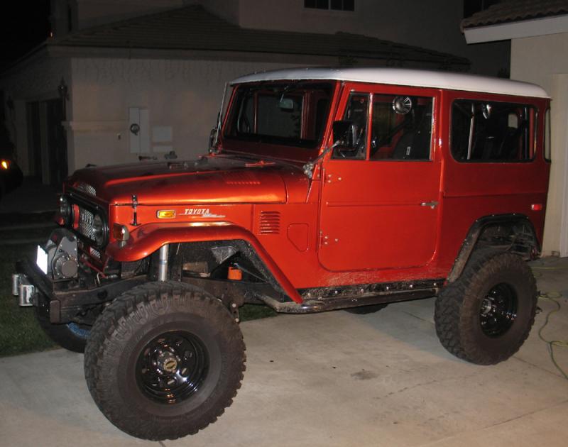

forgot the current color thought
I know the purist will hate me, but I promise to put my bezel on right.
wow you work fast. like the color
Ha!! I like to think that I work pretty fast, however not that fast. That reminded me of a story that my friend shorty said...... he had to draw a circle on the ground with chalk around his dad to see if he really was moving. Now that is slow. I am somewhere in between
I wish that was mine in the pics... unfortuanately, I am a detail person, so it is going to take me a while. With luck I will have it rolling next year. My goal is to have it media blasted, primed and undercoated before January.
The pics are from another helpful IH8Mud member. I have been on the fence about what color to go with. I like the desert tan however I had this crazy idea about copper and I asked for pics and got those. I think it may get a little attention.
Kelly

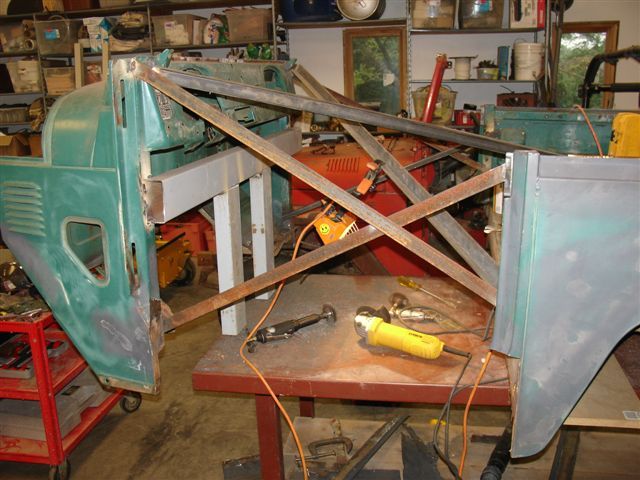

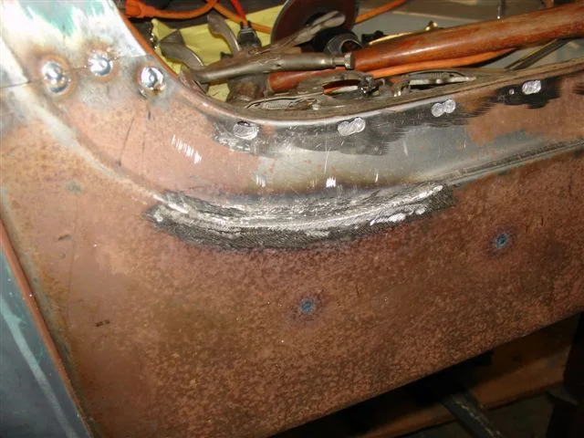

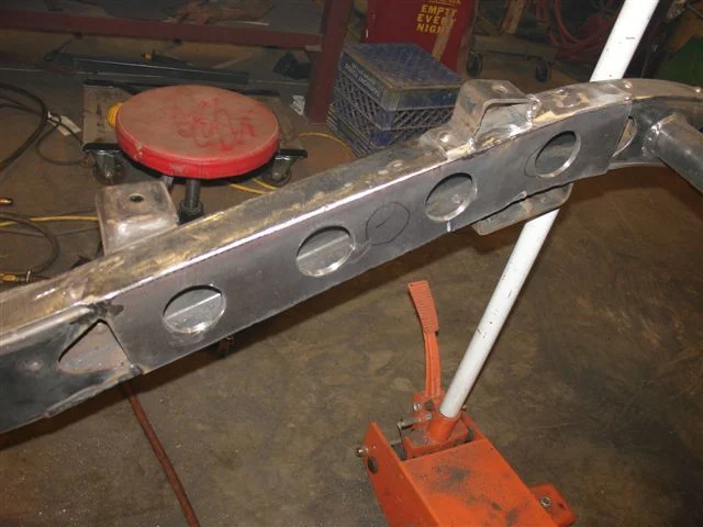

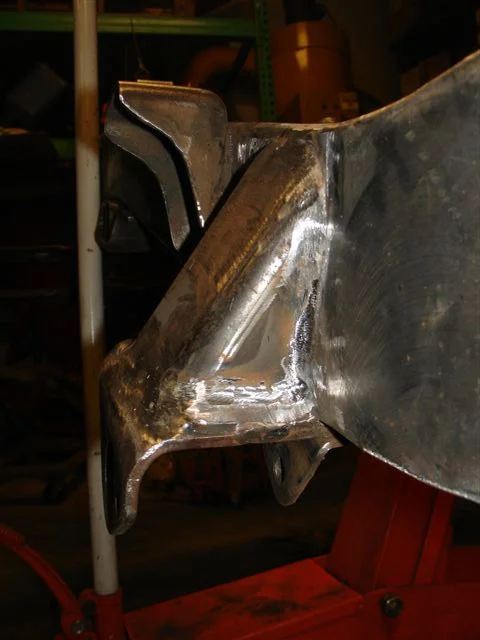

frame work
Well, the plan to have the tub media blasted is on hold.... I most likely will blast it myself in late April or May..... so I may ask to borrow a big air compressor then. So, I have a few weeks until work heats up such that I will not have FJ time, so I have focused on the frame, trying to get it ready for POR 15. Well, I worked a bunch this weekend on it. I finished welding on some 1/4 plate reinforcements to the frame where I plan on bolting on my sliders. Then I worked on the rear bumper that the PPO put on it, I wire brushed, sanded and ground the entire frame and when I thought I was done, I was blowing it off and noticed a crack on the back of the boxing near the rear spring (front perch) :bang: See pic below.
Being a goal oriented person that about crushed me. Well, a little research on MUD and found that to be a typical problem area, I TIG welded the crack together, then wire feeded a bead on top of that at the crack, then I welded the inside and outside of the box together. Because if a little is good a lot is better, I then made some supports to reinforce the perches -- a design I found in the AZ cruiser section. (ROB - check out the triangles!) Then just to make sure that I overkilled this issue, I boxed in the rest of the frame up to the rear shock mount bar.
So, now I wait for the degreaser and etcher and then POR 15 and this one is in the history books.:cheers:
