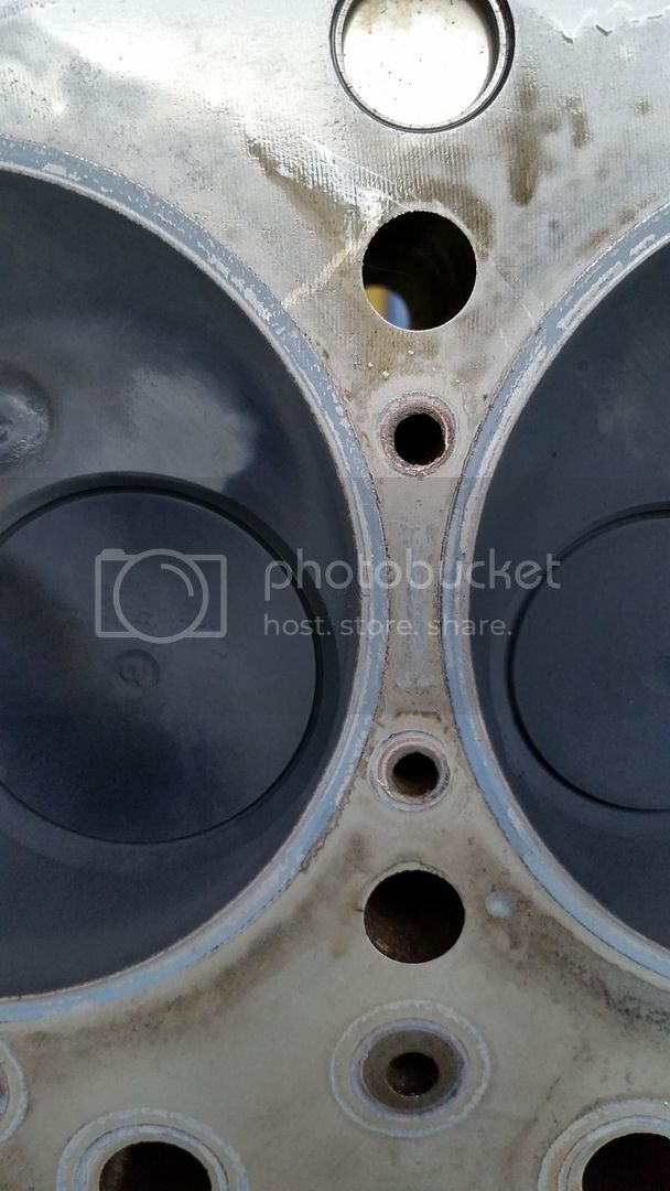

Well tonight I got an hour and a half in the garage. I was able to get the rest of it stripped down and pop the head off. I'm getting quick now 3 hours to get it off taking my time.

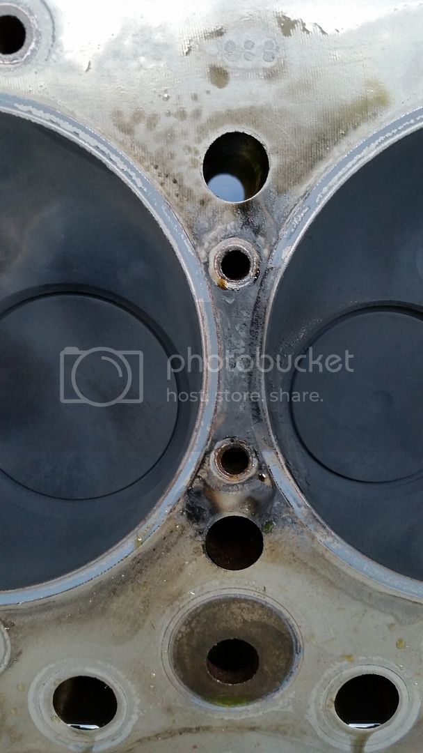

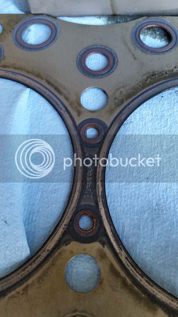

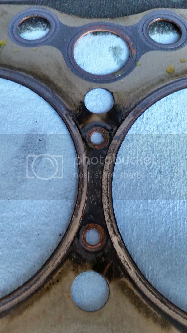

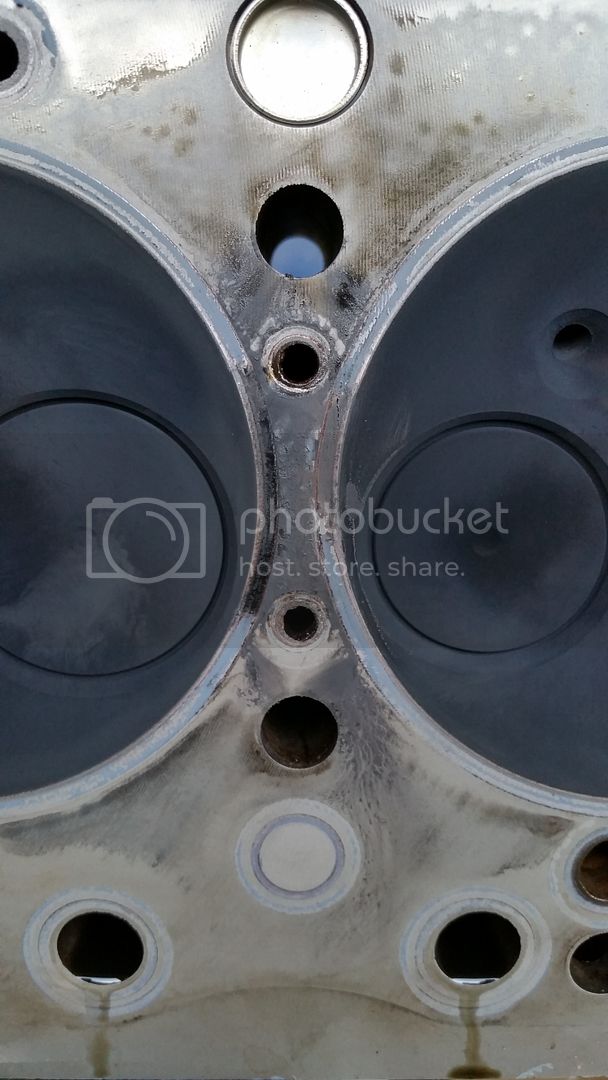

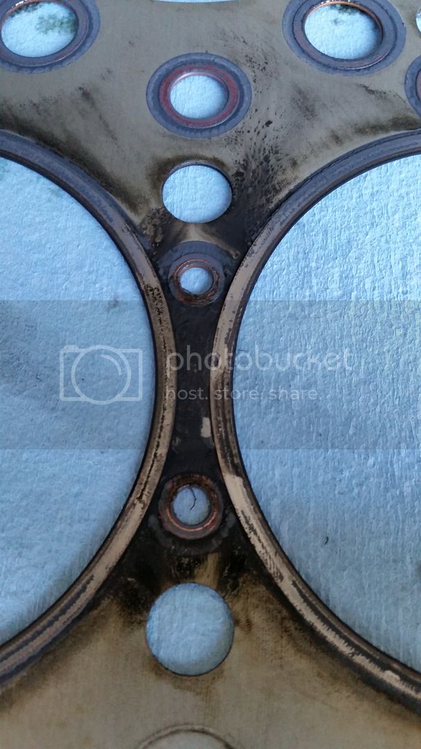

Anyways yep she blew the head gasket again. Now the crazy part..... It blew in a different spot. Cylinder 4 and 3 where fine (blew big time last time) cylinder 2 and 1 blew this time. I caught it so quickly this time it's kind of cool to see the areas it blew and the patterns it left. Cylinder 2 blew on both sides cylinder 1 blew only on the side near cylinder 2 and much more mildly than 2.
Not blown... 3/4 head
Not blown... 3/4 head gasket
Head 3/2 blown on 2 side solid on 3.
Head gasket 3/2 lots of combustion gas marks.
Head 2/1 both blown.
Head gasket of 2/1 blown.
So some intresting results, not really sure what was the cause. Head looks good, I'm still going to get the head surfaced. But other than that and more clamp from the head bolts.........?

Yeah I'd love to come check it out. I must say I'm pretty bummed out with the gasket blowing everywhere. I'm really suspect of the liner protrusion. If that is the case though perhaps getting a reciever groove in the head cut and run a modest copper o ring might do it. Just a thought. Increasing head bolt torque wount get you a big jump in peri cylinder gasket compression, although I am in favor of more torque, I suspect it alone wount be enough. Interesting to see the machining marks in your gasket. Perhaps a bit of permatex would smooth it out a Touch? What days are you free?

If the liner height turns out to be correct and the head is flat, and the leak has changed positions, to me, the only variable is head bolts.
Most likely the bolts were randomly installed the last two times the head was attached, which could account for the leak moving. Maybe the head bolts were over torqued/stretched at one time. I don't recall if you check the HB length?
Have you considered ARP studs? I found them for around $250 complete.
Just an idea.
Head bolts are Brand new, got them when the first gasket blew. Checked them all last night and and none are stretched.
I guess I need to focus on cylinder sleeves. I can't see any other way this would happen.
The head is flat verified by myself and the machine shop last time.

Did you check how deep the bolts go?
Arp isn't the solution right now. The stock parts hold fine to several times Jeremy's boost pressure when all is good.
I can easily check the bolt depth tonight. From what I recall they have decent thread engagement (they are Brand new Isuzu bolts) and measured the same as the original ones I replaced.
I don't thing head bolt torque is my issues as well. I think it's liner protrusion or head finish.
Sorry to see you are having issues. If this has been mentioned I apologize, but have you verified that your torque wrench is working properly? Were all of the head stud holes clean and free of debris? Did you lube the head studs? Too much friction could cause problems and have a stud/bolt not reach optimal clamping pressure but reach the specified preset torque? Just trying to help make some sense out of this.
