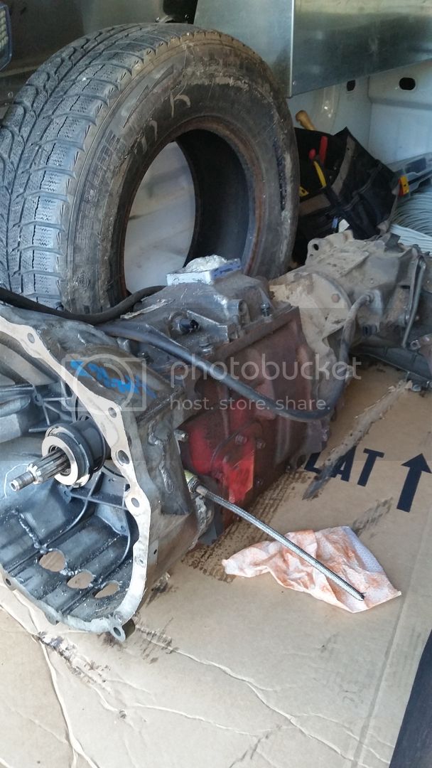

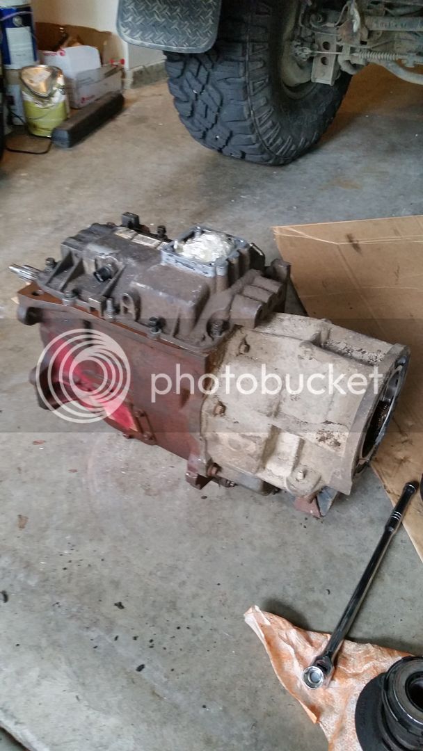

Picked up an NV4500 from a late model Chevy 1 ton. It's a 98 model so it's the one that has the livable 1st gear. I did not want the crazy low 1st since it's a very restrictive option. The one got can be changed from a chevy to a Dodge cummins nv4500 with an input swap.
I'm not sure at this stage how I'm going to attach it to the 4bd. I just got the transmission for now. I may make the back of my engine looks like a Cummins then I have lots of clutch options. Plus if this 4bd does not work out I just toss a 6bt in it ;)
Not sure what I'm going to do with the t case as well. I would really like to retain my stock AWD t case with new low range gears. But I also have a freshly rebuilt split case and Asin hubs if needed.
I saw that while I was pillaging your photobucket account the other day looking for turbo photos.
Is there no awd transfer to fit?
I can get an adapter for my existing t case. It's just unproven.....
