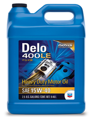

I changed it to Phillips 66 15w40 semi synthetic oil, and felt like a little difference on the behavior of the car when I accelerated. Like a lack of power. And it started to smoke blue sometimes, to I better started looking to go back to Valvoline... But instead of that, I bought this:
The Delo 400 LE, is recommended by PACCAR MX, Caterpillar, Cummins, Volvo, Mack, MTI, MAN, Detroit Diesel 4 stroke, Mercedes and Navistar.
The API category is the latest one: CJ-4 (Oil Categories)
So I thought that this could be a good oil for my 4.2 diesel engine.
What do you guys thing? Did I made the right move? Or should I consider another oil? Or go back to use Valvoline All Fleet Premium 15w40?

I use Shell Rimula R4X 15W40, the 1HD-T seems to like it and it meets JASO DH-1 requirements.
Seriously though, I wouldn't stress about the brand, as long as it meets the neccessary criteria, use it.
The DELO 400LE appears to meet JASO DH-2 and is backwards compatible.
Seems that actually is a good idea to use it. I will put it today to see how it goes. I will you guys know later.

I too live in Pura Vida land. You bought that at Pricemart didn't you. I run it in my 80 series 4.2 and it is very happy It also happens to be the cheapest place to buy oil.You will pay double any where else.

Run it.... I have for years and my motor is still running
Been running that exact same oil Delo 400 LE 15W-40 for the last 4 years. Great oil!

Thanks guys, seems that I went to the right side. I already changed the oil, and it has been running fine for few days, no smoke (just in the mornings), but nothing wrong with it.
