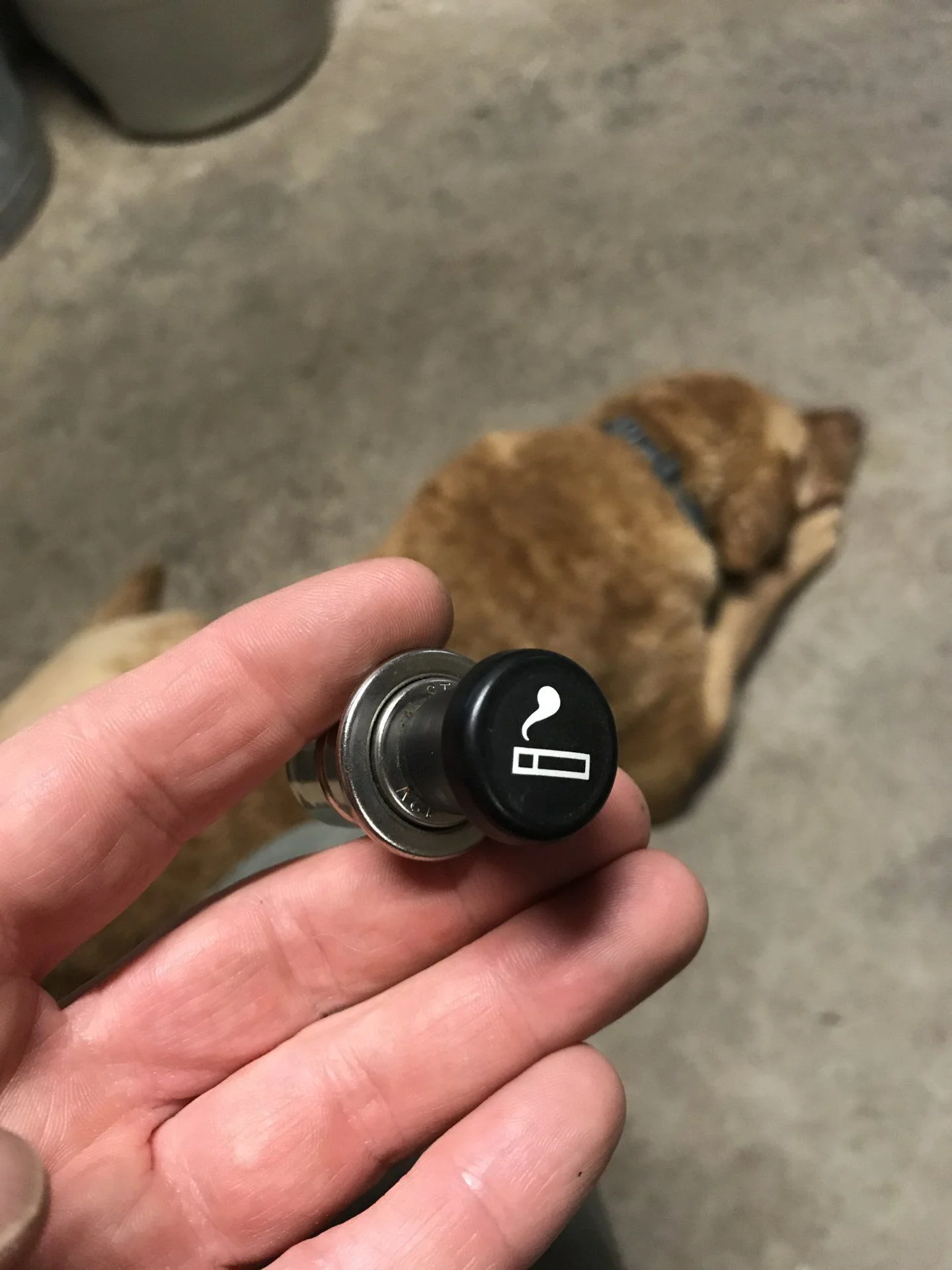

I just installed a dome light and it wouldn’t work. Fuse was blown. Installed a new fuse and pop goes the weasel again. Hmm. Wiring diagram led me to the lighter. If I pull the lighter out and replace the fuse my dome light works great so it must be this baby. It fits nice but it does look to be too new.
Looks like a later lighter, but it shouldn't matter. My FJ60 and FJ62 lighters look like that.
How many amps is your fuse? 15 A?
20A fuse. They blow as soon as I put it in. Its probably been like that since I bought it 10+ years ago. I just never noticed till I bought a dome light

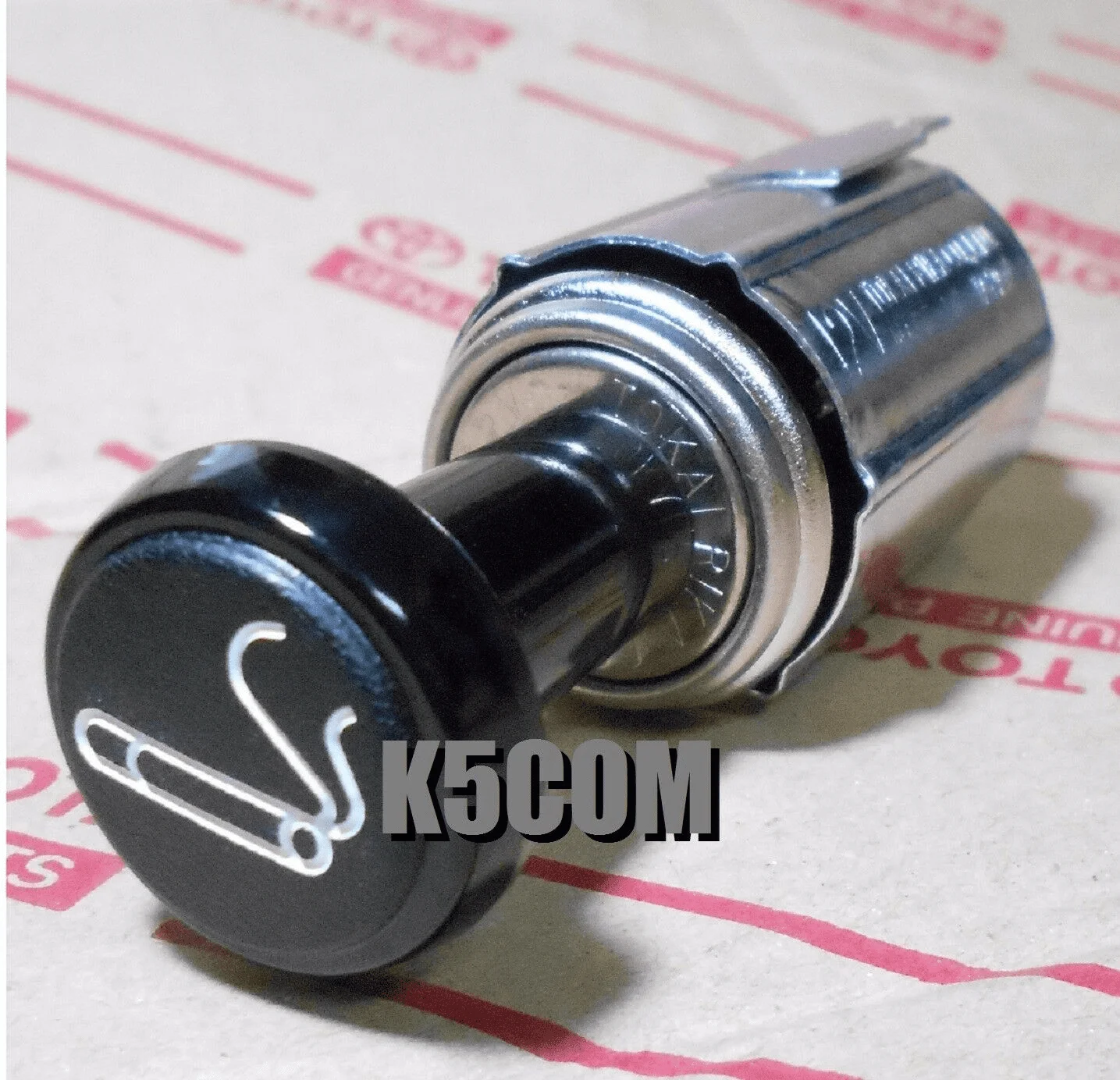

No , That is Not the correct Lighter , Element for your 77 FJ40
The OEM Parts Maker for a 77 FJ40 Cig. is
TOKAIRIKA Co. Ltd. JAPAN
This should be stamped clearly on the chrome lip part of the Element and also the socket itself

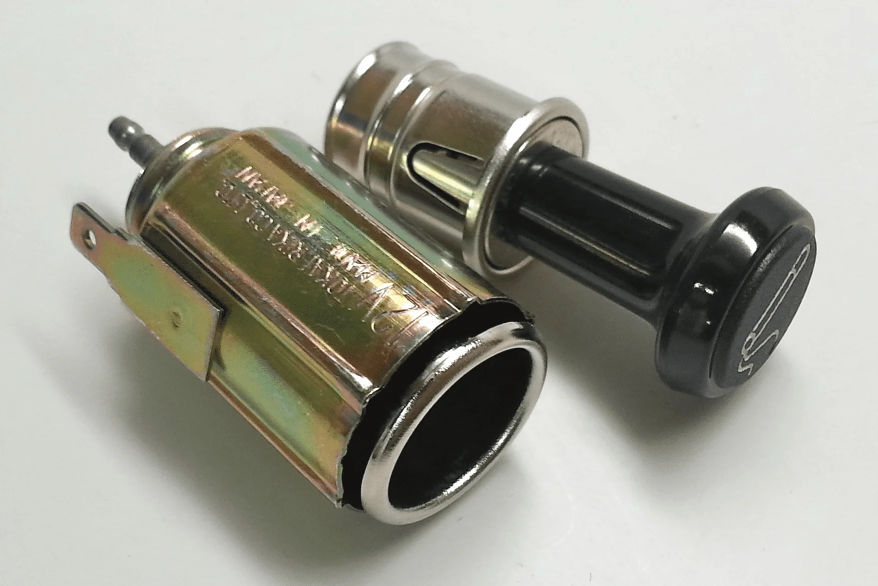

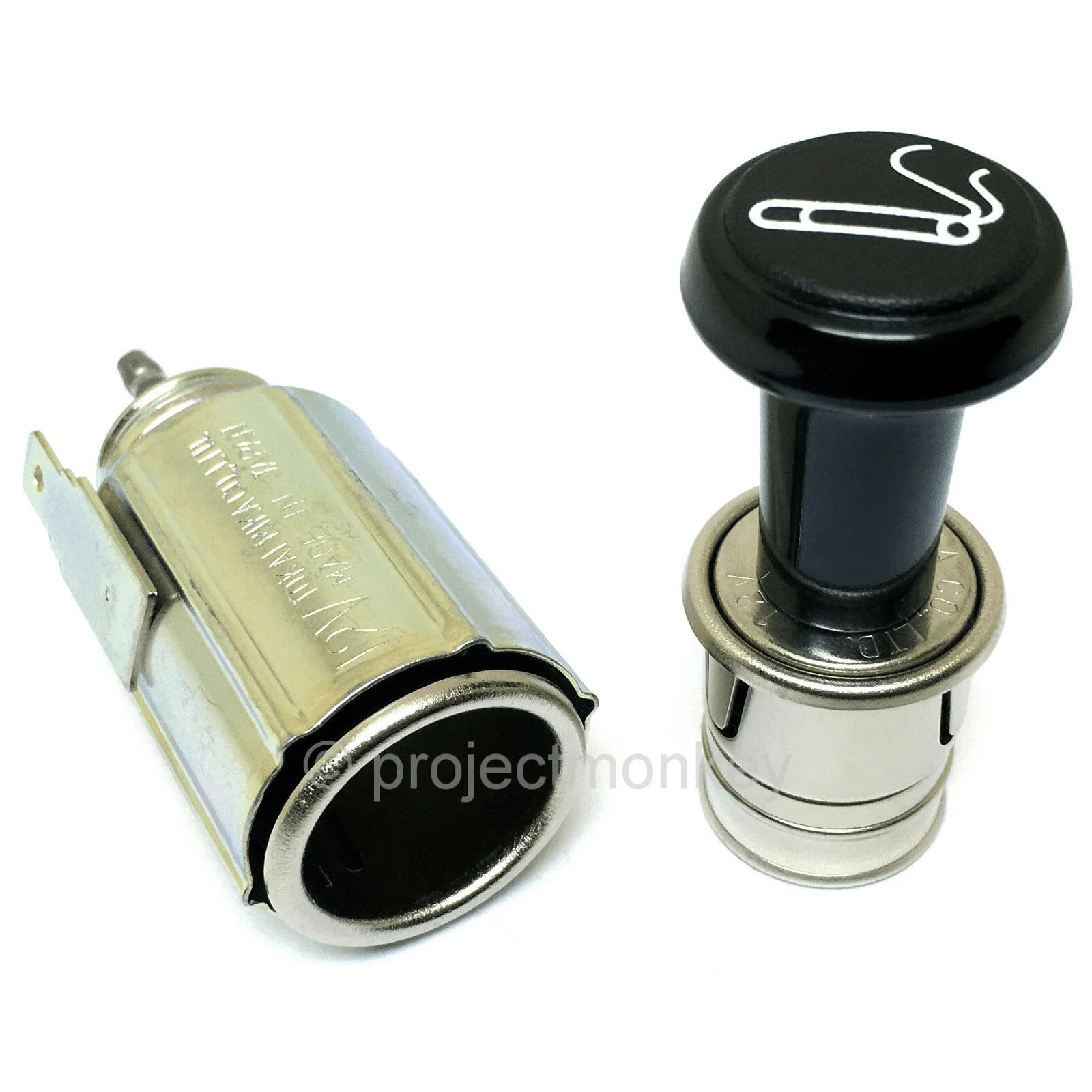

This is what u want to purchase from your Local Toyota Dealer :
85500-20042 part #
1946027
1946028
1946031
1946032
