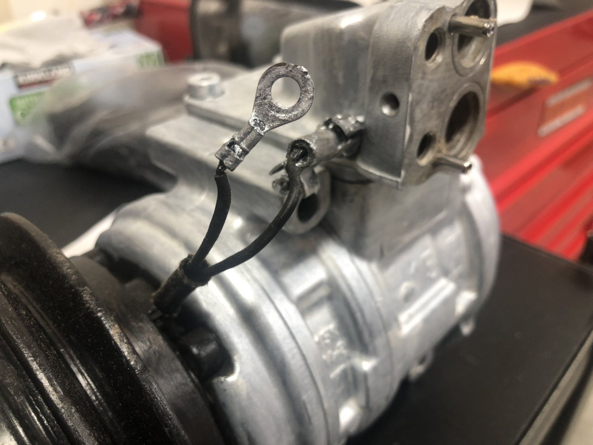

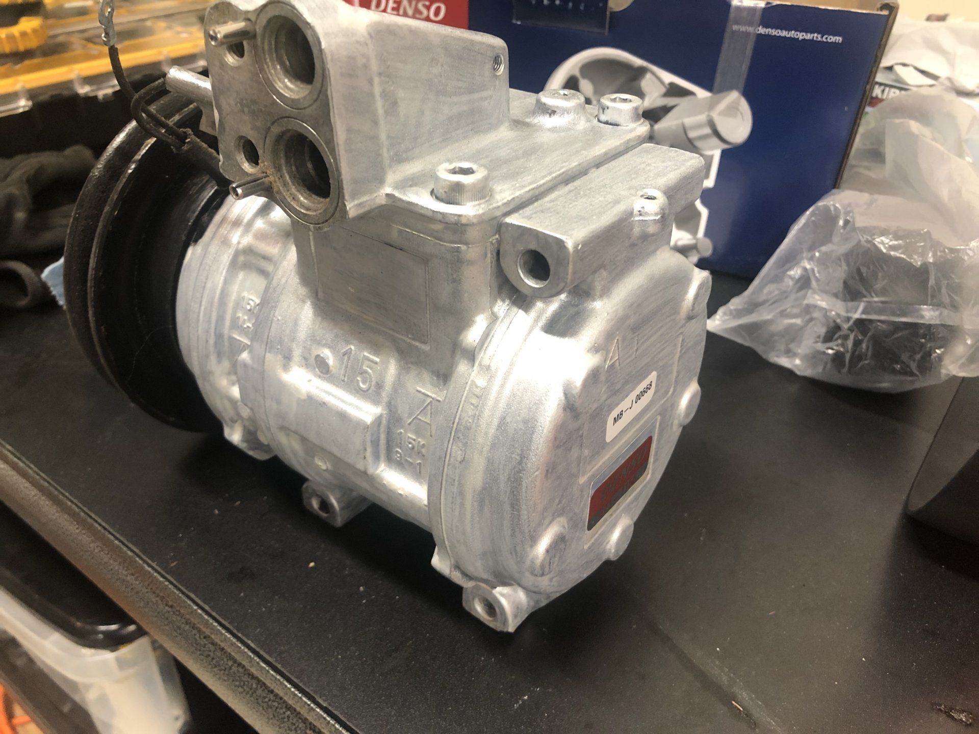

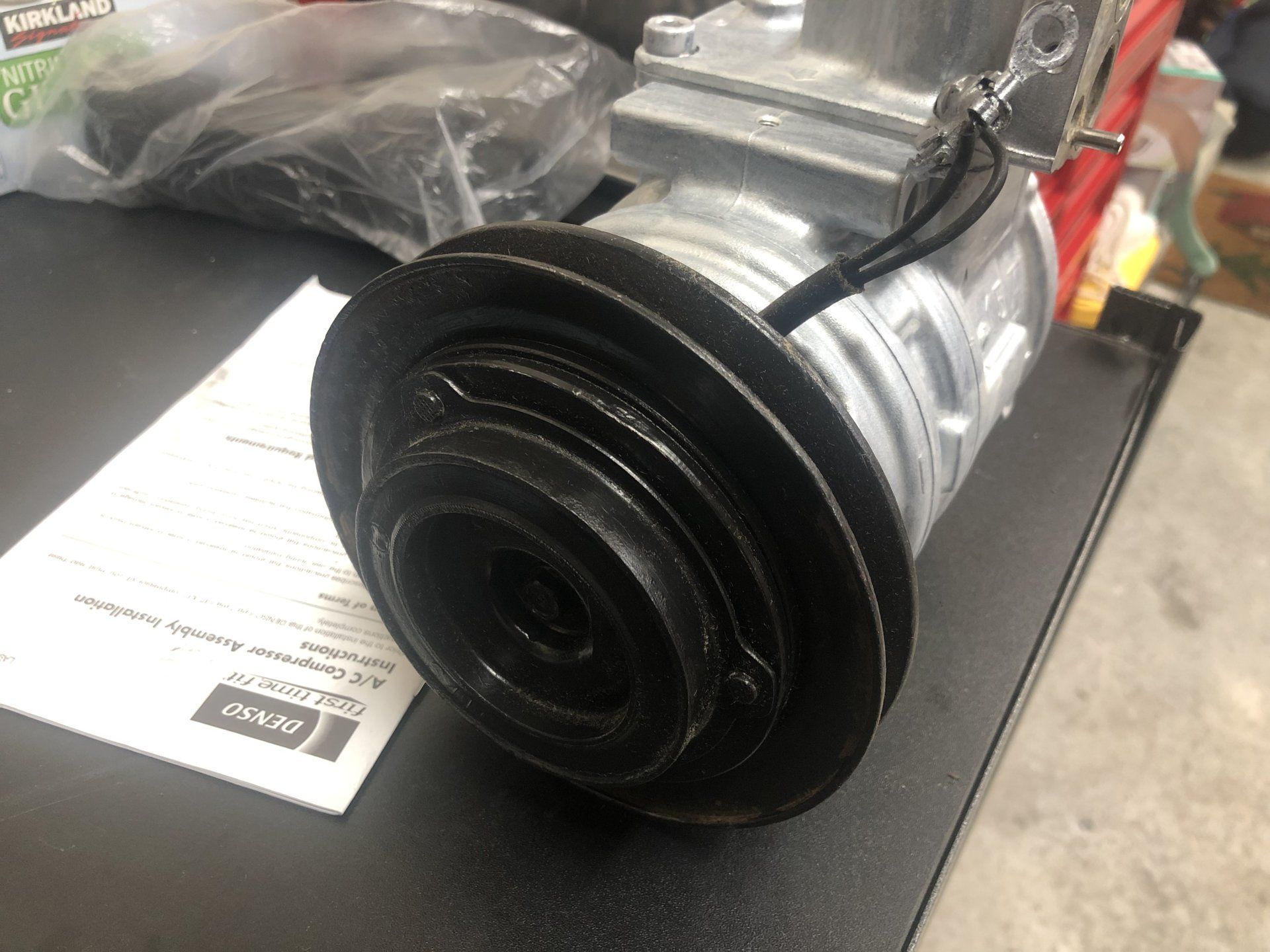

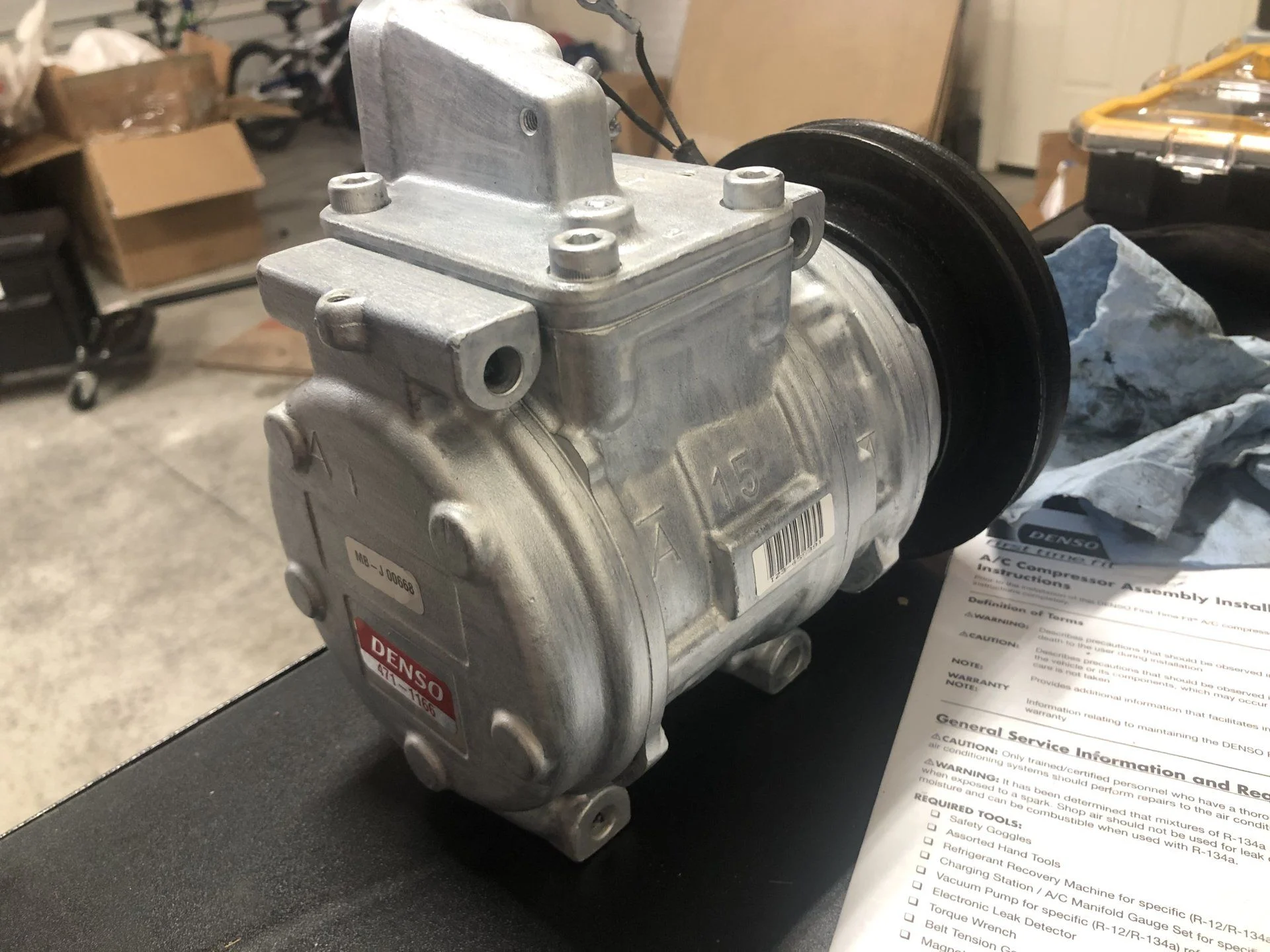

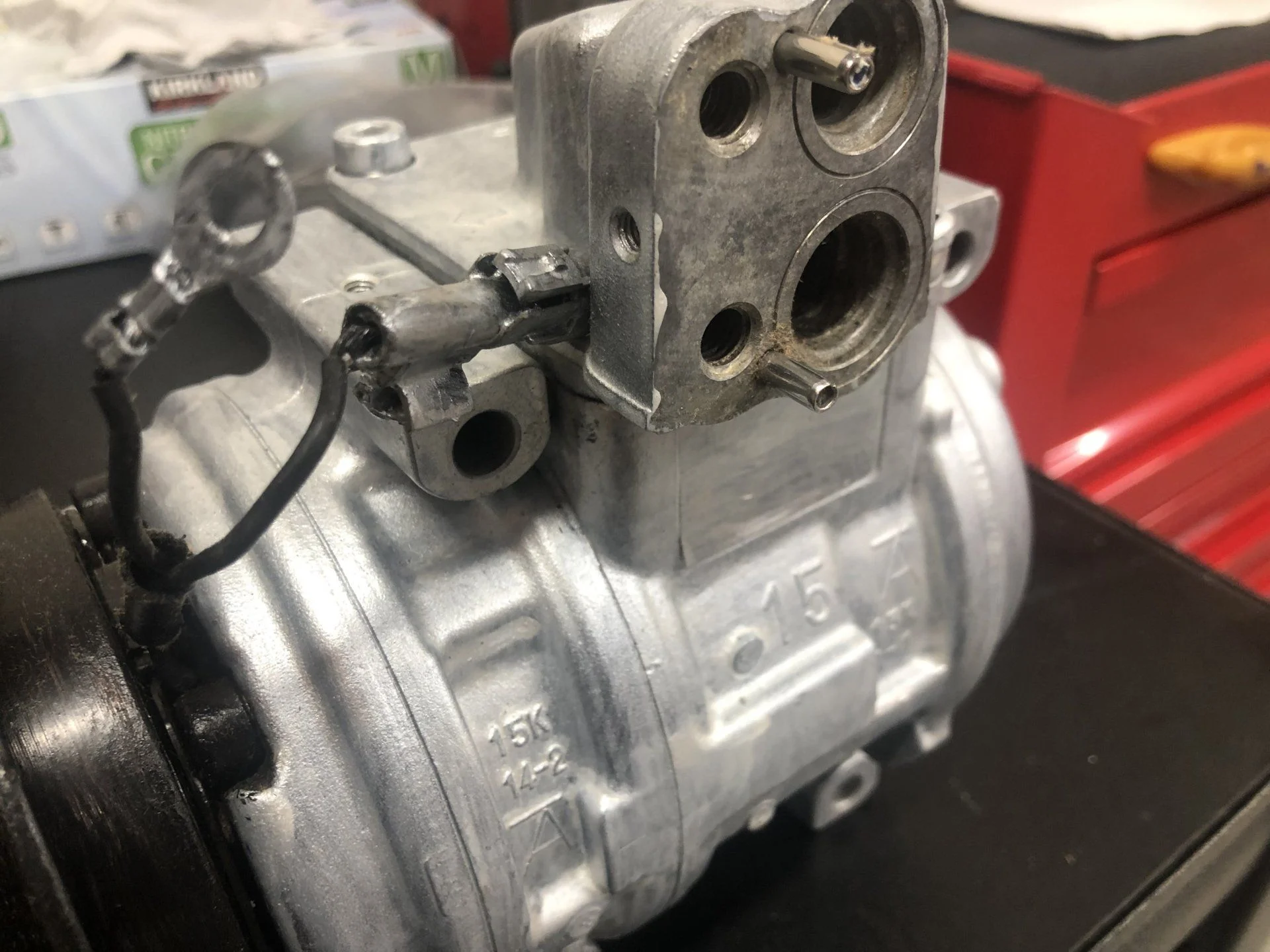

Ordered from Amazon, came in the correct box and has instructions, but the unit itself is whitewashed and the connectors are covered in a silver-ish paint? Is this all a factory coating for some reason or counterfeit? Has a Denso sticker but that’s not too reassuring.

Box and paper work look authentic; part looks tired.

Seems to me, somebody did the ol' switcheroo. As in, they bought a Denso compressor, and shipped back their old one for a refund... after spray-painting it and transferring the stickers over to it. Having personally installed a Denso compressor not a year ago, it came with a port cover/plate on top to keep oil from coming out during shipping. The plate with the inlet/outlet bolted to the top doesn't come with it, you reuse your own. You've been had, my friend.
I too installed a Denso about a year ago. Shipped the same way with a cover plate and oil in it.
What is the part number, if DENSO 4711166, should be brand new, at least the clutch looks used. Should look like this.
Oh Hell NO...!
That is NOT a new or even reconditioned part. You shouldn't even have a question about that. Send it back.
I remember ordering a Denso compressor, received two Chinese compressors from the vendor and then finally the compressor that I initially ordered... Should have a metal plate with the manufacturer's information on it? Either the vendor did a switcharoo or a previous customer did...
Thanks all, suspected it was swapped out or fake. The order was fulfilled by Amazon versus a 3rd party, so that’s disappointing. So I’m sending it back to Amazon and have a replacement coming.
