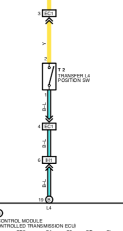

Here is a quickie that I did years ago to make the ECT button way more useful.
Effectively you take(de-pin) the B-L wire pin 19 on the 'B' connector, tape it up and set it aside.

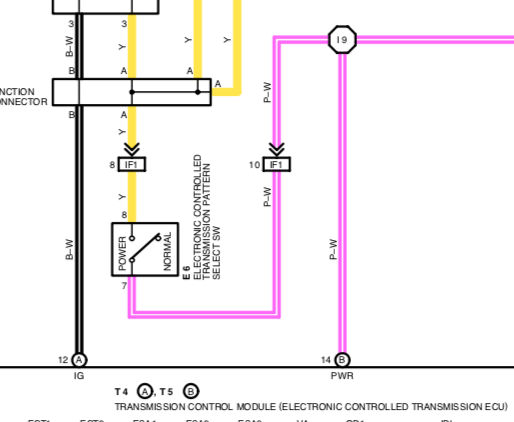

Remove pin 14 on the same 'B' connector, the P-W and place it in the original cavity for the B-L(pin 19) wire removed above.
This allows you to leave it in the softer shift points in low range which is super useful in snow, and also select the 'low range' high revving map in high range for Sand and other street racing activities. Also is really useful to keep the 'high range' map active to save your neck in low range. One of the best things I have done for playing on super low traction floater snow.

On my 93 and 94 the shift points are drastically different in low range. Holds the gears might longer than high range, and way higher than than with the stock 'power' map.
I would have to assume the 95+ vehicles have a similar map, but the wiring will be different since I recall they use a pcm, not a separate tcm and ecu

I'm not talking about having the ect mode on in low range, just being able to select the either the low range or high range maps via the stock ECT(pwr) button. Regardless of the which range you are in.
I wouldn't doubt the factory would disable power mode in low range, but the couple hundred rpm max you get is trumped by the couple thousand rpm you get in the low range map. So less noticable.
I'm running a '94. So does this mod basically keep soft shift points for both low range and high range, if ECT is not used and changes the shift points to the harder shift for both low & high if ECT is mashed? I'd love to have the softer shift in low range, especially 1 - 2!
Bingo! That is exactly how this works. All it takes is a small jewelers screwdriver to extract two pins, and stab one back in.

Do this while your in there and you will always be in power mode.
