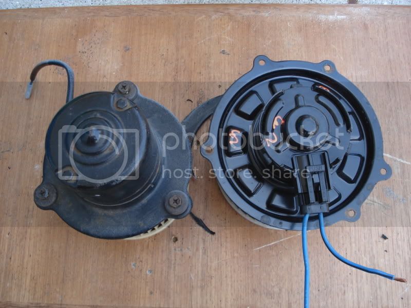

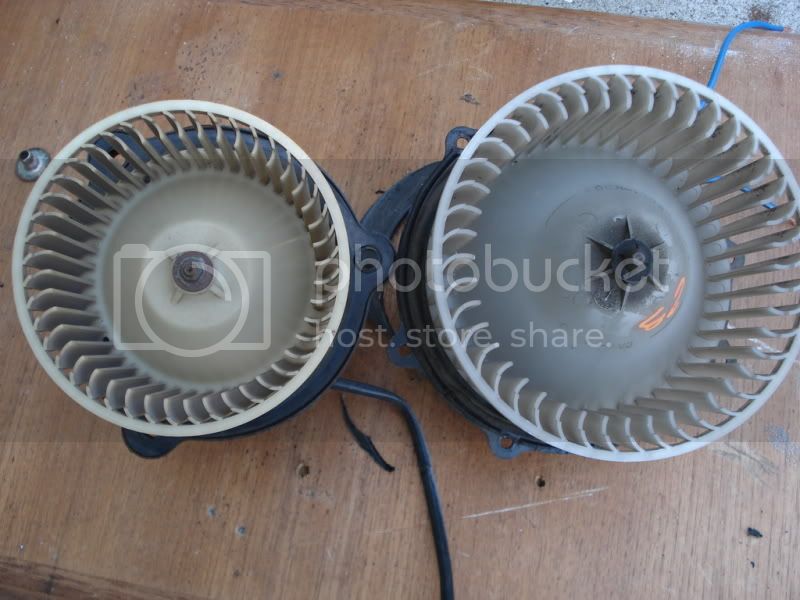

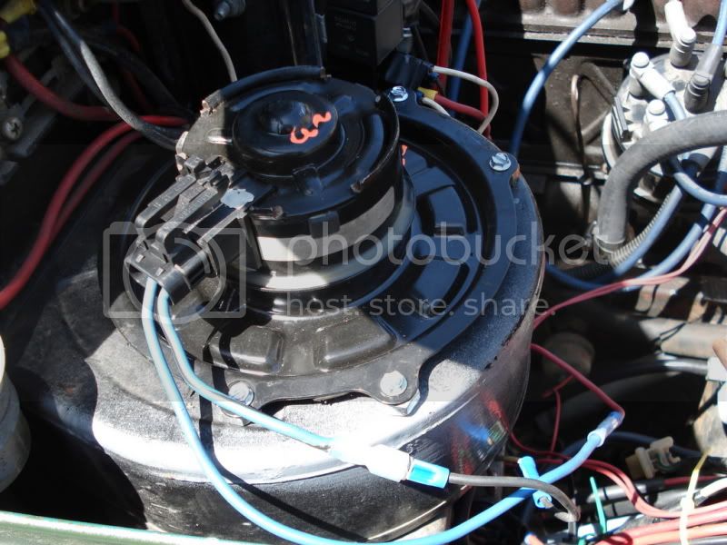

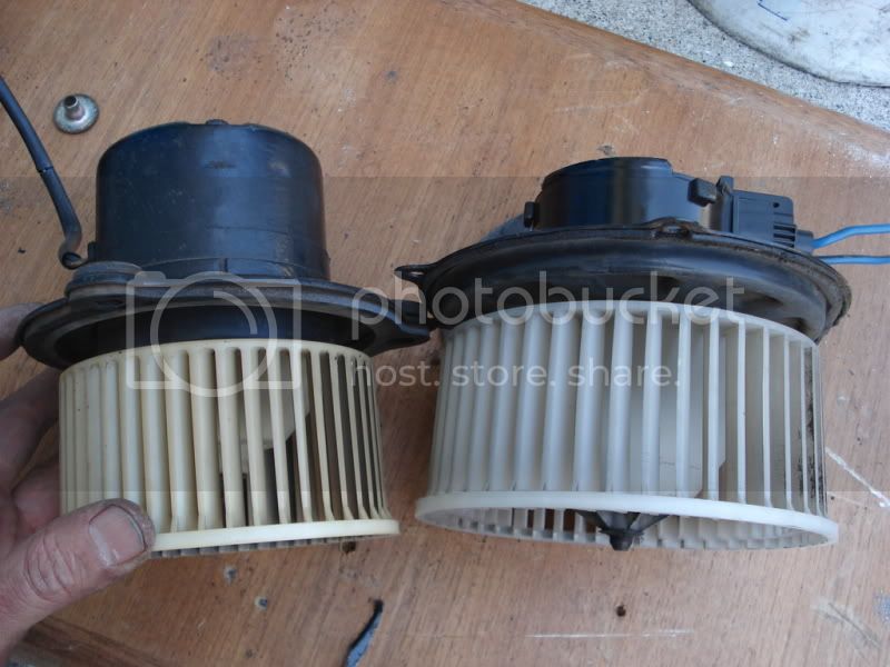

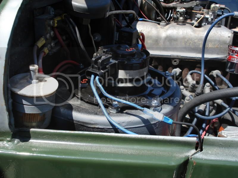

Finally got around to installing my ford (cough, cough) escort fan :D
Pickup an blower fan motor from a 90+ escort (regularly available in your local donor yard)
Don't look under the hood, check under the glove-compartment.

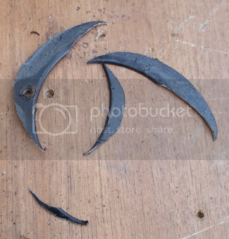

Remove the hamster-cage from the fan motor and use it as a guide to trace what needs to be removed from your blower housing.
(I used a jig-saw and a mini-grinder)
Re-attache the cage, and insert into the housing.
Take your time and rotate the blower flange until you find a spot that will does not interfere w/previous attachment bolts.
Drill 4 or 5 small holes for some sheet-metal screws and install.
I need to pickup some plastic spacers, and some weather-strip to complete...but it's pretty much done.
