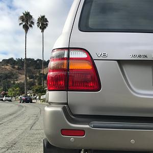

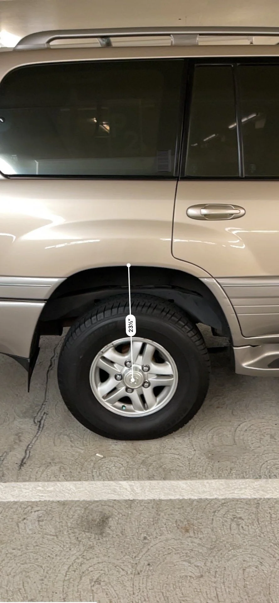

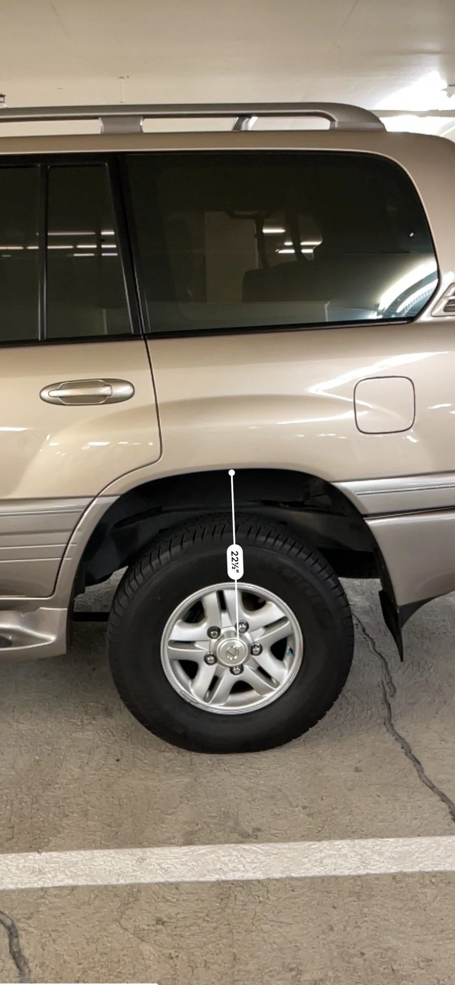

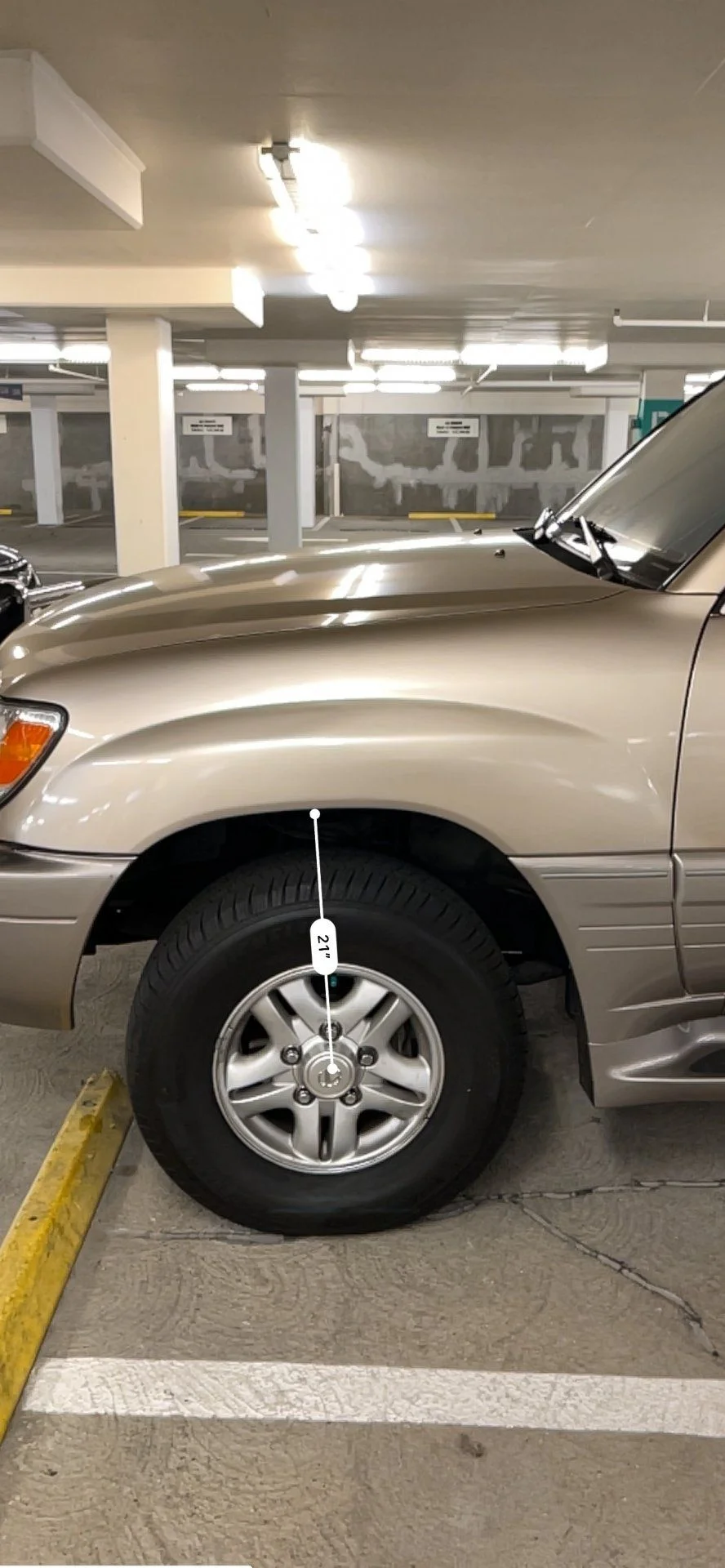

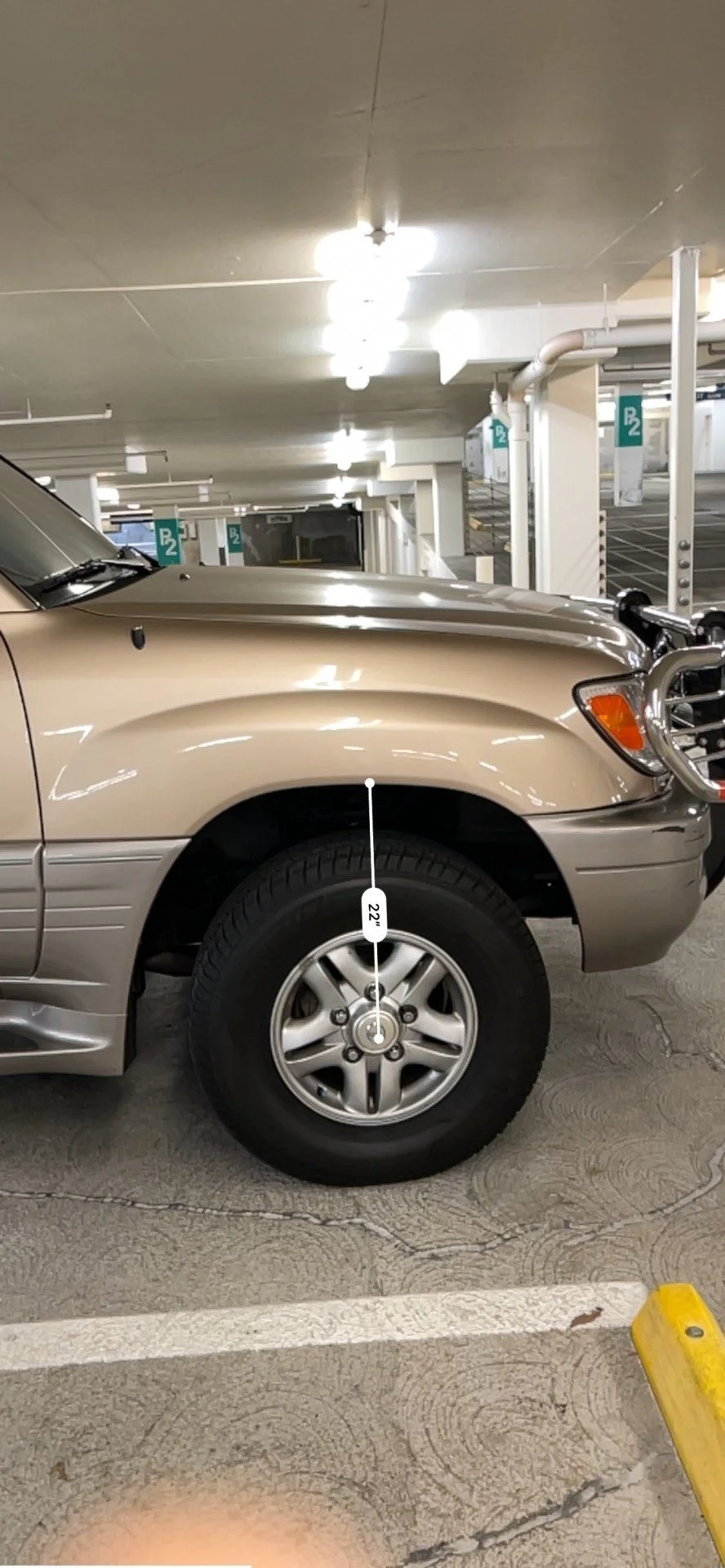

I just had mine installed and got it back last night. 2" Ironman Foam Cell Pro with the "light duty" 13b springs. Only thing I am noticing, and didnt see at the installers shop when picking up due to darkness, is that the driver's side is nearly 3/4" lower than the passenger side, both front and back. Otherwise, I have a nice 1-1.25" rake back to front. Any thoughts on why the driver's side might be lower (measuring hub to fender)?

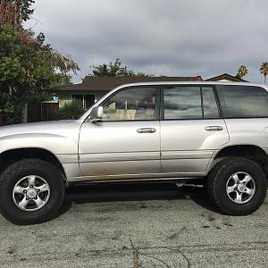

  1. For the city driving I really like the Ironman suspension, the Performance variant, which is for additional loads of 0-400lbs it feels just fine. I have a good footing on the highway and don't see any sway even at 90mph.
  2. How do I measure rake? Sorry I am not familiar, I feel the front and back are almost level.

  • I have a 1" rake between the front and rear
  • ~2' lift all around

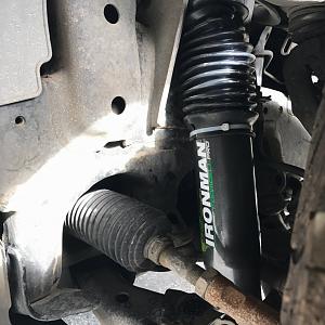

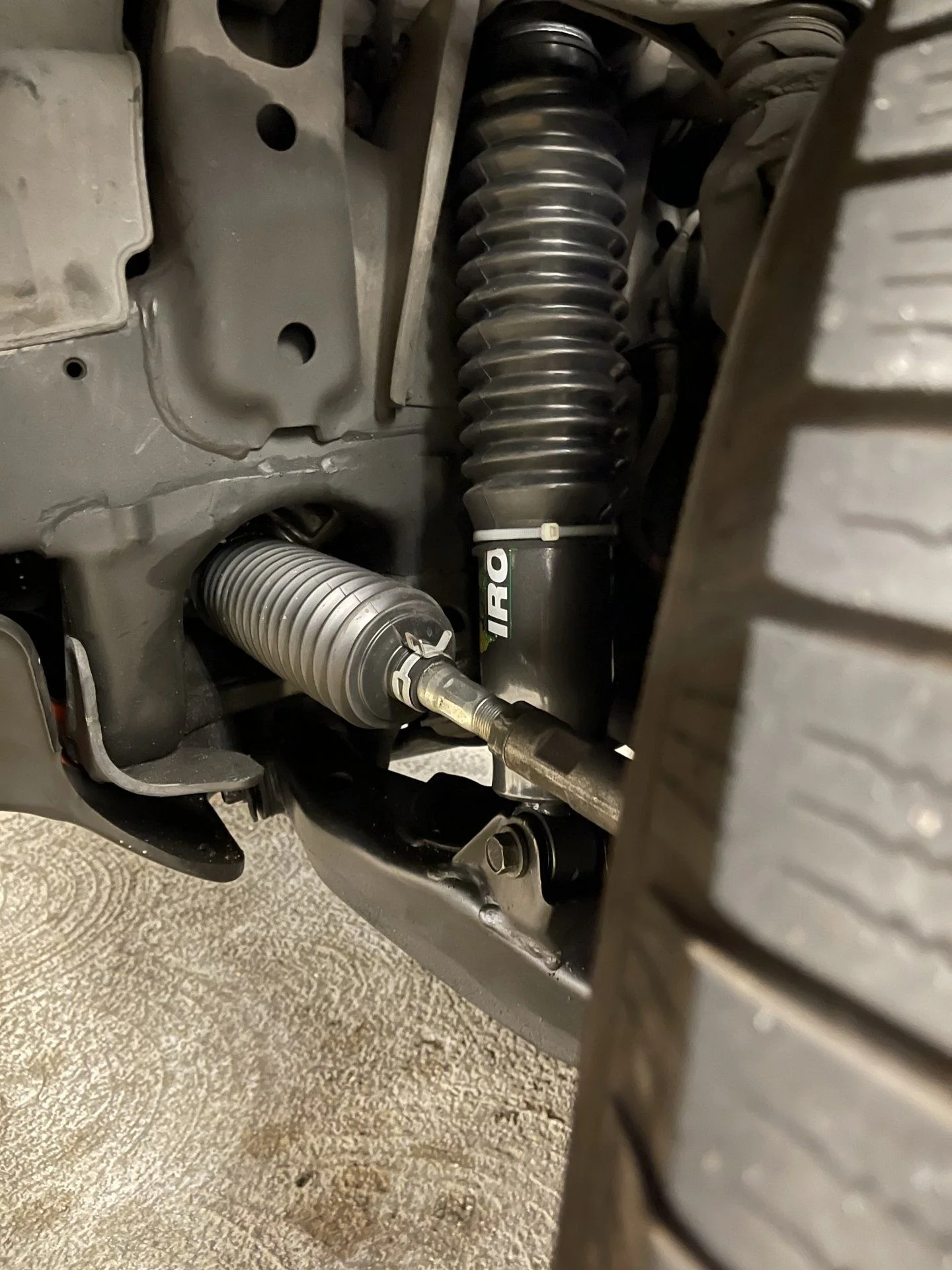

  • I ended up getting the differential drop kit
    • As you can see the Rack&Pinion is almost straight

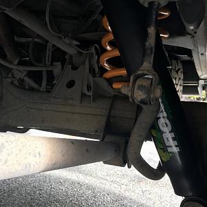

Hmm, ok, so that could possible be the issue. Do you know how I could easily tell if they are incorrectly installed when they are on the truck? I suppose I could go out and look and see if there is an L and R on them. I also assume that L is driver side and R is passenger side?
Thanks.
I just installed my Ironman rear yesterday, I didnt see any markings but i did use the slightly taller spring on the driver side due to the fuel tank. Only because in videos thats what they were doing, not much instruction in the box.

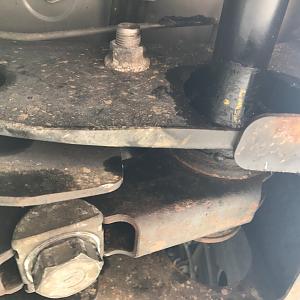

Any of you guys with this lift also doing the pan hard drop bracket to get the bar leveled? Or is that not necessary with a 2 inch lift?
