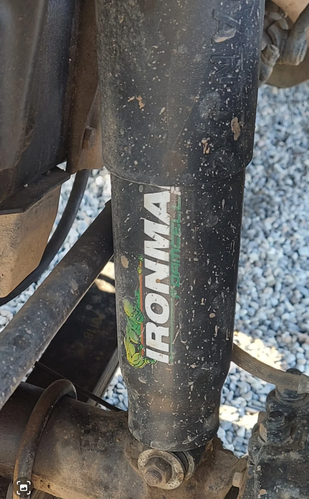

finally! someone posted about FCP for Lc40-45 Series!! I couldn't find ANY information as well on the Ironman 4x4 FCP, but for the foam cell and nitro gas , there is a lot of user here in the Philippines. i am glad that you made it.. i am waiting for my FCP pro to arrive and can't wait to install it to my 40... sir can you please post more photo? including the close shot of the FCP? thanks sir !
Judemiks, The Foam Cell pro is an upgraded shock absorber. The girth of the shock is a good inch or so bigger than a standard gas charged shock. I was surprised and impressed with them, seem to be built very well. If you read up on them, the technology was developed for military use I believe. The idea is they won't overheat and lose performance with heavy use. When the truck is loaded down with people and gear it still handles very well. It's hard to say how much better they are than the gas charged shocks but I believe most people would agree they're better.

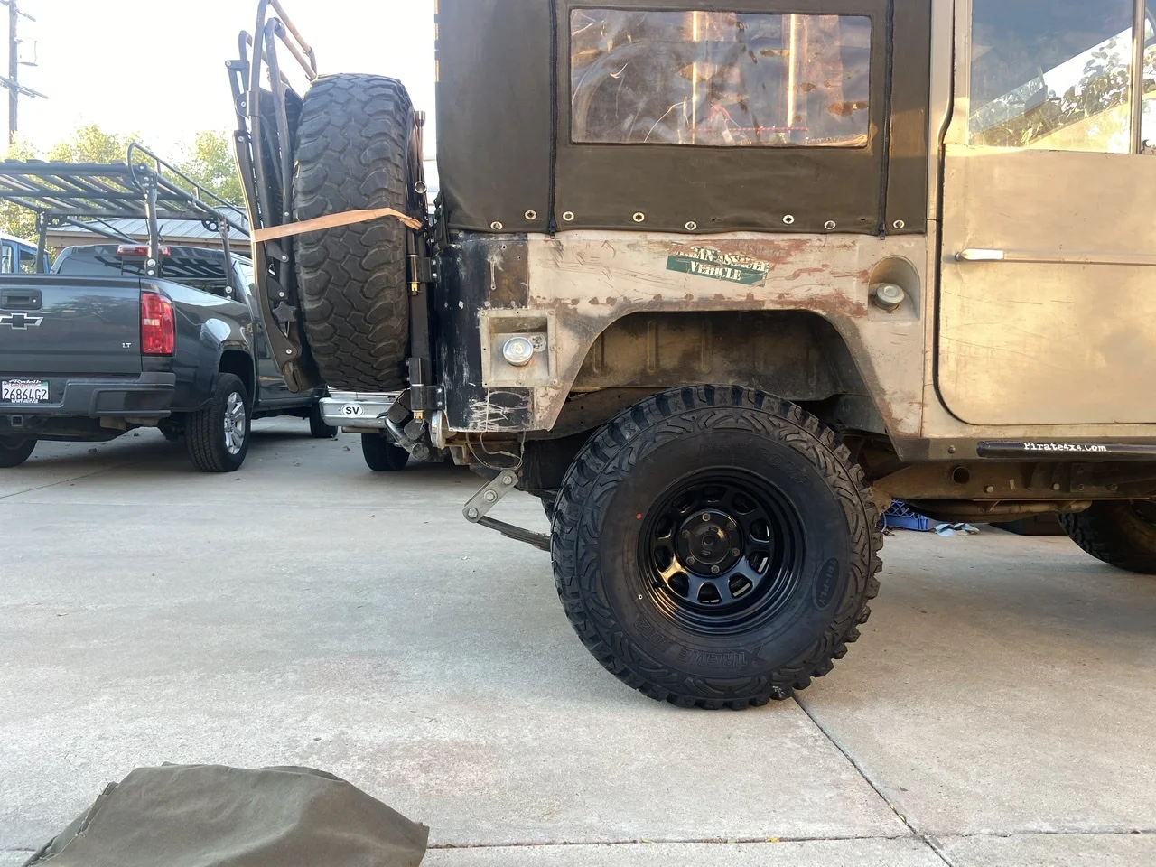

It looks like you went with a longer shackle?

Same to you sir, I did a lot of research as well and took me 3 months to learn those differences, so far ironman pro has the best to offer regarding multi-purpose function at a reasonable price, however I am a bit worried and sad for this shocks, it is so underrated and you are the first 40-45 series owner to use this FCP. Swear, everyday i am on google, YouTube or any other platforms and yet I haven't seen a single review of FCP for 40's. I am happy to see this sir, I appreciate it. by the way sir, your FCP has item number of Front=45635FE and REAR=45646FEC , and both eye-ring mount from top and bottom. am i right? if you have instagram sir please tell me so i can follow you :D THANKS!

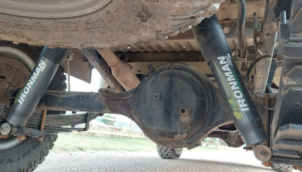

Talk to us about the full suspension setup on Ruftoys. I believe you stated iron man rear shocks on it? I was reading about your death valley trip in the Warehouse fire thread, but it is locked and couldn't ask there. I would love to be able to drive 40 mph theough the desert whoops in a 40!
Had this discussion Evan, just a couple of weeks ago in this forum. I really believe the secret sauce is the shackle angle.
Had this discussion Evan, just a couple of weeks ago in this forum. I really believe the secret sauce is the shackle angle.View attachment 2837029
Kind of interested in your choice of shocks front & rear. From my time in the desert in other hobbies, sock valving is really where the magic happens for a smooth/controlled ride. Shackle angle and proper spring rates certainly come into play on leaf spring trucks, I agree that a 45 degreeish shackle angle allows the suspension to work versus steeper shackle angle we commonly see on these trucks due to short leaf springs and extended length shackles. I think you mentioned Doetsch front shocks and ironman rear in your warehouse post? What series or model shocks front & rear? I see Ironman offers a couple different options.
