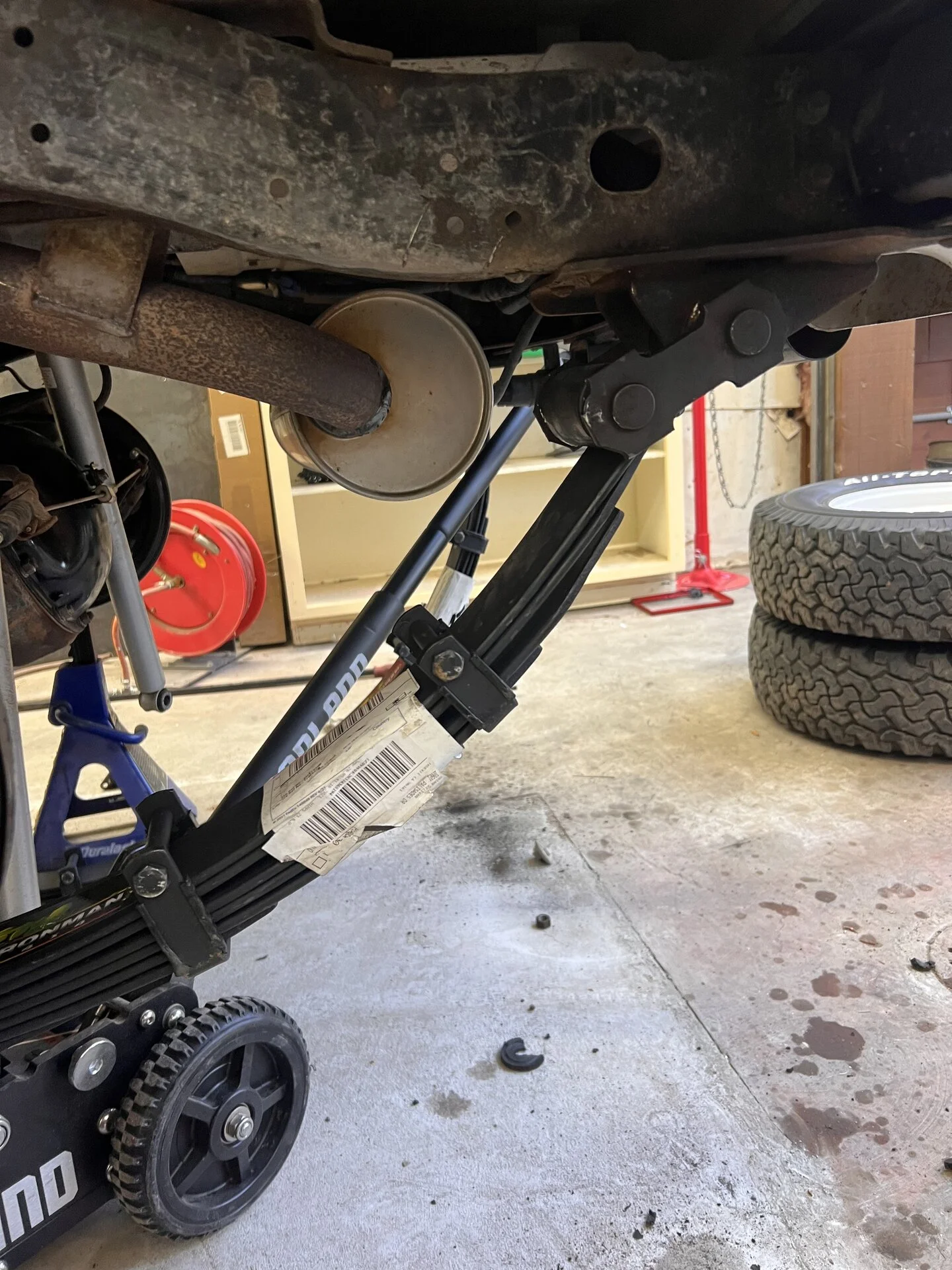

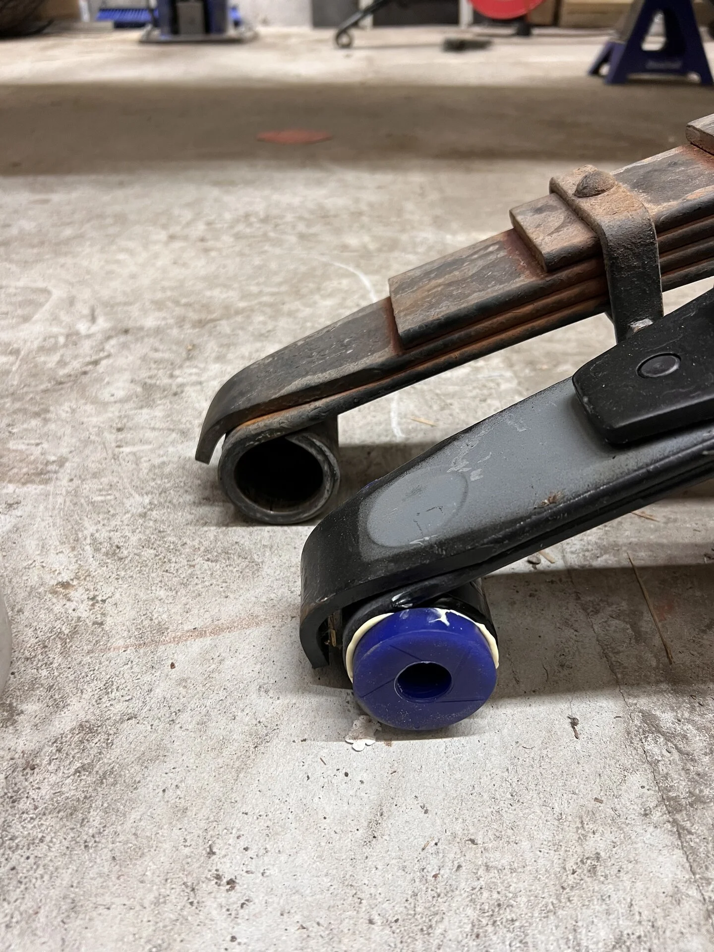

rear 1981 FJ40
I recommend getting the anti-inversion shackles. Their leaf springs are the same length as stock… but with more arch; in other words they are too short.
rear 1981 FJ40
My kit came with front and rear anti inversion shackles... Will this fix springs too short issue? Dang I need to install these on the 40 already:rolleyes:
