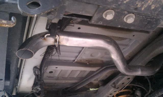

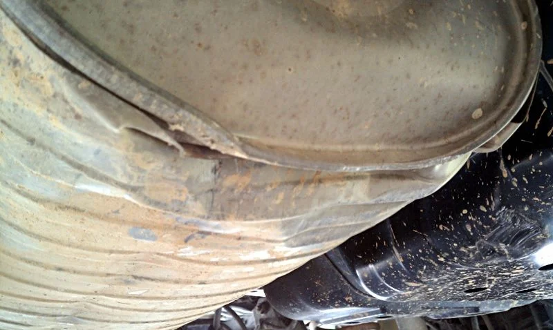

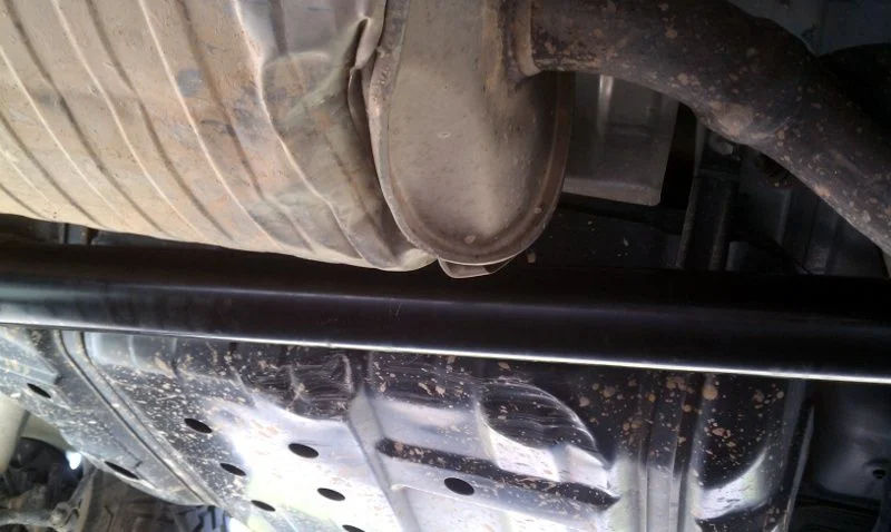

- muffler got scrunched again as did tail pipe...so when driveshaft if fixed taking to get 18" oval Center/Offset Magnaflow installed...tucked up tight under body with new 2.5 inch tail pipe coming out of it and tucked up where spare used to go and then cut off flush with bottom of rear bumper.

- new muffler setup...almost went with DT or EMS cat back setup...just remove, bolt up new kit and be done. But having to fix driveshaft at same time opted out and will be doing a Magnaflow 18" oval with Center/Offset configuration and 2.5 inch inlet and outlet pipe size. It will be tucked up higher than frame rail on that side and the tailpipe coming out will be tucked up into previous spare tire well and then cut flush with BIO bumper bottom. Will add pics when complete.

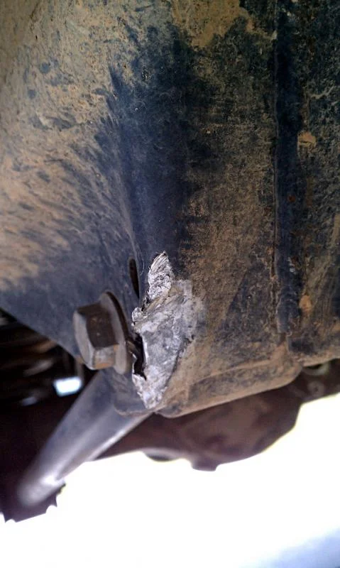

- damage to forward mount of rear lower control on passenger side....may beat flat again and file to straighten up but unless Outrider Suspension can get someone to donate a 100 series for a couple days in Texas...not likely. I had asked Jason Braswell and others but nobody can make it down to play guinea pig. So guess I will have to get with BudBuilt or someone else to see about lower control mount armor, lower shock mount armor, and rear diff armor....not to mention skid plates in front and over tranny....then will see if I want to do it under gas tank as well or not. Oh well...on to the next.
- gas tank rash on skid plate....see above. blah blah blah blah LOL

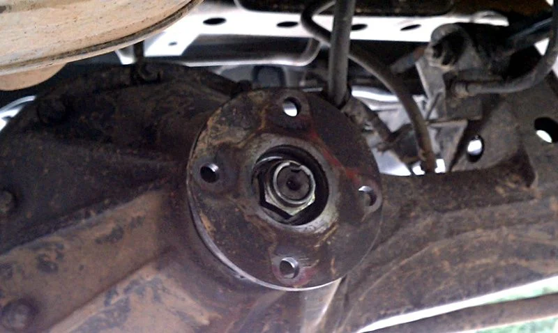

Removed drive shaft today and took for repair....not really bad just looking at it just nice lazy spiral from midpoint to rear flange...and slight almost unnoticeable depression in one spot. :)
enough to make it vibrate like a vibrator in a cheap porno.....without the happy ending. only did it bad around 55-60mph and then around 65-70 it would smooth out again but did not want to mess up universal joints.
removed and took to shop recommended by LexTech....the guy (Larry) is going to order new metric steel tube....cut it...machine it...weld it and get it back right for me. Would have only taken a couple days but he is out of metric pipe so it is now on order. Should be ready for pick up by middle of next week. Forgot to take pic of the damage...but here is empty spot where it used to be :)

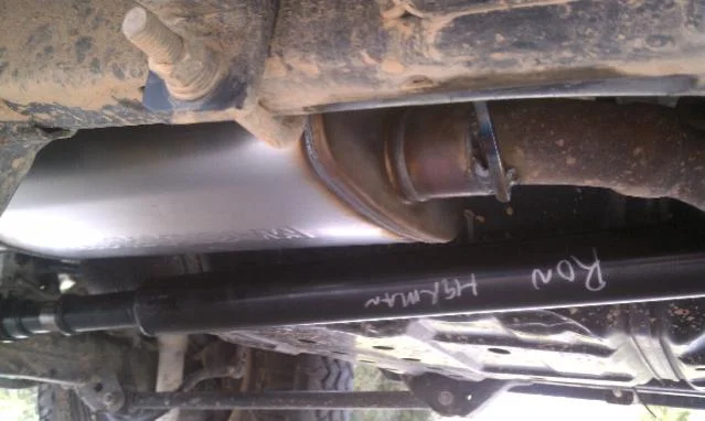

driveshaft fixed and back in place...one down, one to go. was getting muffler and pipe work done today but shop was too busy to get it done so going to try after work one day or on Wednesday morning before I take off for few days on motorcycle...
put shaft back on...tightened as tight as I could with hand tools...took for test drive and smooth as butter now. Tightened again but they did not budge so will go with it... LOL
Price out door was less than $200 for completely rebuilding DS...cutting off ends, new steel pipe, balance, etc. You have to remove it and bring it to them as they just do the shafts themselves and not anything else associated. Had it back in two days....if it was not the Lexus style and he did not have to order the metric pipe it would have been just a couple hours.

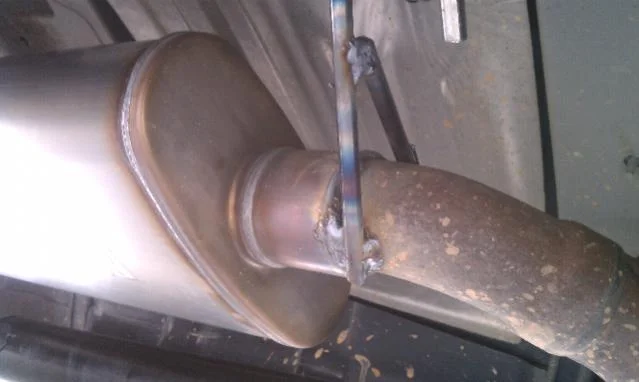

Got 18" magnaflow today and had them bend pipes up higher. Love it. If in Charleston area I have to highly recommend Carolina Custom Mufflers on Dorchester Road. They have been around a long long time and the owner does most of the muffler work and pipe bending himself. Steve runs the front office and will hook you up.
Haha can also see newly rebuilt driveshaft and name they write on them while building to make sure no mixups. Destroy yours at Uwharrie and you can have one custom made as well with your name hand written by a real pro! :)

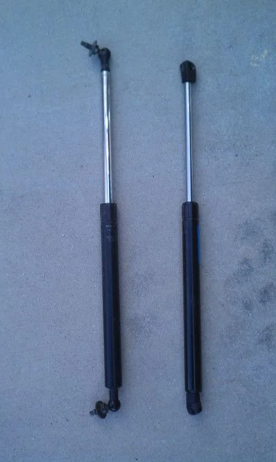

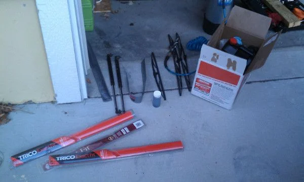

This afternoon, I replaced the hood struts with a set that were from EBay, Strongbuilt Hood Lift Supports (Shocks/Struts)4361
http://www.ebay.com/itm/Two-USA-Mad...-Props-Gas-Springs-4361-/400349213413?vxp=mtr
$33.71 for pair...work very well and USA Made....vs $89 for Toyota Installation was a snap.

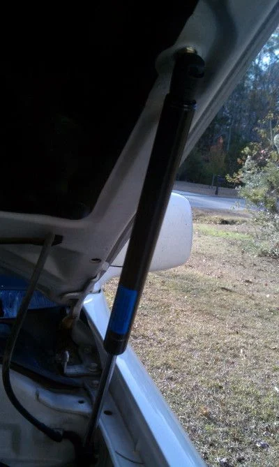

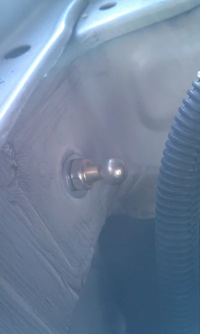

12mm wrench to remove OEM struts..recommend do one side at a time and get a length of 2x4 to prop up hood and to relieve pressure to make removal easier. For installing Strongbuilt you need 7/16 wrench....screw in brass colored balls into hood and fender....snap on chrome end to fender and black thick end to hood...DONE! Repeat other side.
First pic is side by side OEM and Strongbuilt....next is the new ball joint that fits on fender and hood...third is everything installed.
Also, today was maintenance day for the LX....oil and filter change, top off brake fluid, top off coolant, top off washer fluid, did annual wiper blade replacement.
Oil and filter are AMSOIL as always...5w-30 Signature Syn Oil SAE SN and the Ea15K51. Wiper blades for the LX470 through Amsoil (TRICO) are T241, T221, T161 for the Trico ExactFit. They also have NeoForm for areodynamics and the Winter for of course cold temps.
What was left... :) Empty gallon containers for oil, used filter, packages and old worn wipers, old hood struts... :wrench:
