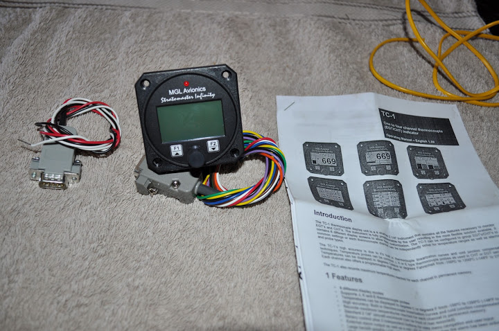

It has been a long time since I have had some spare time to spend working on Olive. In prepping for the upcoming Turbo conversion I got an EGT guage. The one in my 105 is almost 5 years old so I decided to go with another MGL Avionics unit, for obvious reasons. Due to the fact that space is a premium in the 40 I went with the smaller TC1 unit. The kit included the K-type probe with wire.
In order to obtain accurate before and after figures, I decided to install the guage before even fitting the turbo.
Having drilled and tapped the stock manifold I routed the probe wire in such a way that I didn't need the extention piece that came in the kit. I also added some extra protection in the form of Plymouth tape etc ...
I made a new bracket for and relocated the VHF mic in order to fit the guage in the most visible& practical location while still being aestetically pleasing ...
The view from my normal driving position

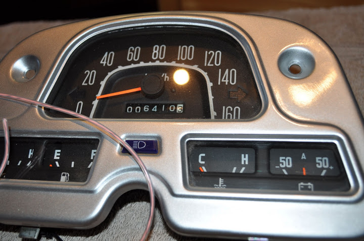

I also decided that it was time to fit that EL wire instrument cluster upgrade
That EL wire is an awesome improvement indeed !
