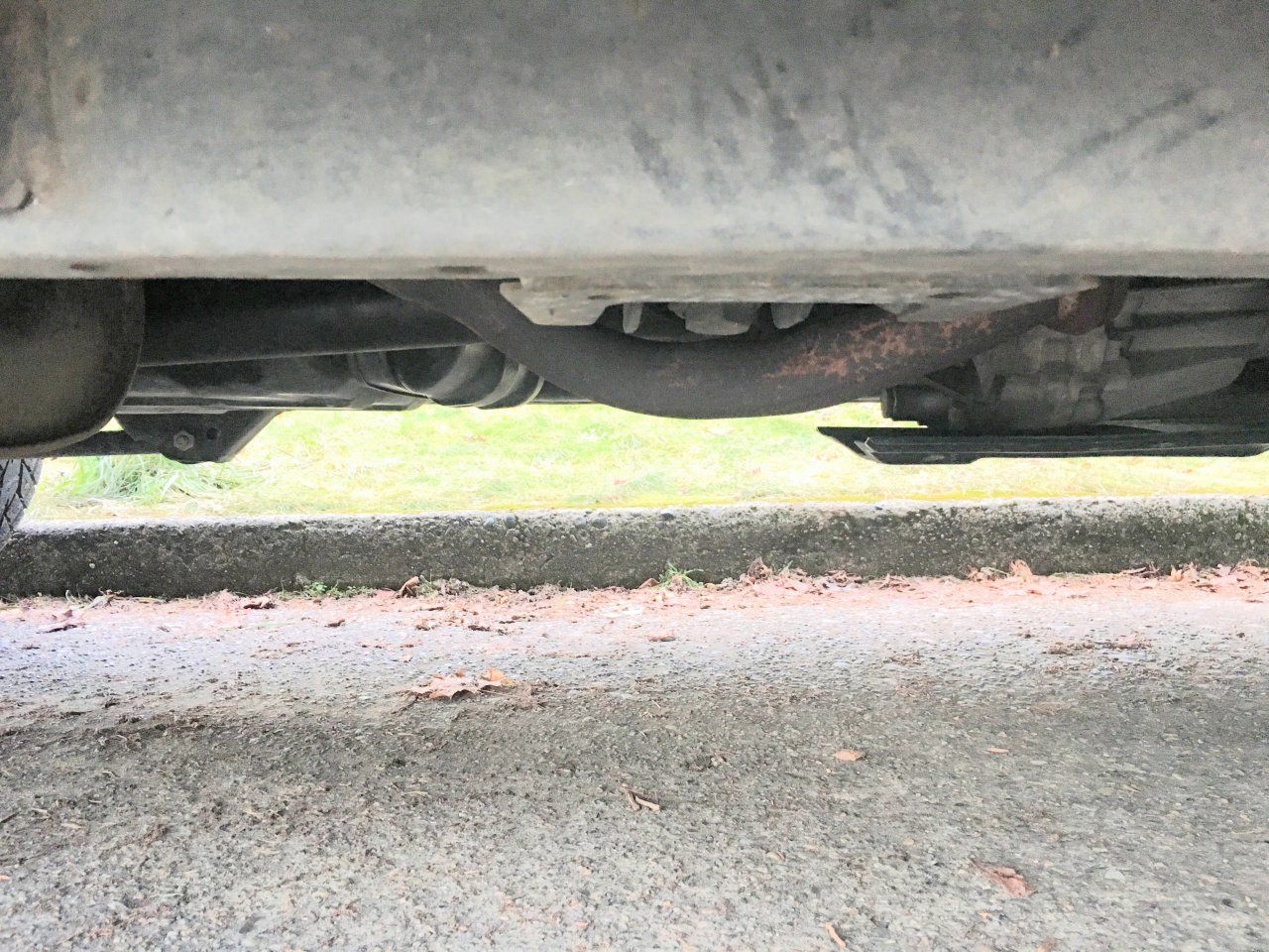

I was under my truck today scoping out the cv boot condition (good) and torsion bar adjuster making sure that the adjustment bolt wasn't hanging down too low. While there I noticed that a section of exhaust pipe sticks down pretty low. Is this normal, or is mine deformed? It seems unnecessary low to me. It seems to be one of the lowest hanging parts, below the frame rails, but slightly above the shield protecting the (transfer case? Center diff?). Not sure what that nearby shielded drivetrain component is. Haven't spent much time under the truck yet! Soon!

View attachment 1378398 View attachment 1378399
Mine looks exactly the same, I'd say yours is normal.
Just to clarify, my LC doesn't have the 270k. That was my beloved (RIP) "best $3000 I ever spent" '94 Suburban. She is sadly no longer with us.
pass your truck all the time when I go to work. I've admired it many times, and it always makes me happy when it shows up dirty. Can't believe it has 270K miles, it looks great! Would love to take you up on the ride offer, will PM.
Thanks for the confirmation. Seems a little bit odd to have something so soft and delicate hanging down. The rest of the under carriage seems fairly well protected.
Agreed. If it really bothers you it may be possible to re-route... But I'm not sure what options for an alternate location there are, I haven't looked or done any reading on the subject. I'm thinking about re-routing part of my exhaust system as now my muffler is the lowest part of my back end after adding a rear bumper. Only a matter of time before I rip it off... :doh:
The weird thing is the section of exhaust pipe that hangs down appears to have some room above it and if only shaped differently wouldn't hang down. I'm sure the engineers had their reasons, but I can't figure it out.
What do the cool kids do about the muffler problem? Lots of people run rear bumpers, it must be a common issue.
Just found this Rear Muffler Removal
Guess it's not even a muffler just a resonator and can be removed without much issue. Hmm
