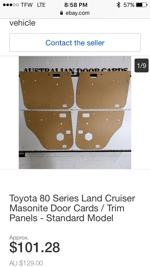

Sorry about that. Here's a screen shot I guess . . .door cards on eBay.

I feel like some nicely finished 1/4" or 3/8" baltic birch plywood would look really nice and be better than masonite. For that matter, depending on availability of a CNC for cutting, you could make some by vacuum-forming plastic sheet too.
Once they are built you never see the material, and they were covered in POR15 so rust shouldn't be an issue. The weight I bet maybe adds 5-7% to the total weight of the panel once you add handles, door pockets, etc. Aluminum or composite would probably double or triple the cost I would guess.
