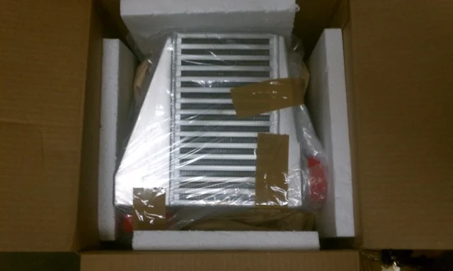

Atoyot1031 - I have a few questions for you below;
Do you have any pics of the IC from the manufacturer that you want to share?
Are there any mounting tabs/threads to add supports to hold it in place or will the two silicon hoses hold it securely?
Are there any threads (i.e. 1/8" NPT) for Intercooler inlet/outlet temp probes on your IC?
There were no pics from the manufacturer because this is a one-off prototype.
I'm figuring on no mounting tabs due to the tight nature of the fit (~<1/2" between solid mounting points on the inlet and outlet).
No fitment for temp sensors. I'm not worried about the hard data, there are too many variables to draw significant conclusions IMHO. I can do the hand test, or surface mount, but the price was already high enough for me...
Now I must admit that I was somewhat aroused by my delivery from UPS today...

Hopefully I will be fitting it tomorrow, although my flange is not yet machined as the machinist has been having issues with his CNC machine. He thinks I'll have it by the weekend though.

WOW, that looks great!!!!!

Delta T or temperature difference between the inlet and outlet would certainly give you an idea as to how effective the cooler is, which is certainly significant, regardless of "variables".
