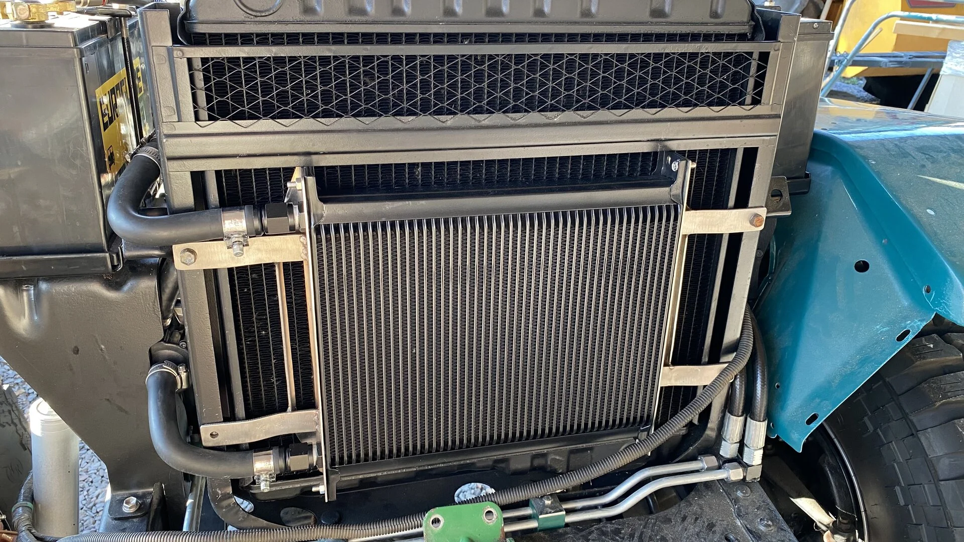

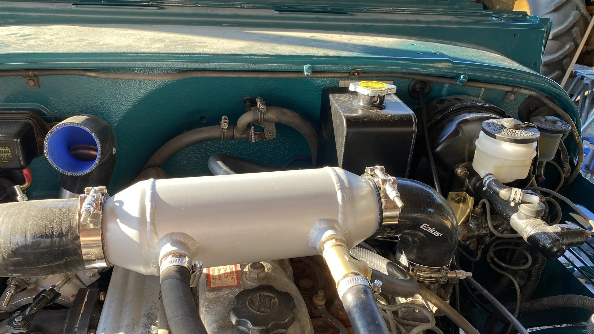

Here is my version of water-to-air intercooler for BJ42;
Barrel style cooler 8x4” and 2 litre coolant expansion tank:
The outer core is 44-row oil cooler with homemade stainless brackets:

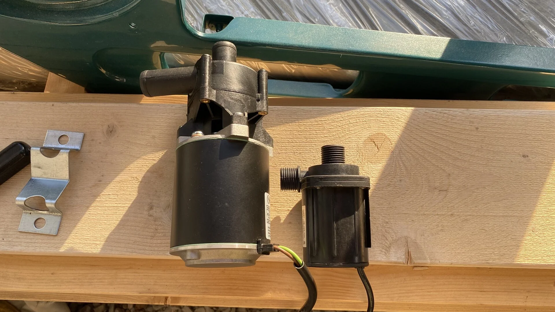

The water pump is Kormas U4810 24V (1250 l/h @ 0.2 bar), this is compared to cheap chinese 2000 l/h pump:

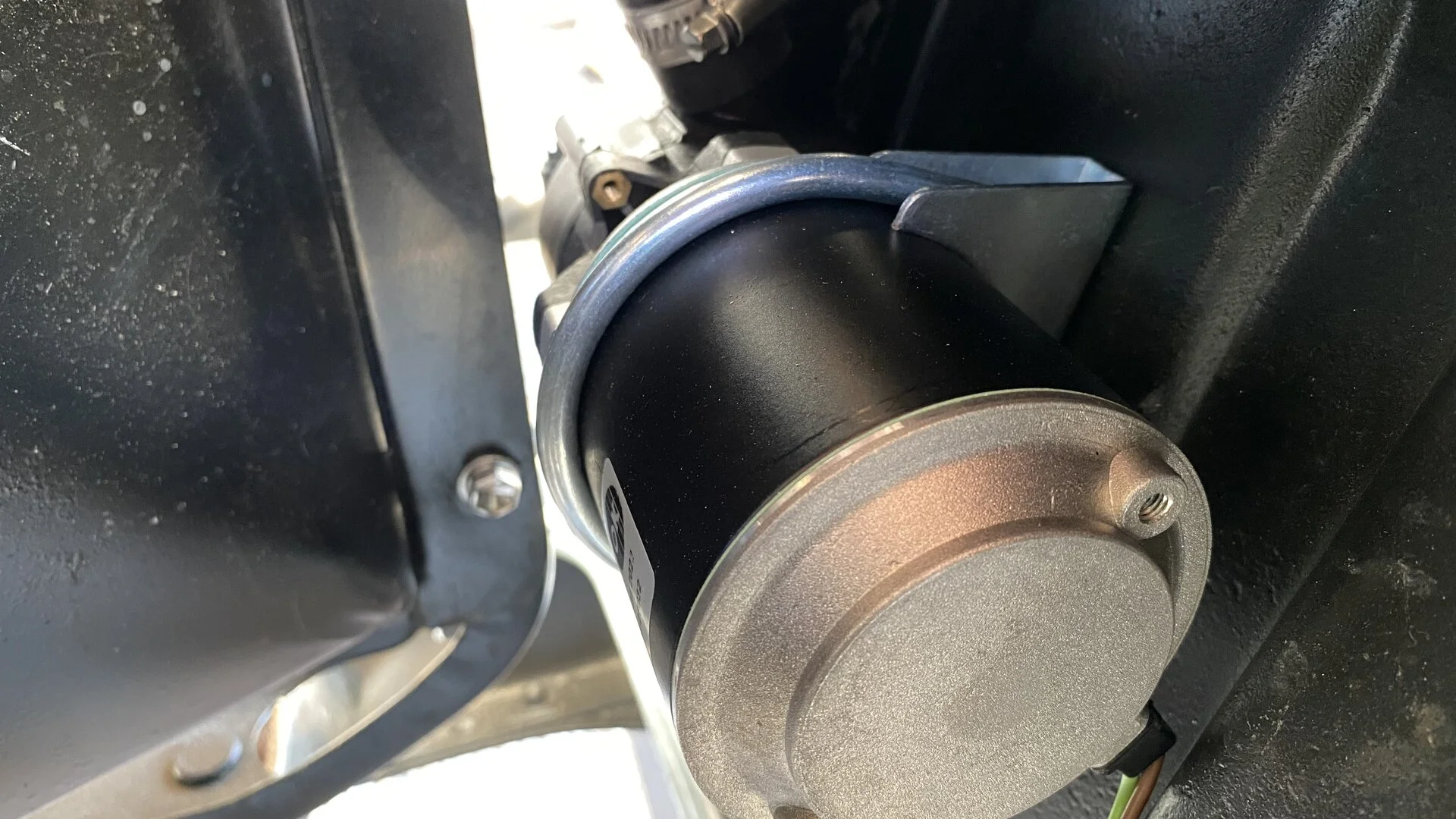

The best place for it was under the right battery holder:
Like it’s planned to be there (see that slot in the battery holder).
I mounted it with 3” exhaust band:
