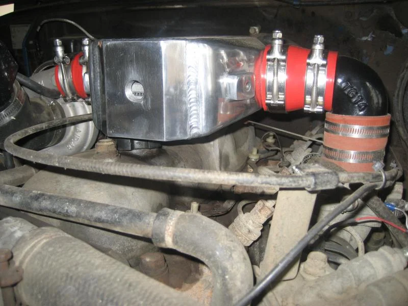

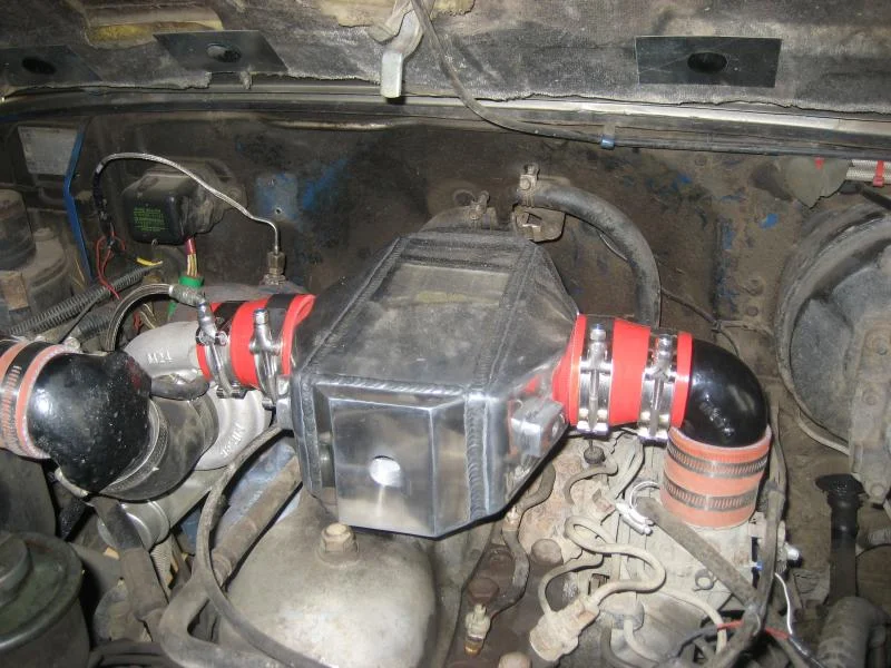

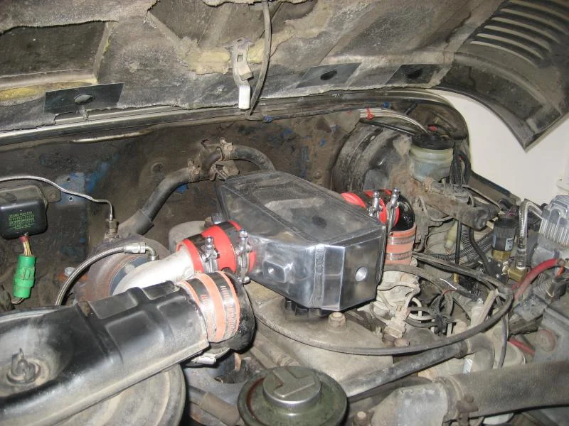

So it has begun, a quick test fit. i have about 3/8" to spare between IC and bolts that holds the cover. I knew filling oil would become a issue, i will have to make sure i have long enough water pipe so i can toss it aside. Unless someone has a idea on where i could fill it in the futur?

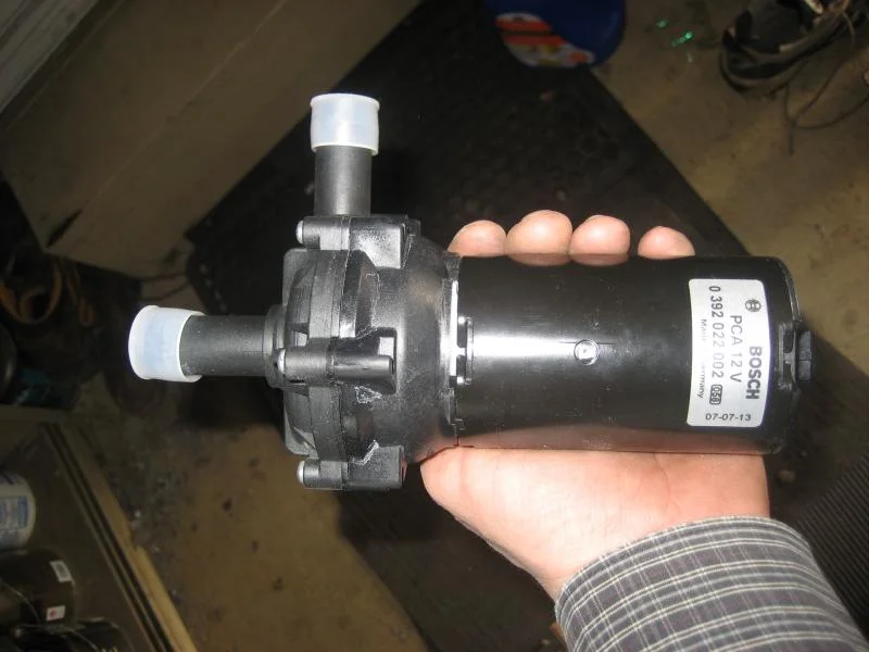

Pump will go on the firewall. and before final installation i will do a leak test on the IC, fill with water then 5 psi
Other then that i think it looks nice right there!

get yourself another 3B tappet cover and relocate the oil fill to the front...
looks like a close fit, NICE!!
Looking good.
One suggestion from I think Matt's setup was to drill and tap a bleeder point into the intercooler water jacket near the highest point.

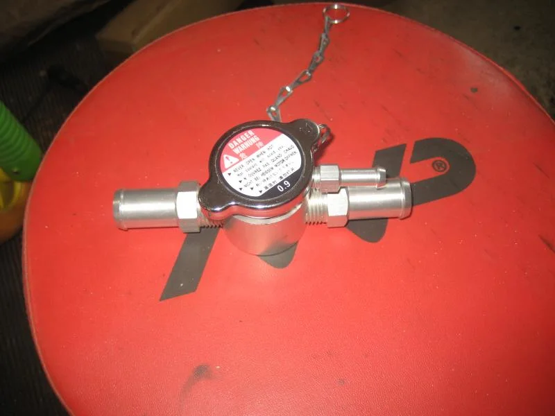

Where did you get the inline pressure/fill cap from?
Looking good.
Same place, frozenboost
Middle of the page
Liquid Air Adapter
to further Dougals post, tilt the intercooler slightly so all traped air will go to the bleeder...
not alot of space left, but it will be minimal.
