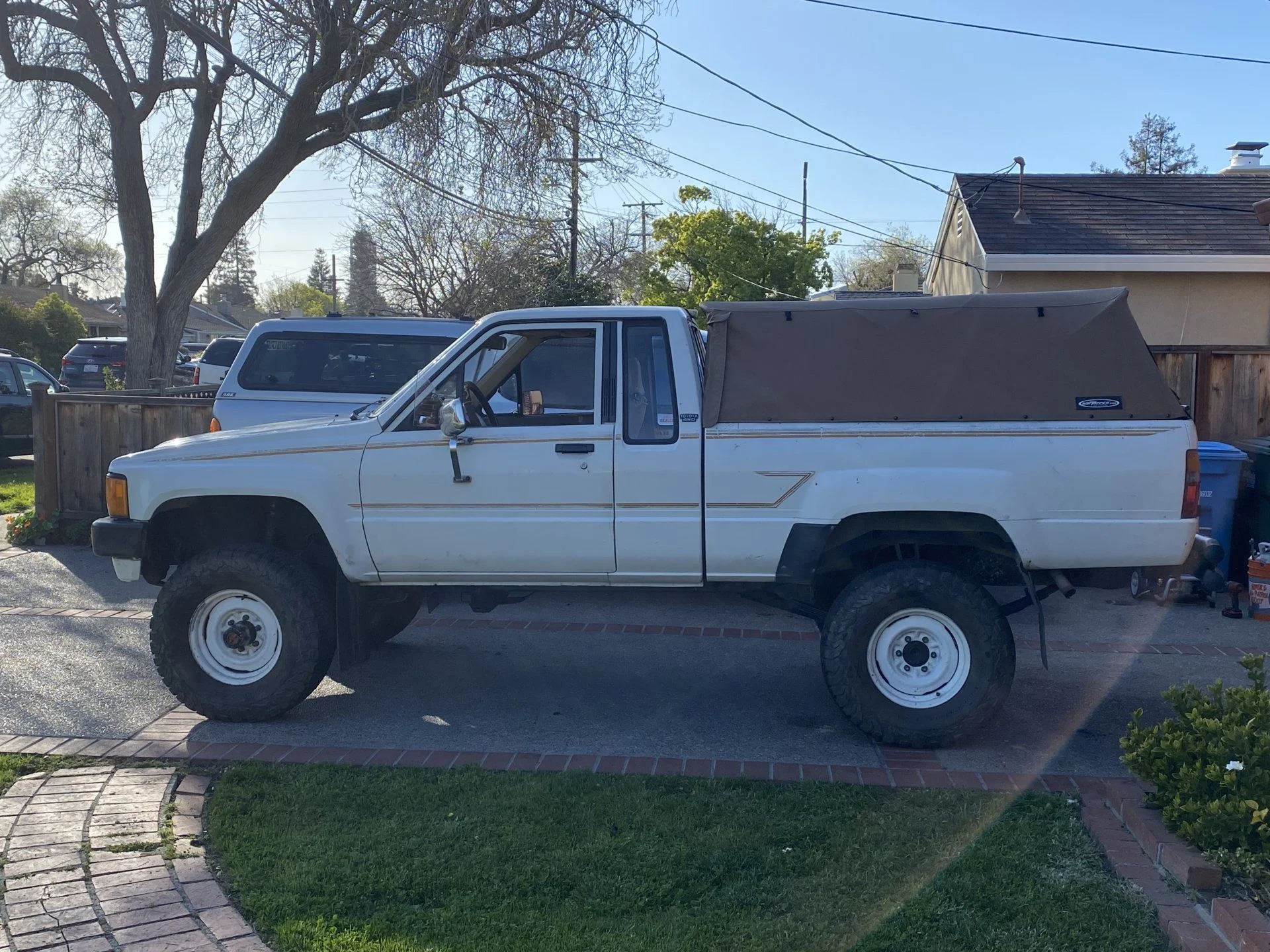

Thanks to everyone for all the tips and comments! She is all done! Front and back springs! Don’t mind she’s dirty haven’t washed her in months
Nice truck! Glad we could help!
OK, now that is taken care of, tell us about the truck, and include lots of pictures. And welcome to MUD.
