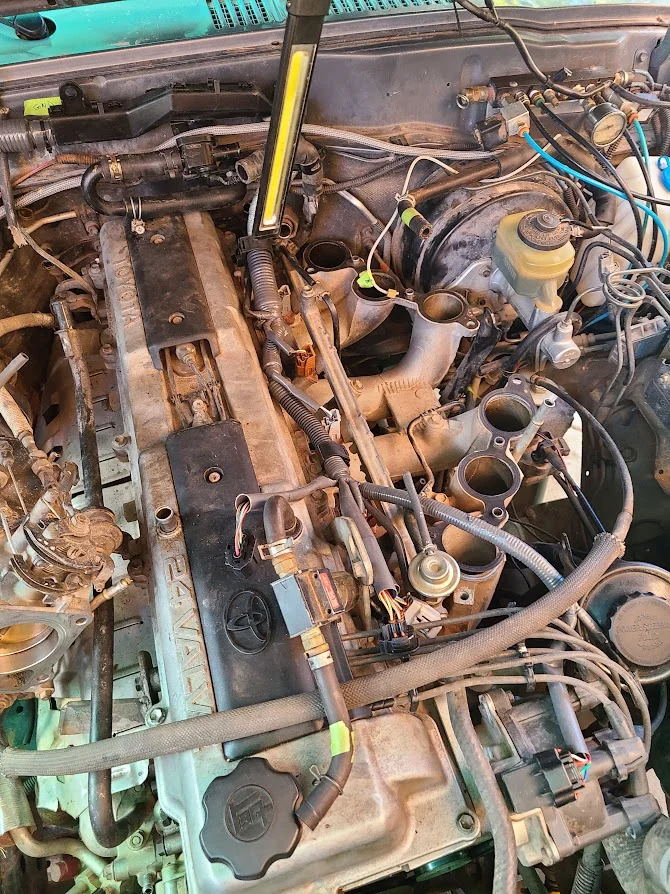

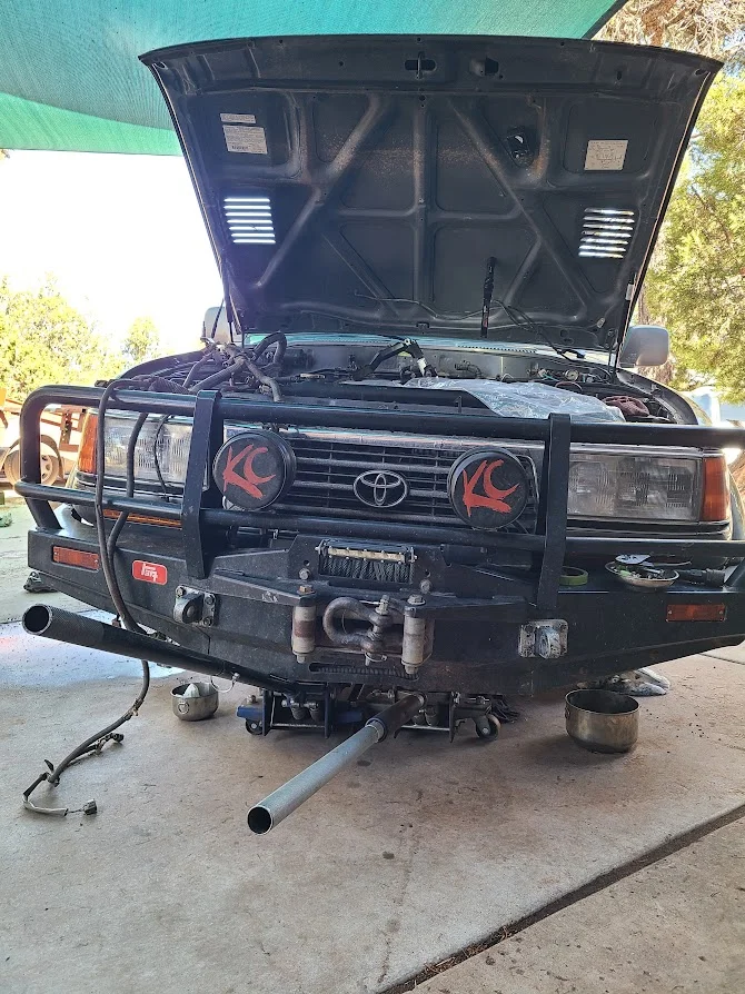

Some tips that you might find useful. Do this project when you are taking the upper intake manifold clamshell off for other projects like vacuum hose replacement, , etc. Plan on taking an entire day for this project and having a second pair of hands is really useful. In my case, I needed my daughter's narrower elbows and fingers to get to some of the things. Additionally, she can hunch over an engine bay for a lot longer than I can! Whenever I do any projects under the hood, I remove both front wheels then drop the whole thing down as low as possible, practically resting on the front radius arms on top of 2x4s to make it easier on my back.
I did shoot myself in the foot by not taking great care at disconnecting the transmission / transfer case harness from the main ECU harness. This is where I want you to pay close attention to what I'm writing. Absolutely disconnect the transfer case / transmission harness completely and pull it to the driver side of the transmission tunnel then let it hang. Afterwards, climb into your driver side wheel well, then take your time at disconnecting the two harnesses. Seriously, take your sweet ARSE time here.

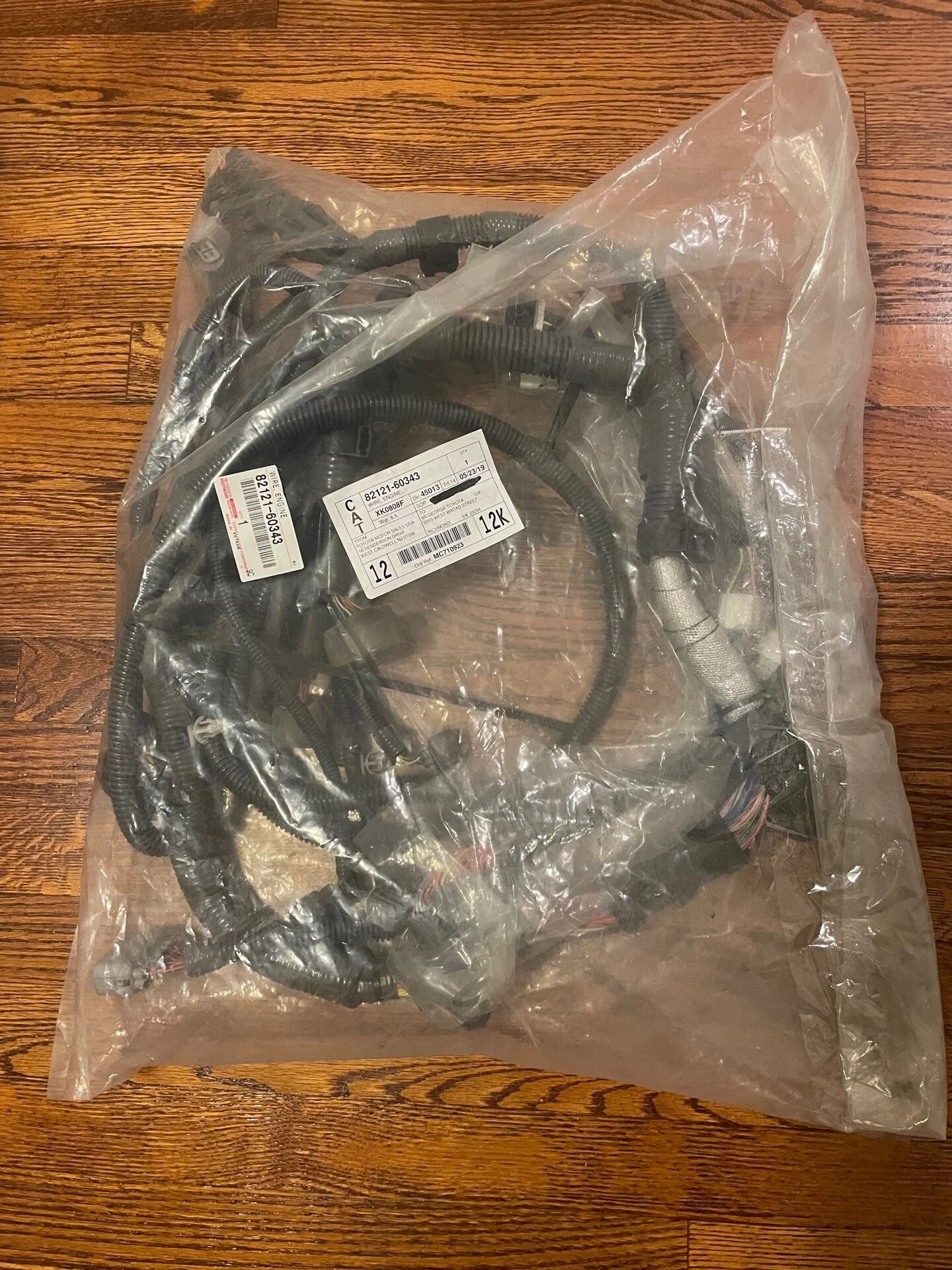

Yep, I bought one of the last if not the last 93-94 engine harness available back in 2015 and did notice a difference not to mention had no further concerns about crusty connectors and future issues.

The harnesses for 93-94 are extremely hard to find new since they were discontinued. It took me over a year to find one while the cruiser was torn apart in the garage. I ended up getting one from the classifieds on here.
If you have a 95-97 and plan to keep the truck for any amount of time I highly suggest buying a spare harness while they are available to keep on the shelf.
