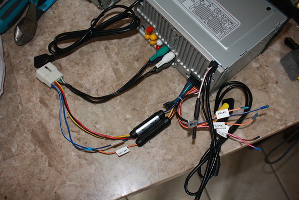

This is a double DIN, quad core android device with an internal Amp and radio tuner, along with a good number of inputs and outputs.
I started by making up a wire harness adapter. Using a Metra 70-8112 adapter and the harness that came with the JOYING unit, I soldered up an adapter cable. This adapter includes breakouts for the RCA so that you can use the existing amp in the Landcruiser.
