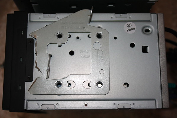

The mounting holes do indeed line up. Looks like the bracket can just be moved over.
But not so much. The bracket doesn't sit flat, because of some extra plastic on the side of the JOYING.

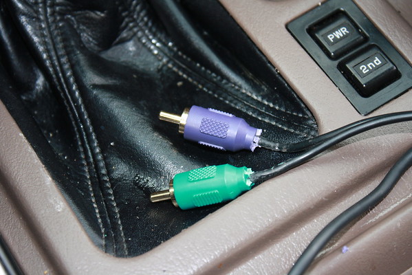

With that, just plug in the freshly made harness right into the LandCruiser, plug in the antenna, run the GPS antenna out to wherever you like it ( I put it on the dash for now), extend the two 4' USB cables (you can plug in thumb drives or other devices to those ports) so they stick out somewhere, ( I made them come out by the center console).

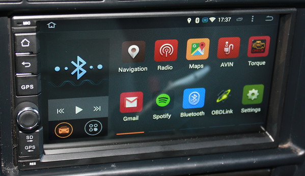

I threw a hotspot in the car, so I've got 4G Wifi. I used a carrier that includes free music streaming with a cheap $20 plan. I created a new google account for the landcruiser. It's got it's own email address now.
Open up the play store and install anything you like. :)
Navigate with google maps:

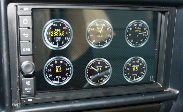

Use the TORQUE app with your OBD bluetooth device:

Nice setup. Do you know version of Android it's running? Would you mind posting pics of the FM/AM tuner app for everyone too?
It runs 4.4.4 and is available here. All things considered, this is a fairly cheap way to drag your early-to-mid-nineties truck kicking and screaming into 2015. You can also install off-road (and offline) navigation apps, and probably pipe in a few more cameras for fun if you're so inclined. This has been on our radar for a long time, so thanks, OP, for assuaging our concerns about fit.

Also - Does that app "Torque" feature more things to monitor through the OBD? Is it comparable to having the ultragauge?

badass. can you use waze on it?
Yes, you can use any app that you want on it from the Play store, or load up APK files.
It is comparable and very configurable. It can show any OBD II data, plus some calculated values. If you know of any custom PIDs that the toyota ECU is ouputting, you can display those too.
