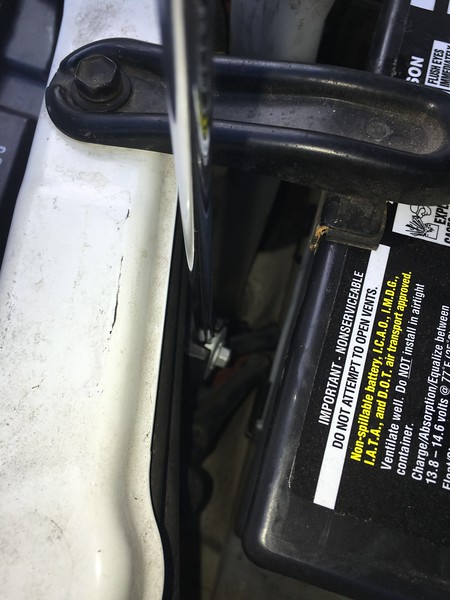

One tip to make up/down adjustment easy - use a 8mm craftsman ratcheting combination wrench. It easily fits between the battery and the back of the light where the adjuster is on the driver's side.
Agree on the decent cutoff and angled part being much better than before.

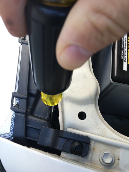

A Philips screw driver fits perfectly and is much easier to use from the top...
A stubby Philips worked passenger side without moving the air box, but my driver side has a battery right there so the screwdriver doesn't fit. Do you have a different battery position in your cruiser? The ratcheting wrench was better for me.

Cool, thanks for the pics, it never would have occurred to me to try that angle with a screwdriver. That looks a lot easier. Thanks!
