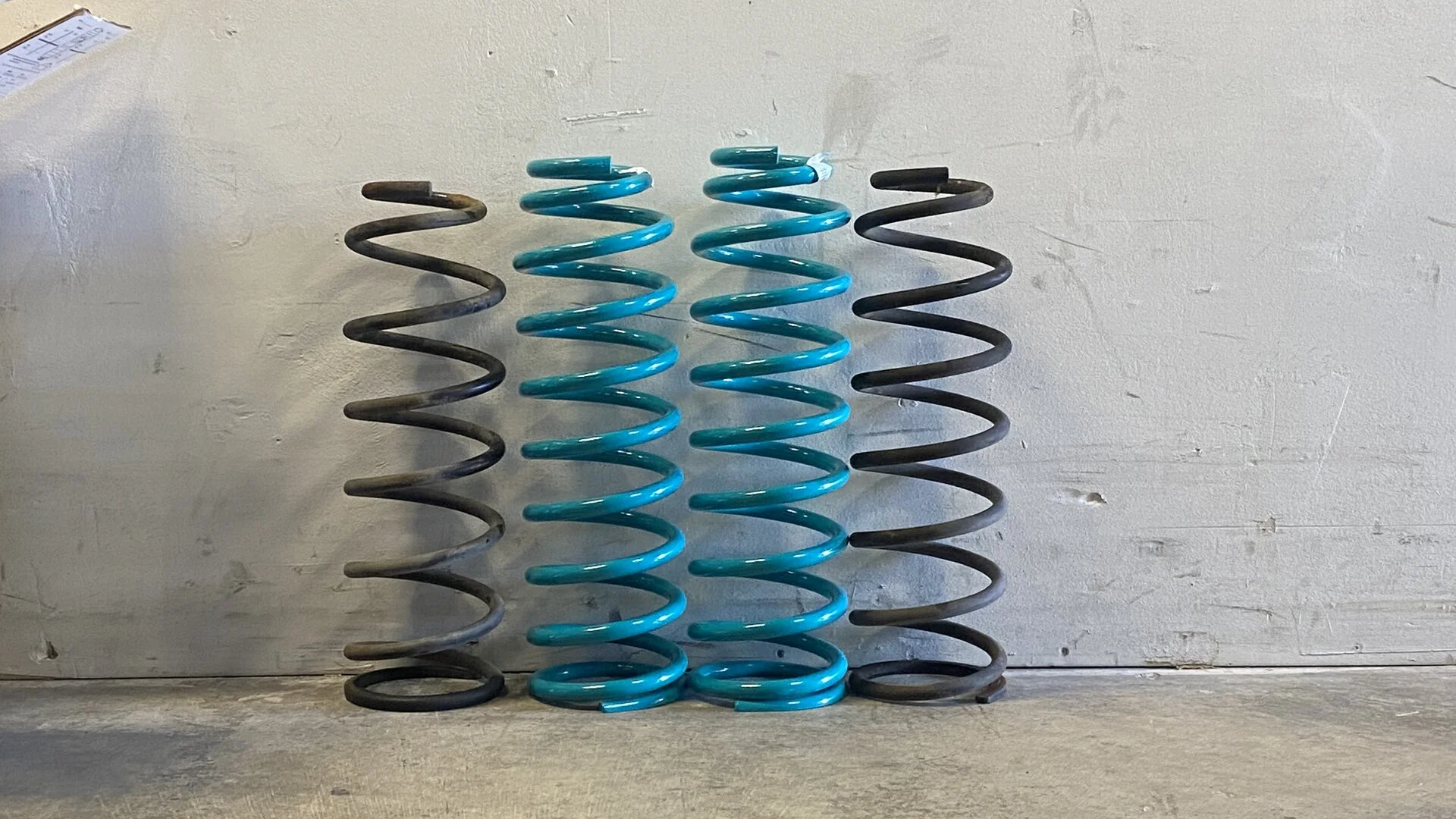

Installed Dobinson's 1.75 Inch Variable Rate Suspension Kit: C59 - 222V, C59 223V
I currently have the (222v/223v) and had the (146vt/147vt.) Which are 3" variable tapered. When you say flexicoil, I believe Dobisons "flexicoils are 4", (615v)
What specifically are you wanting to compare?
There's the vt coils which are supposedly for heavier 80's and there's the flexi coils which are for lighter 80's.
C59-612V/C59-613V are the 3" flexi coils I was looking at.
I was just wondering if anyone has had experience with both for a general comparison. As far as I can tell the main difference is just an inch difference in lift height

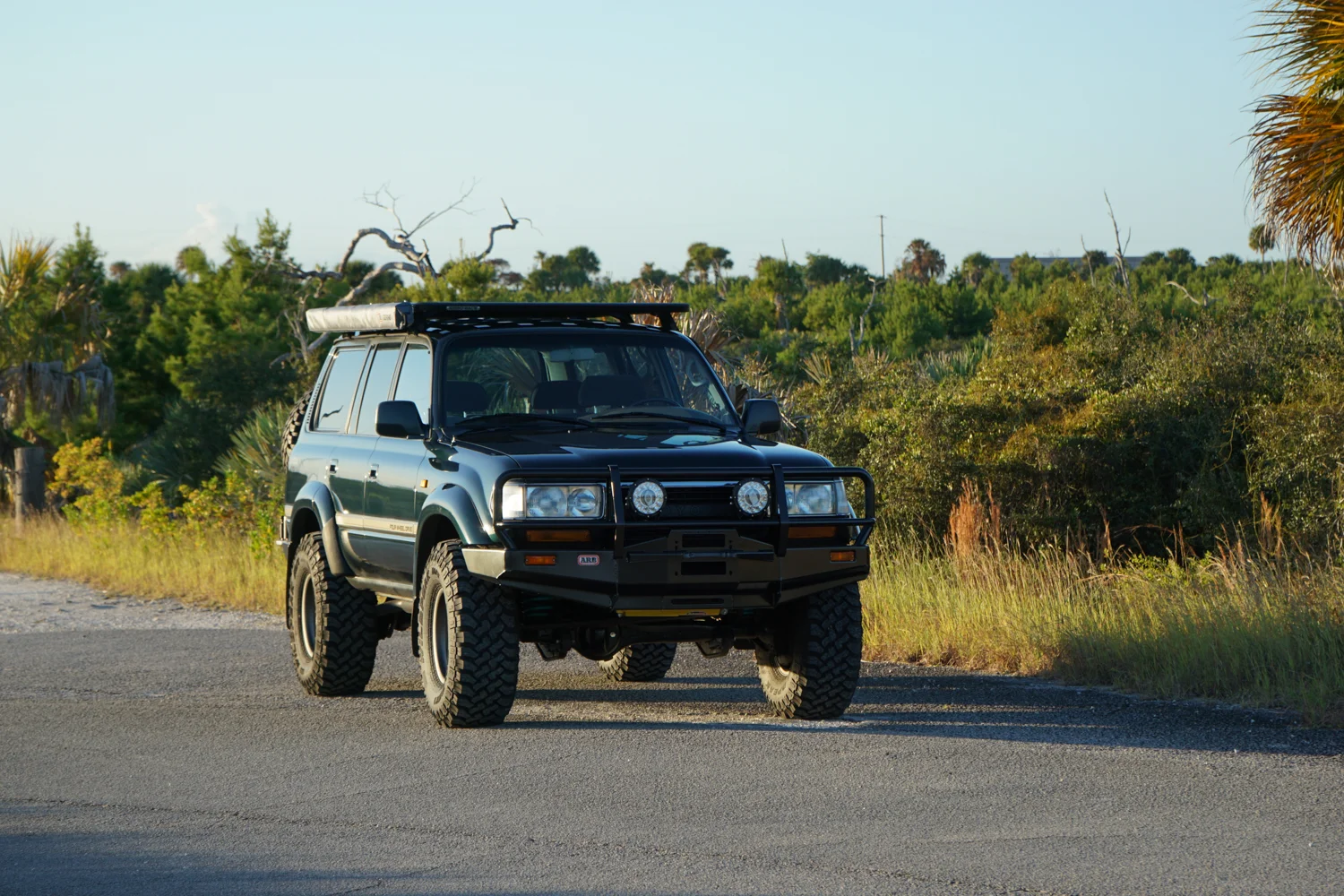

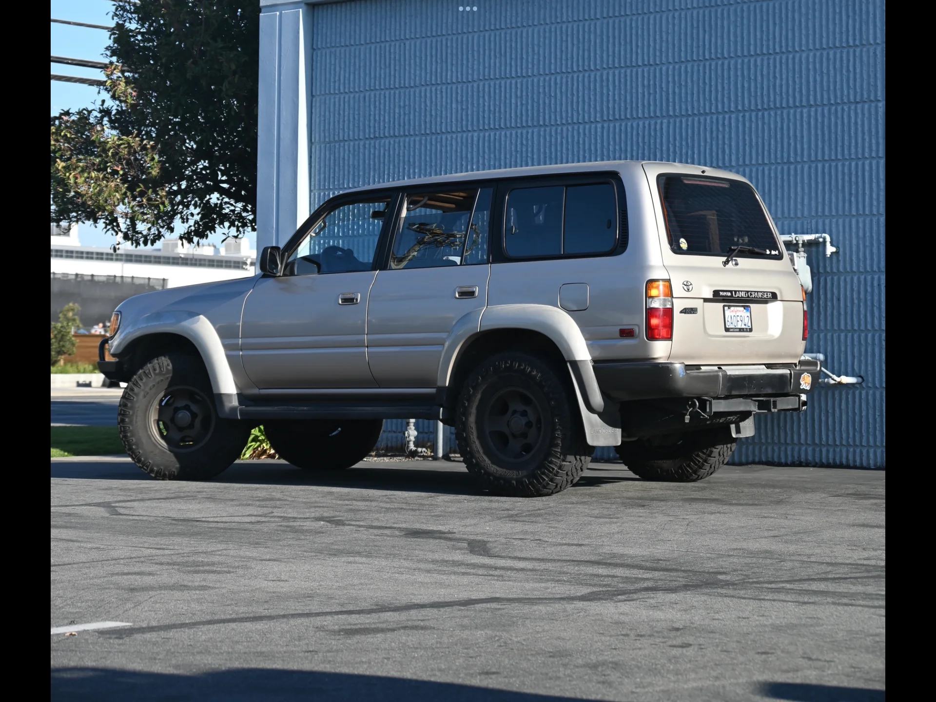

Very happy with this setup and glad i had this thread for some references. sitting at 22" center hub to fender on all four with all the gear. and still fit in the garage!
I went with 222V / 223V combo with the adjustable poly radius arm bushings set at 2.5 deg, truck drives great.
Very nice. What size tires?
Great looking setup, nice work!
This is a great stance and what I'm hoping for but I've got 33" shoes, full Front Runner rack, and plan on ARB bumper up front, and potentially the rear bumper. Trying to keep things relatively light. I wonder if the 223V rear springs will prop me up too much without the weight of the bumper. IMO, you've got a perfectly modified Cruiser aesthetically and just what I'm hoping to achieve.
