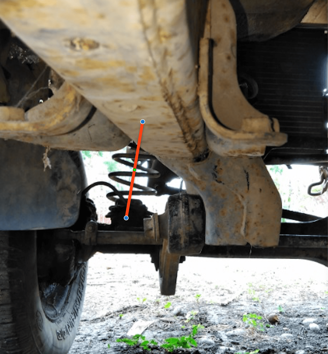

The LX450 axle is ~7 inches (18 cm) wider than the LC78 axle. The spring isn't sitting straight up and down.
