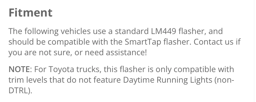

Has anyone installed this on a 2011 with DRL? Their website says it won’t work with DRL models.
I have no idea how the DRL could have any effect on the turn signals. And all 200's have DRLs. I have one in my '15 and it works great.
No idea, but it is listed on the site for the CF18 LM449
I doubt the LC is technically a truck. I believe Tundras with DRLs use the turn signal as the DRL light. The smart tap definite only controls the turn signals.
This was correct.
I emailed them and here is their response:
“Thanks for reaching out! The DRL feature you are referring to was only for specific vehicles. This should not be an issue for your vehicle so you should be able to use the SmartTap.”

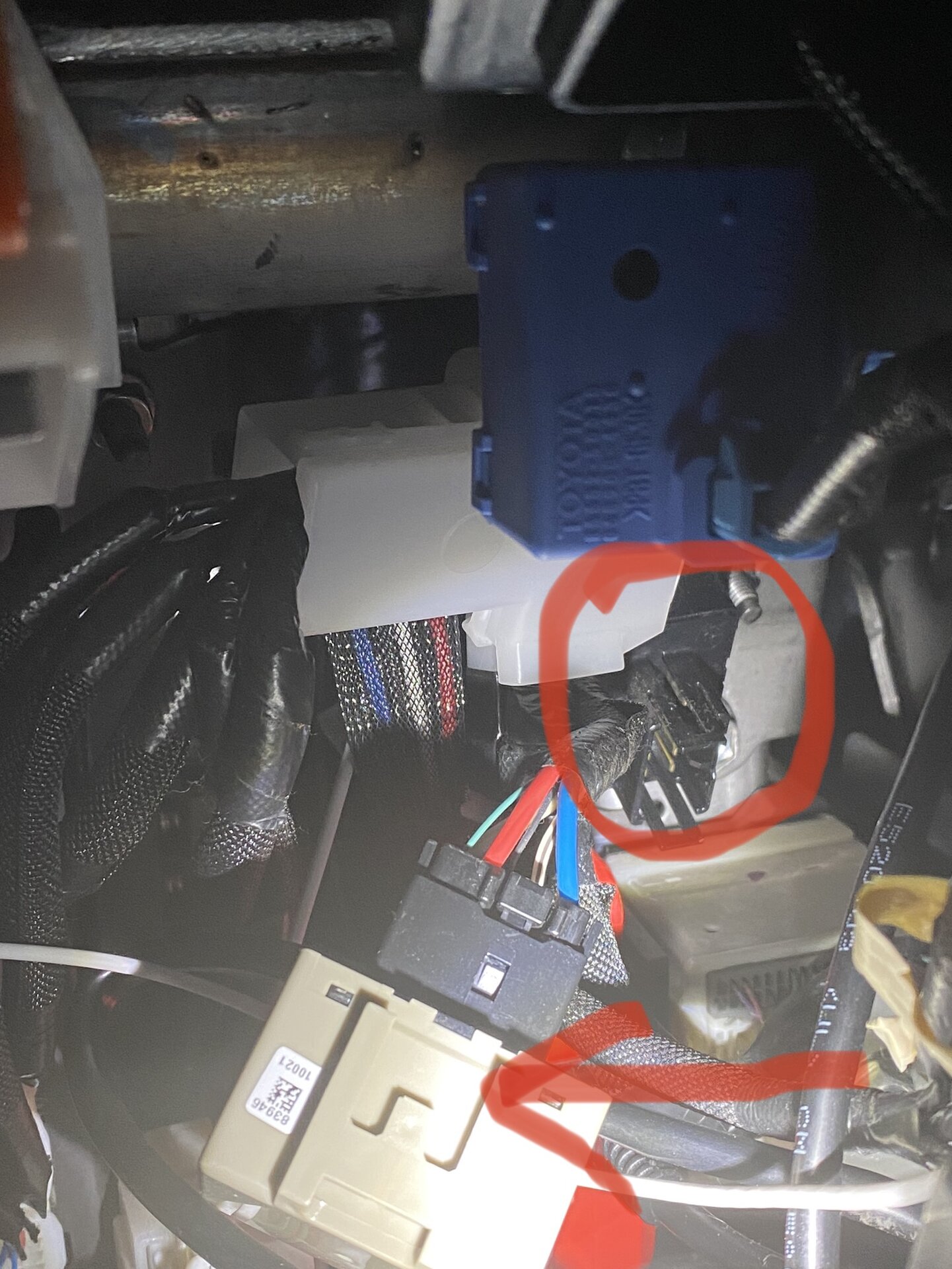

Followed the first post and this took 4 minutes. 2 of those were bc I thought I needed to take the lower black panels off then I realized I just need to take out only the actual panel with the buttons to the left of the steering wheel. Located the OEM flasher by feel with the blinker on, unplugged it and plugged the new one back in.
Thanks @yonah for the relay!! Works great.
