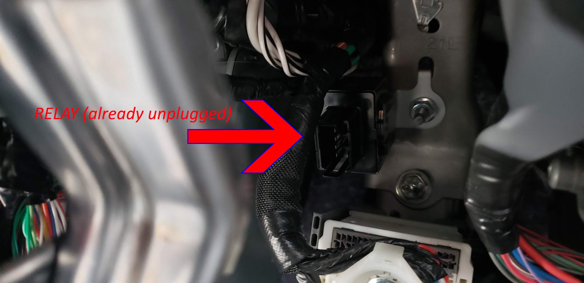

3. Now you need to find the relay. Here is a picture pointing it out. A trick is to turn the vehicle on (not the engine) and turn on the turn signal and you will hear the relay clicking. If you put your hand on it, you'll feel it vibrate with each click. That's a good way to ensure you're removing the correct plug.
This is what it looks like on my 2015:
1952318
4. Unplug the OEM relay. The old relay itself is secured to the car, so all you need to do is unplug the harness from the relay. That's just a matter of pushing in the little pin on the right and pulling the harness toward yourself until it unplugs. Here is a close-up.

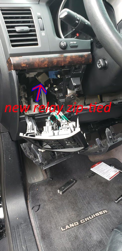

5. Now you should be able to plug in the new flasher relay to the unplugged harness. After plugging it in, I ended up using a zip-tie to secure the new relay and harness to an adjacent harness.
Here is a photo of the new relay zip-tied on. It's the tan colored relay. Note that I removed the panel of buttons/switches (as you see in this photo), but that was not necessary. For reference, I also removed all the steering wheel trim (upper/lower), and that was also unnecessary. You live and learn.

I installed that thing without taking the cover off. It was a few hours of laying on my back on the floor, legs dangling out drivers door, fingers and hands contorted under the dash. I actually tore the relay off it's mount and broke the body of the relay. I bought a new OEM relay to use the cover, swapped the covers with the Diode Dynamics, and snapped the new part in the OEM location. I considered just zip tying it, but I'm far too OCD for that. I did notice that the audible clicks got a little less hollow with the body attached the metal mount, but it might not have been worth the trouble. The flasher is nice though, as I like the nice bright LED flashers and regular flash rate. The extra modes are just icing on the cake.
despite my best efforts at ruining this, I was able to get it installed. took me, a mechanical idiot approx 30-45min. I took off the lower plate and knee plate - never done that before, without too much effort. Hardest part for me was just fitting myself in the footwell. not a lot of space! I was able to get it installed and it actually works. Thanks for posting the "how to guide", it really helped!
Basically every time I drove my truck since I read this thread, I had to have this...
Got one yesterday and had it installed in 30 mins flat at lunchtime. Bottom kick cover, and the knee panel off and was able to see the relay. Turns out the aftermarket auto start was in the way, so I popped the panel with all the switches and went thru that hole.
3/4 banana job. Would have been 1/2 except for the skin I left hanging on the metal bracket left of the steering wheel and had to get a bandaid.
