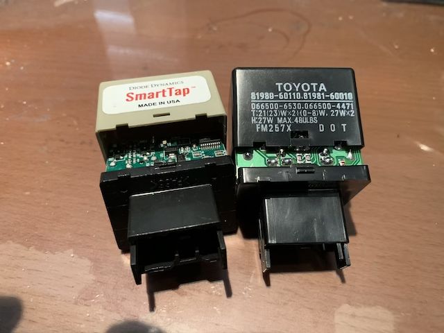

On the OEM and Diode Dynamics relay you can remove and swap the top covers. Once you put the OEM cover back on the DD relay it will mount back in the OEM spot.
I just installed mine a couple days ago by swapping the covers.
For those who need/want the additional instructions to swap the SmartTap Diode into the original Toyota relay:
Use a 10mm to remove the nut holding the relay.
Front

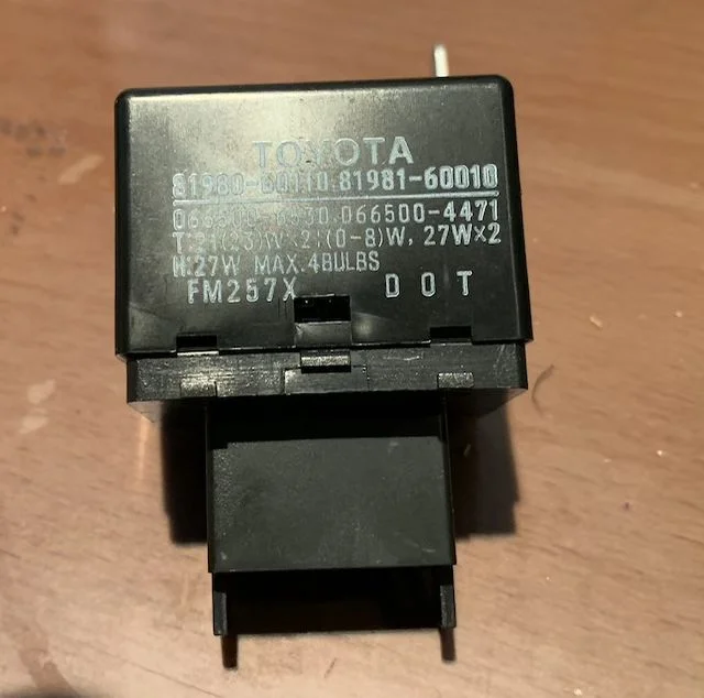

Use a small screw driver to release the front and rear tabs.
Here's a picture of the complete relay board. As you can see the SmartTap has a lot more circuitry.
There's only one way to put the housing back on.
It won't fit correctly backwards.
Closed everything up, reconnected batter and tested success. Vehicle now blinks 4x (adjustable setting) when tapping the turn signal.

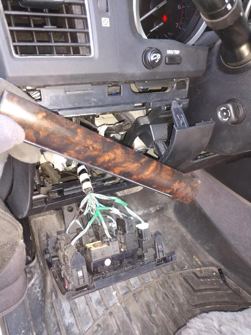

I replaced the flasher in my 2013. Very easy. The cable attached to the stock flasher was easy to reach going in from the left the bracket shown in the third picture.
The blue arrow shows the stock flasher location. Plenty of room for the new flasher in there.
picture.
