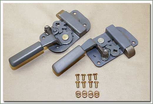

I think I'm going with a new pair from SOR. Do they come in the right color or will i need to paint them ?
Thanks for all the ideas
I ordered the ones from Cruiser Corps. Swapped the springs from the stock sliding catch into the new one. The aftermarket spring seems weak.

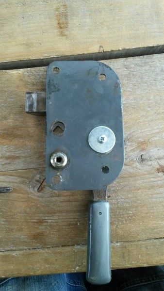

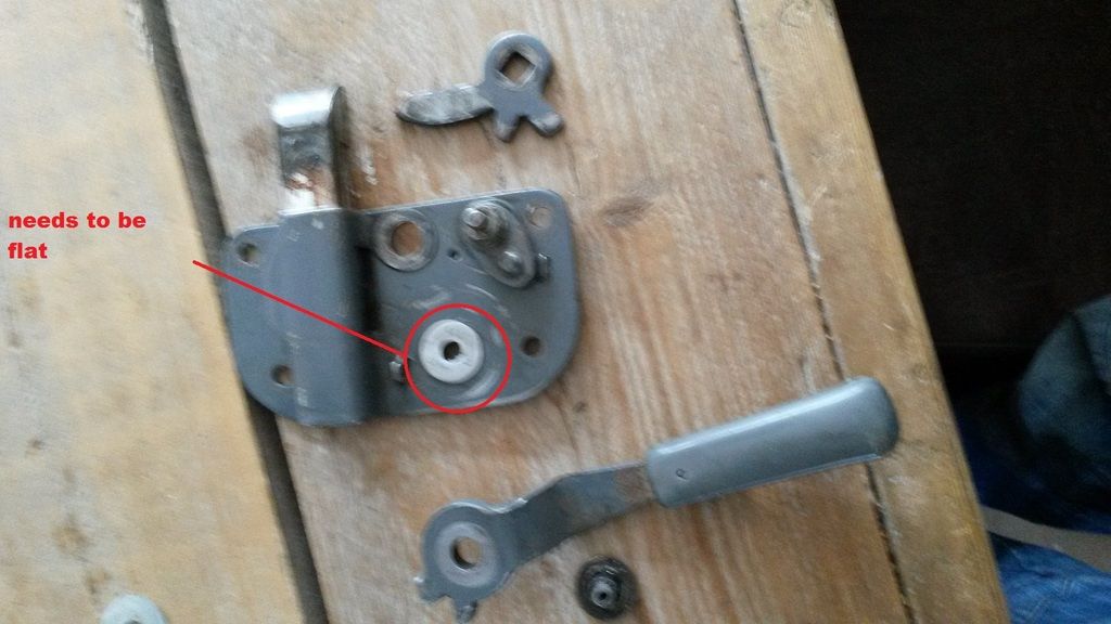

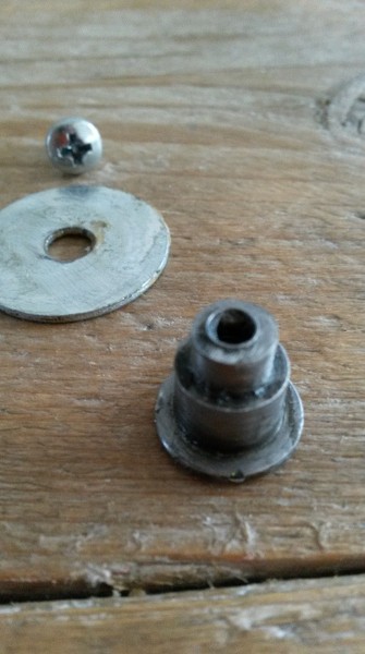

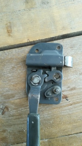

Sorry it took a while. Been busy painting the hood...again...:bang:
anyway, i took the door handle apart. Here are the pics..
front and back. You can see the small phillips head screw and large washer
What used to be the rivit. Grind the back side off. Drill and tap
this is one of the areas where a lot of my play come from. The surface was worn down at an angle
