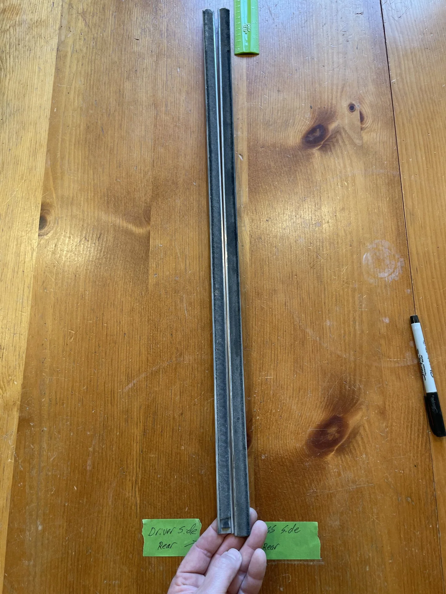

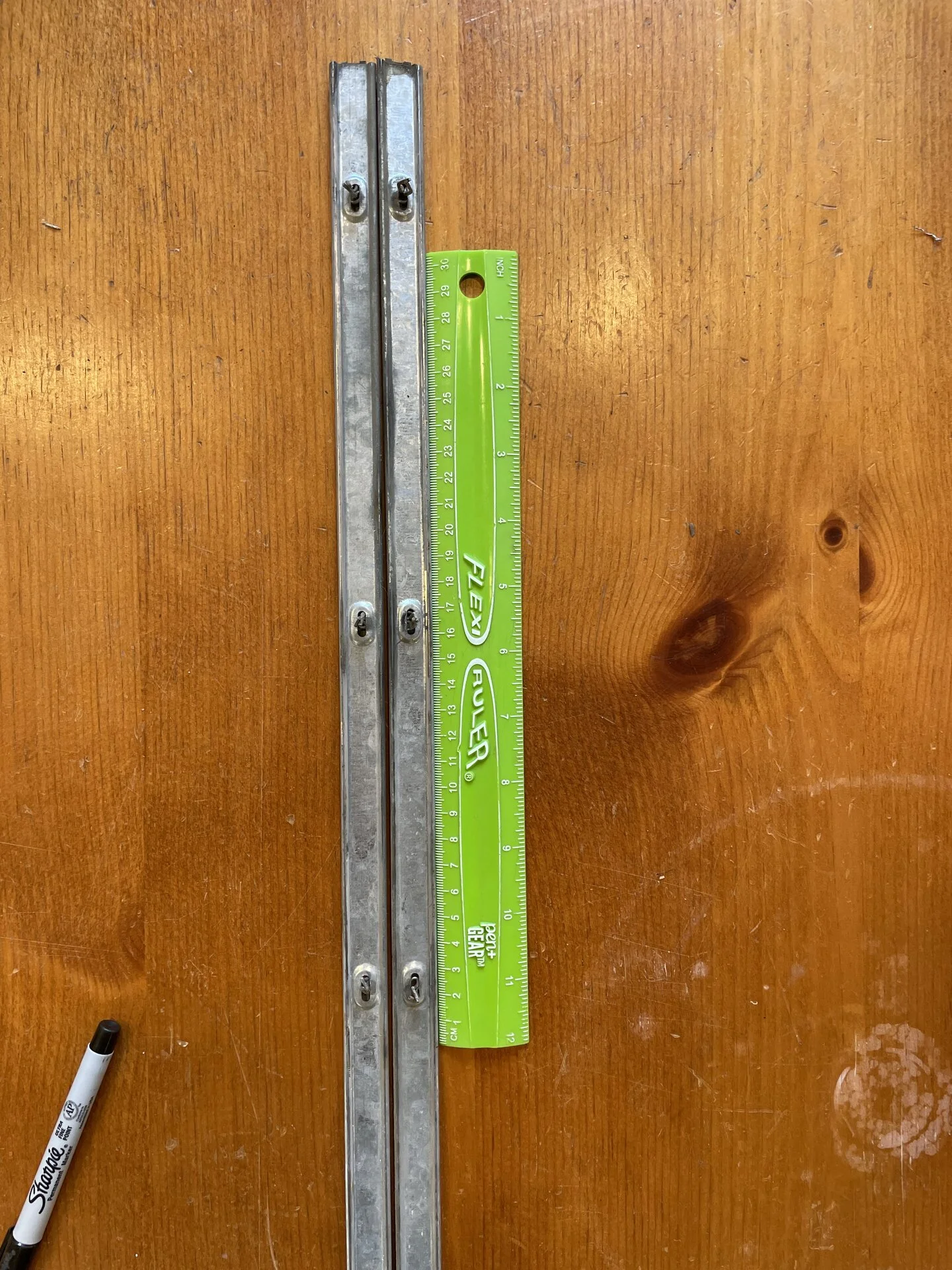

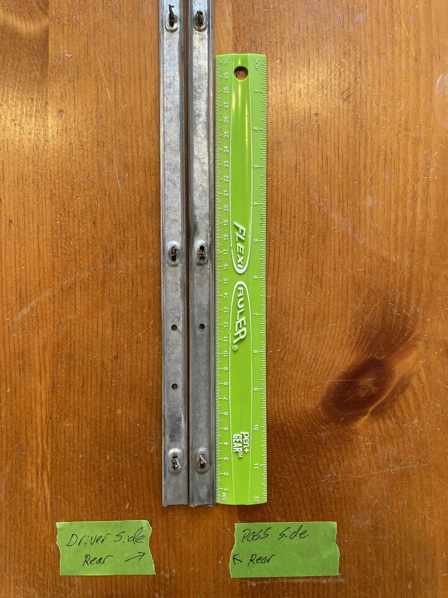

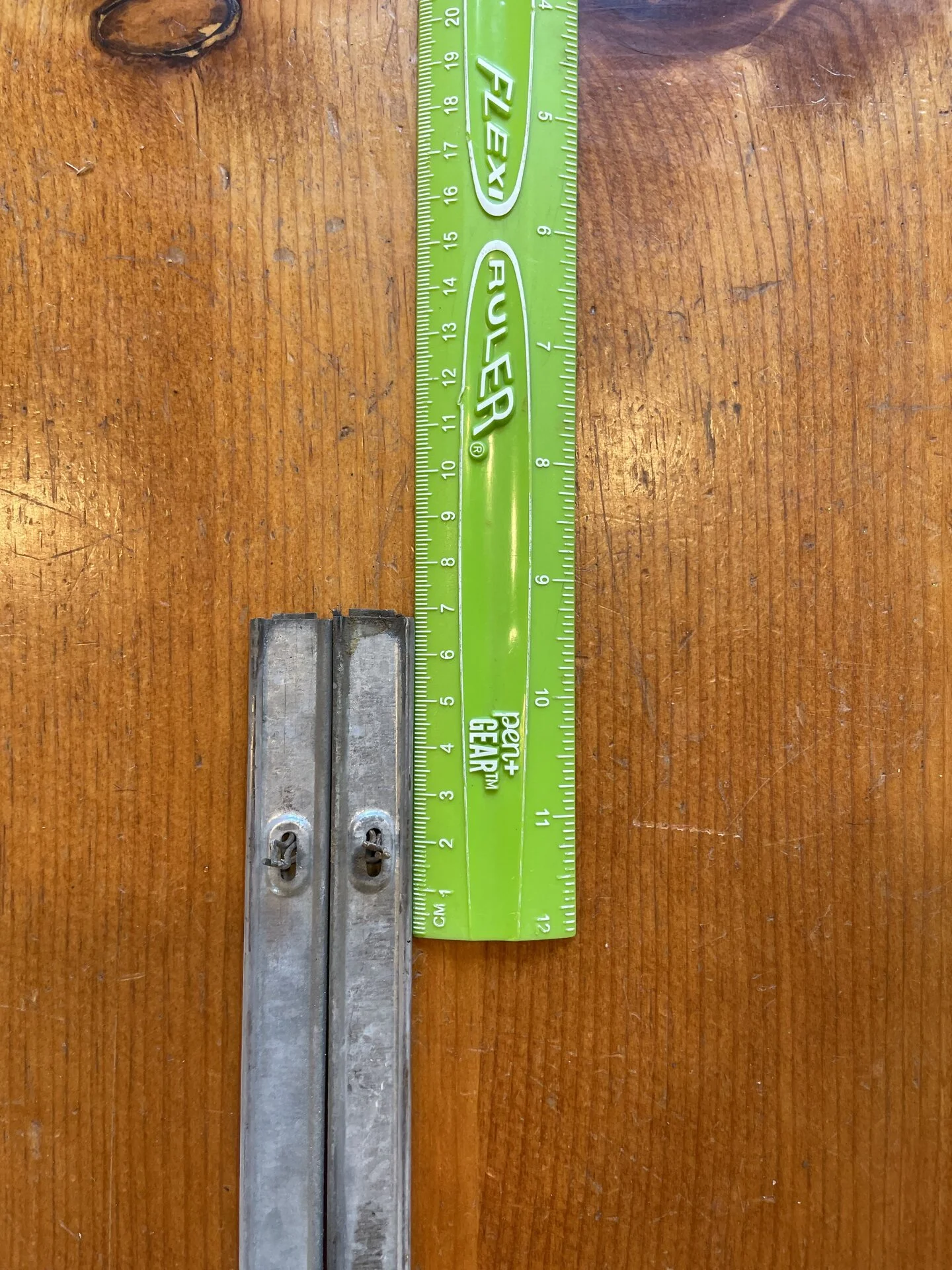

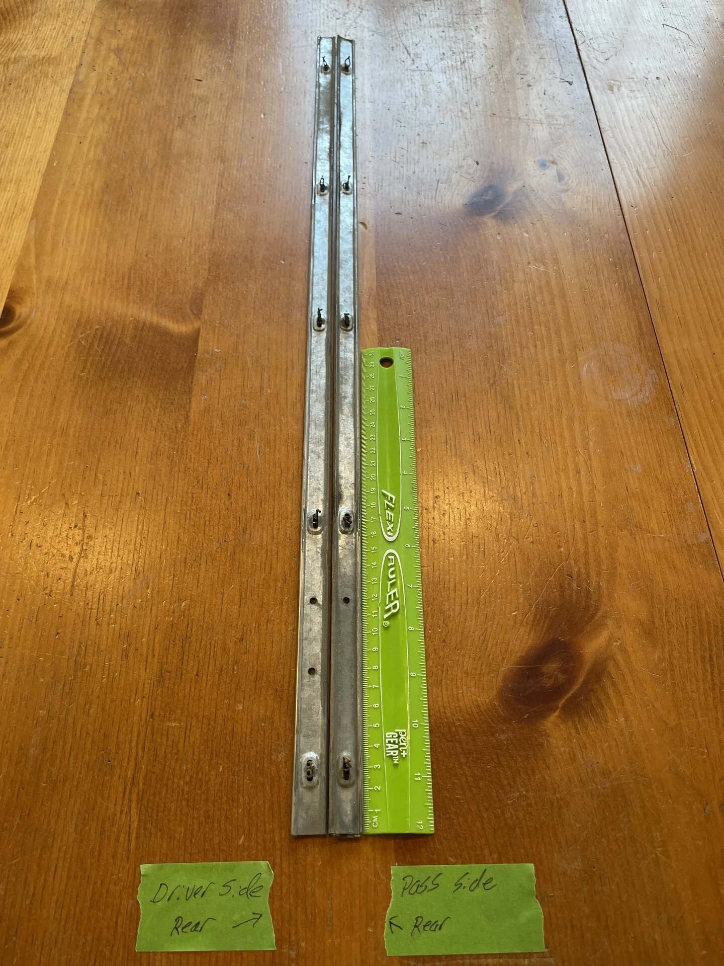

I have put the micrometers on everything and I see no reason why it wouldn't just flip to the other side unless the felt "grain" was somehow directional. Pins are dead center and the stainless edge rolls are the same thickness. Felt looks symmetrical although all the fibers have worn off. I guess I could pull the passenger side and make sure that the pins are spaced the same.
If you put the LH and RH side by side, see if there's any difference.
Zero difference. Just went out and pulled these. I was in the process of recreating these but might put a hold on my makeshift production and wait for yours @Racer65
Production Nov. 77’
My apologies for the crude measuring device I can’t find my metric tape measure to save my life right now.
LOL Why didn't I think of that?
I'll pull the passenger when I get a chance and let you know.

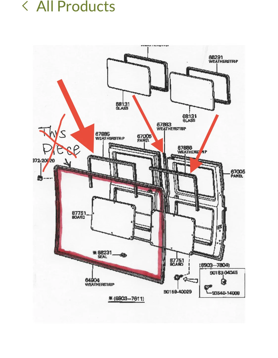

On a broader note, I'm reproducing basically every piece of FJ55 weatherstrip, some of which are already available on cityracerllc.com. Other pieces like this one are still in development.
What are the chances you can do these? When you do I’m in for two sets
(I’m in for at least three full sets of the inner felts, too.)
