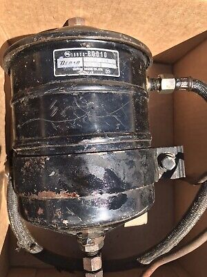

Thats not the correct oil filter set up for that truck, its something aftermarket. Should have canister type oil filter that bolts to intake manifold.
Your stock setup should look like the attached photo, with the exception of alternator and style of air cleaner. Your truck should have a generator and a earlier style air cleaner.View attachment 2662938View attachment 2662939
No holes
There is a mounting bracket that is fastened to intake manifold by two u-bolts. They wrap around either side of the square intake port of manifold with threads towards the fender, then the two mounting plates attach to the u-bolts. Outer mounting plate has the two straps that hold the oil canister. U-bolts and strap nut and bolt are only parts missing from photo.

That will be a easier way to go. You can make your own plate and just get the square u-bolts from hardware store that fit.
