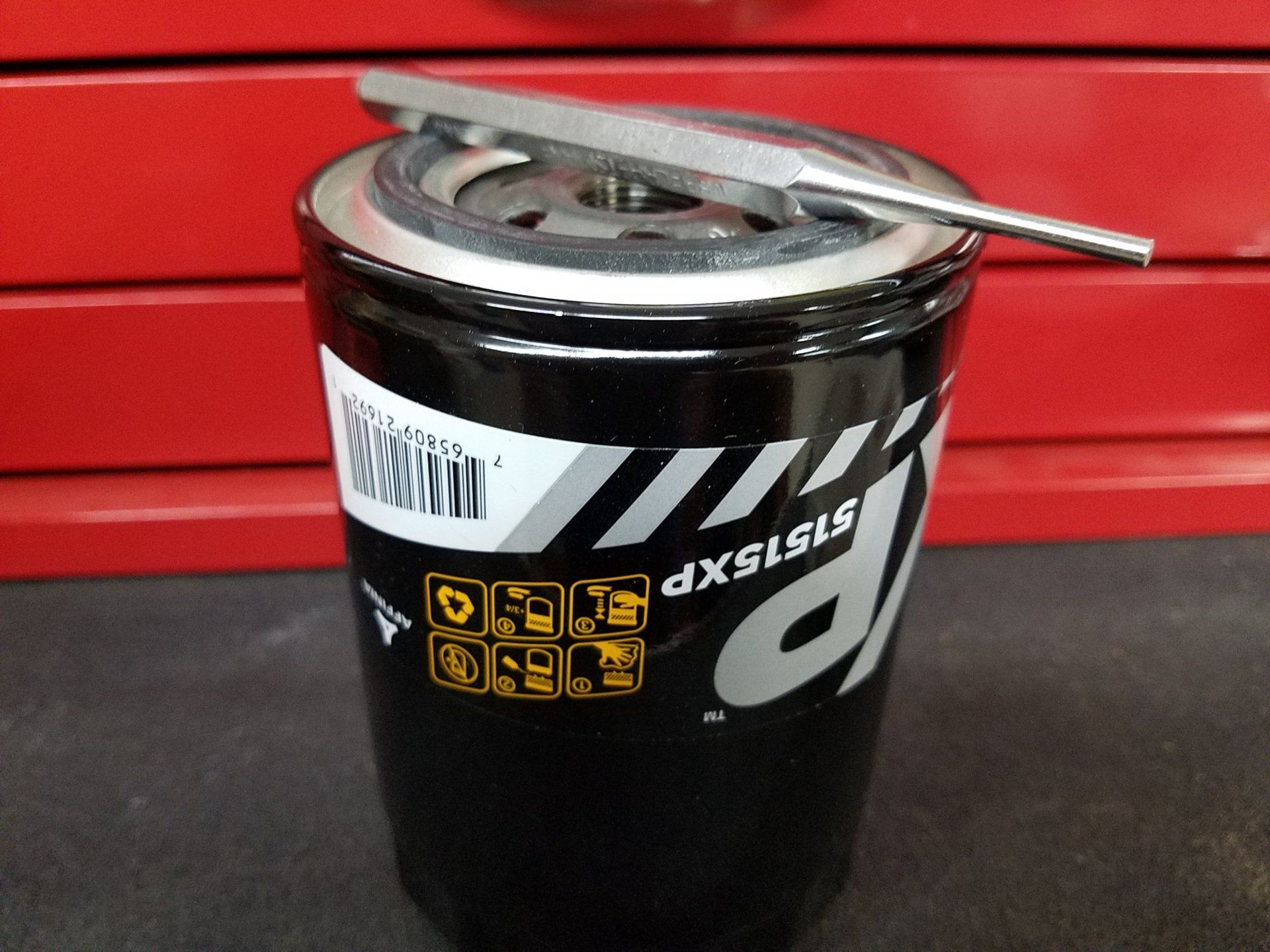

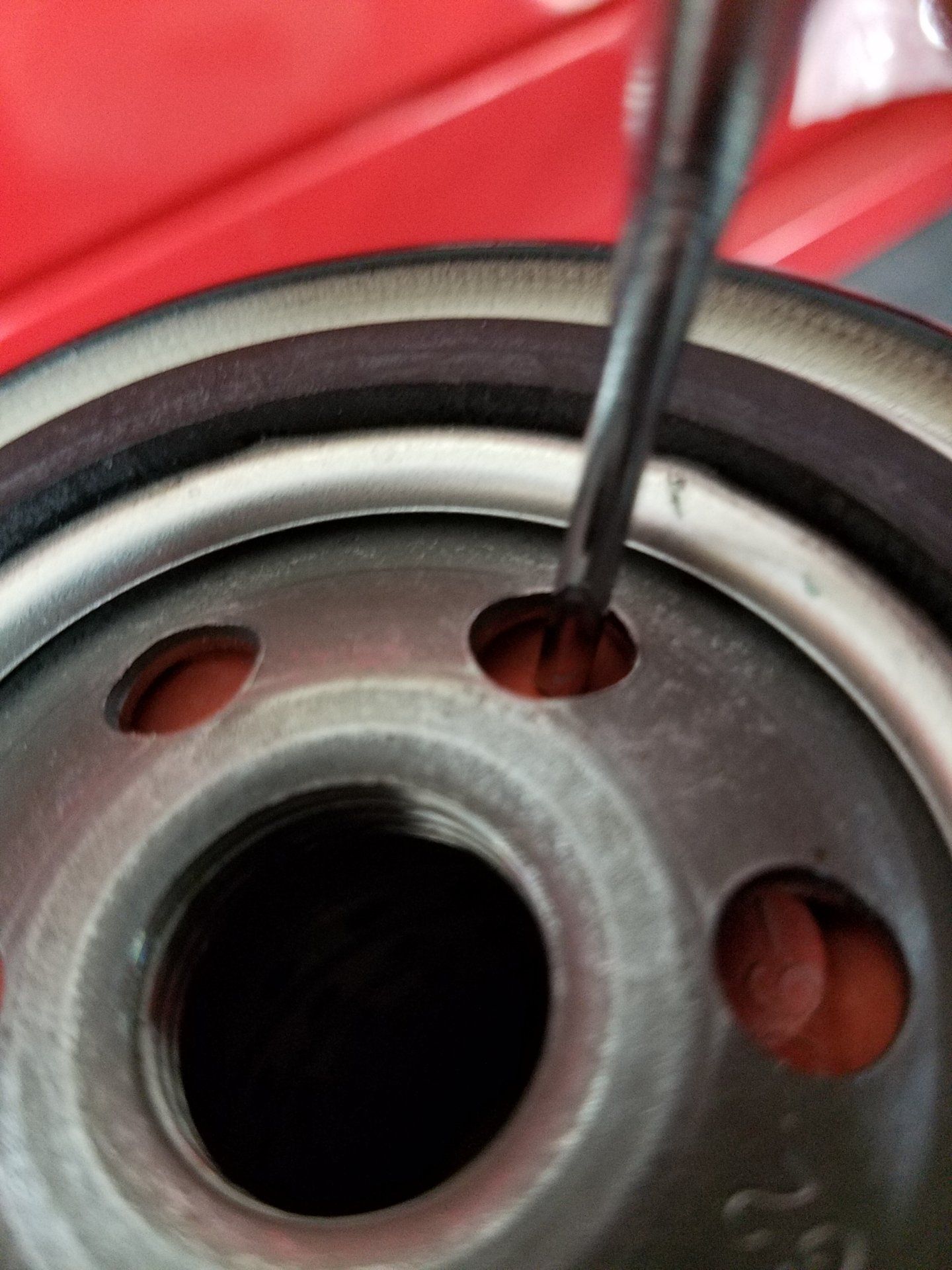

I had a Wix 51515XP in my drawer of potential oil filters. I took a quick look at it. It has an orange anti drainback flapper inside the inlet holes. Out of curiosity, I poked it with my little punch. It was sort of "stuck" and required a bit of effort to open it. As if the orange (silicone?) disk was stuck to the metal filter body. It moved freely after I loosened it. I pressed my punch at each of the holes, and each one had resistance and a definite "tick" when it released. A second push on each required no effort to move it again.
I don't know if this would have caused engine failure, but I can see where low pressure may not have been able to overcome the stuck flapper, especially with a known "low oil pressure at idle" engine.
I'm glad I didn't use this filter.

I had a brand new 51515 (had because I just threw it away) with the same issue regarding the orange valve. It is stuck. I pressed relatively hard on it and it would not budge.
So that valve is supposed to move easily up/down?
It's just a rubber flap. On mine, it stuck the first time I pressed it, then it felt free. If I left it sitting a couple days, it got sticky again, for the first press only though. Repeated this a couple times and pitched the POS.
