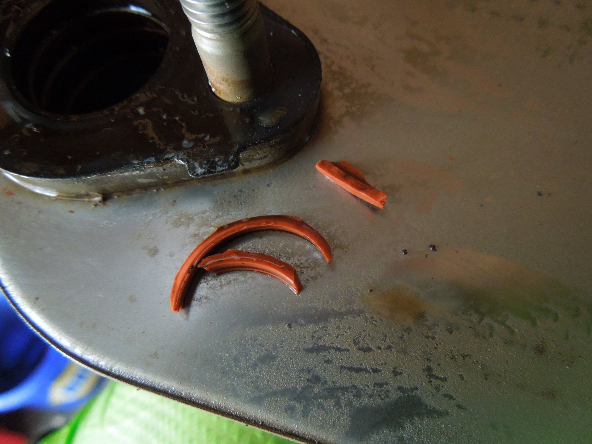

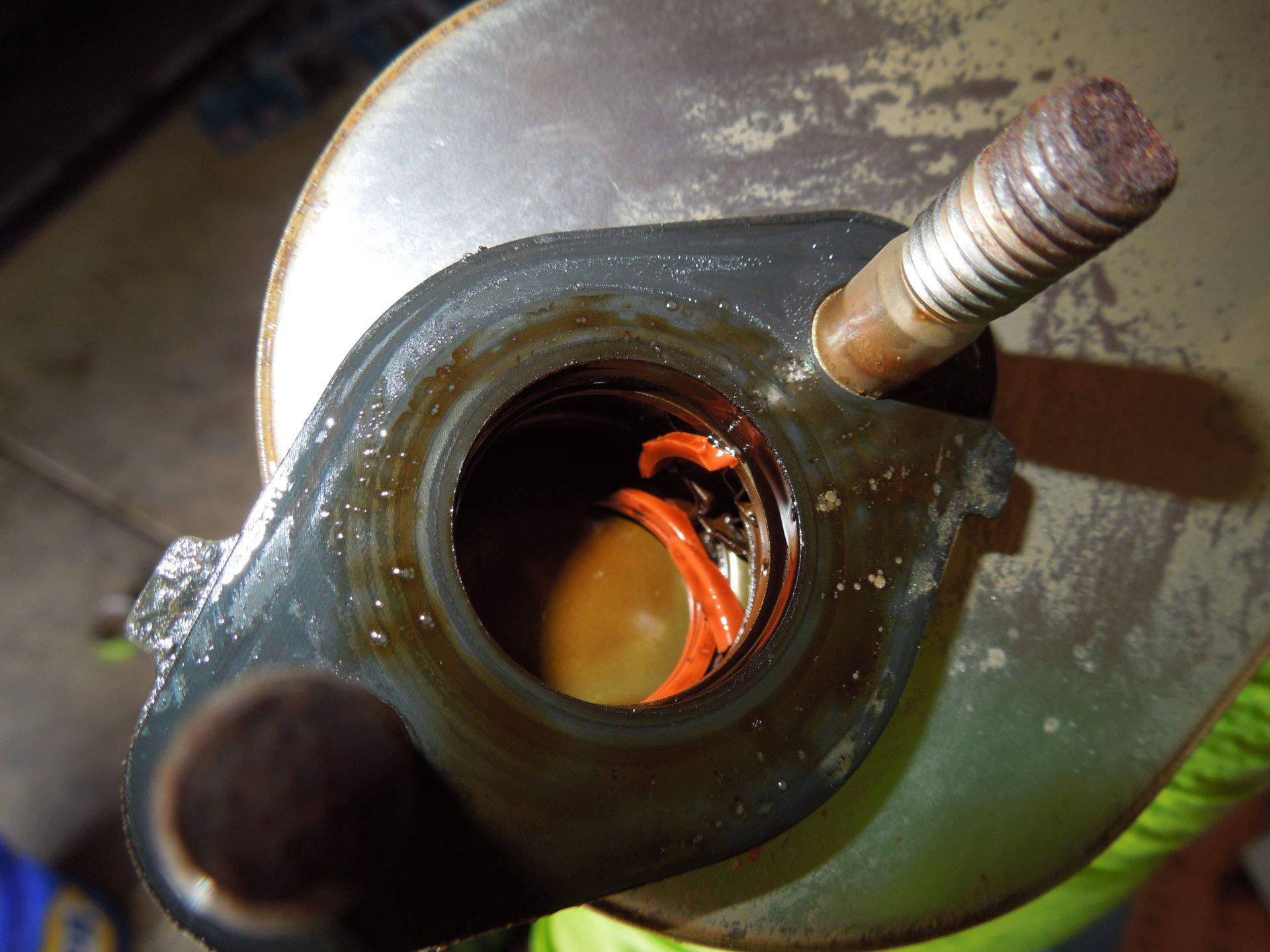

I just opened the oil cooler on a motor that died due to oil starvation, while using a Wix (napa gold) filter. It was sent to them, who of course said no fault. Am i crazy or does this look like a part of the filter?
I just opened the oil cooler on a motor that died due to oil starvation, while using a Wix (napa gold) filter. It was sent to them, who of course said no fault. Am i crazy or does this look like a part of the filter?View attachment 1694575 View attachment 1694576
To me it looks like chunks of the anti-drainback valve. Same orange colour that Wix uses. Yikes.
Exactly what I thought. I shouldn't have let them take the filter .
That sucks. Not sure how many of these Wix filters have :poop: the bed and taken out good motors, but it sure seems Wix filter failure on the 1FZ is a common thing now.
