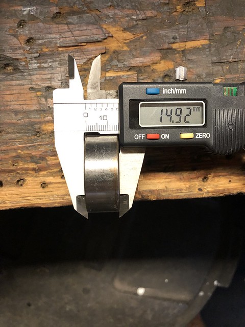

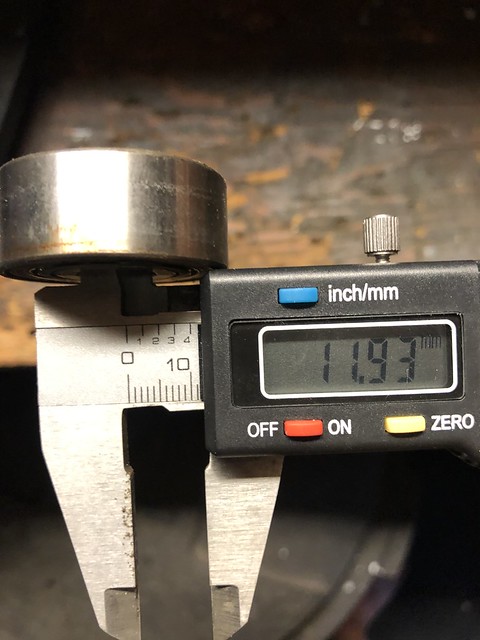

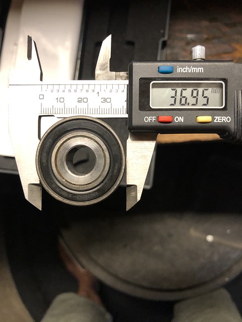

It is not a double row bearing, at least not in my 2UZ non VVTi engines.
I still have the pulley I replaced so I will see if I can get some time and pop the bearing(s) out to see what exactly is going on in there.

Found on Tundra forum: NSK BD20 - 15T12DD at $38 in 2017
