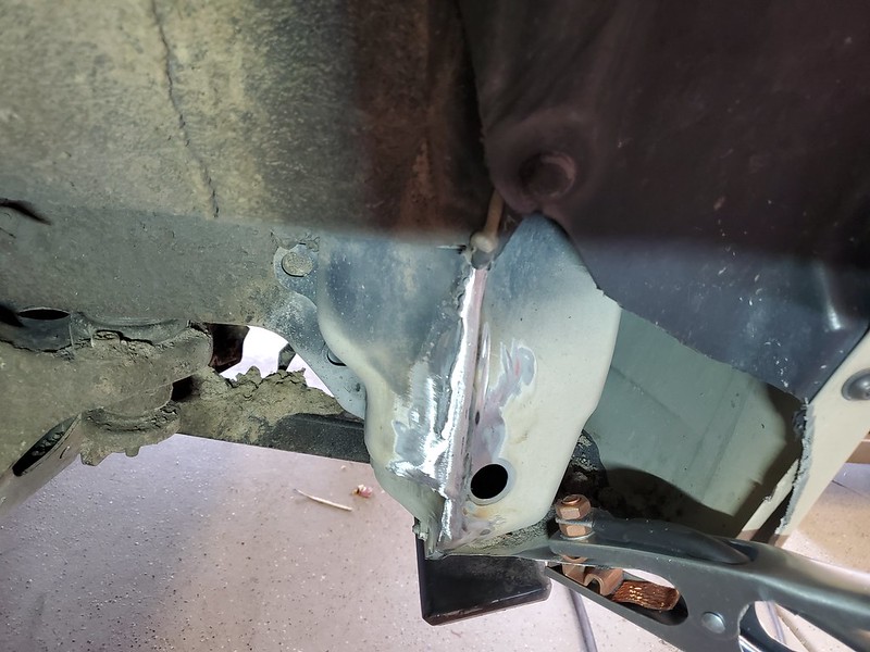

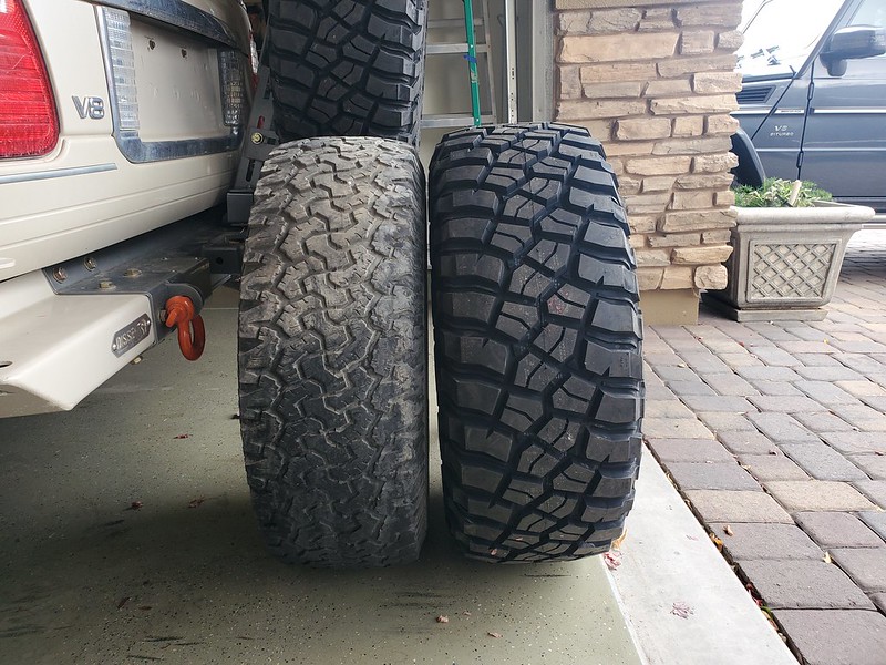

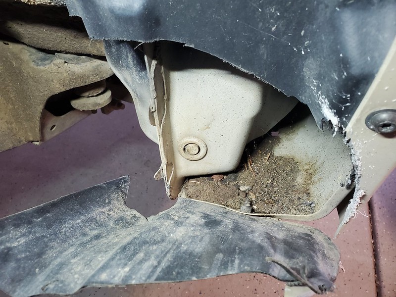

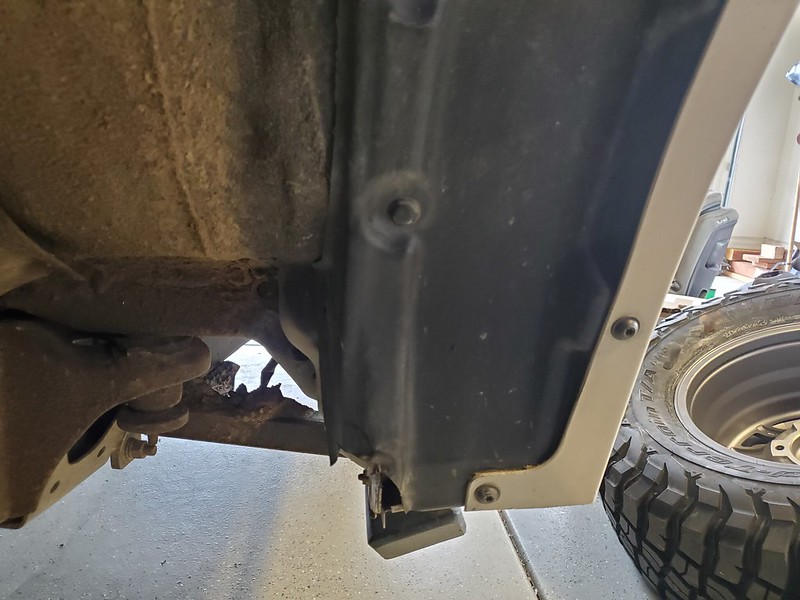

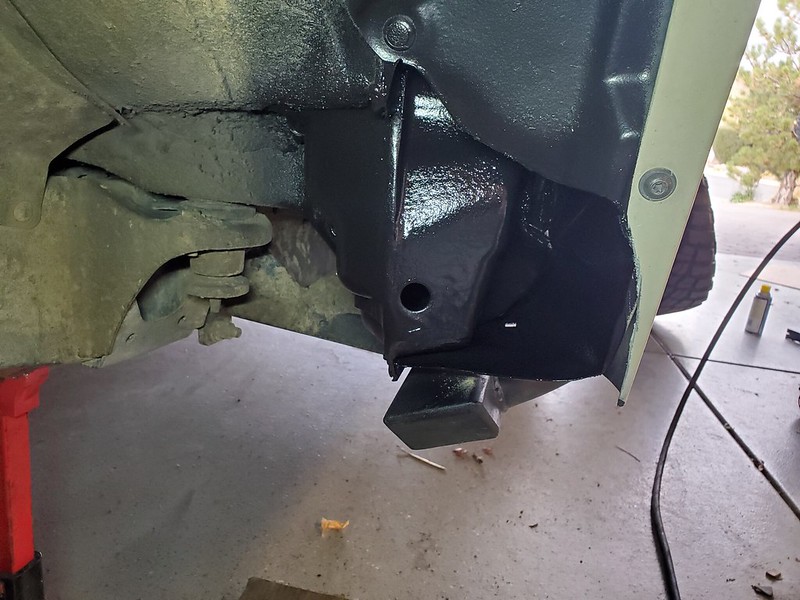

As others have mentioned, fittings 35"s (315/70/17) is not for the faint of heart. With the spacers and the +30 mm offset from the wheels, serious work is needed on the front "pinch weld" to get the tires to clear. The name is kind of deceiving, it's not really a weld, but instead 3-4 different sections of sheet metal folded together at the end. When you cut and trim, these sections are no longer joined, so I ended up welding them back together. A little primer and rubberized undercoating later, and things are good to go. In trimming the finder lining, you create an area where wheel spray can get into the rear portion of the fender, the rubberized coating should keep corrosion at bay. If any, at least now you can get in there with a hose or pressure washer and keep it clean, Before, this area was just packing mud and I couldn't even tell.
I still need to get some extended bump stops for the front (Wheeler) and bump stop extensions for the rear. Even with those, I think I am going to have to cut the top portion of the fenders because at full stuff, they will likely impact the fender lip. Getting rid of the spacers would help.
Liner before cutting
Hidden debris, only a matter of time before this created a rust issue.
After plenty of cutting/grinding/welding

All cleaned up

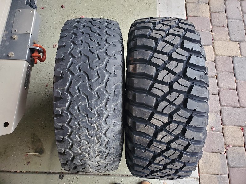

Even though 34"s fit without much hassle, that extra 1" from the 35s really makes things more difficult. The width is a factor too.
