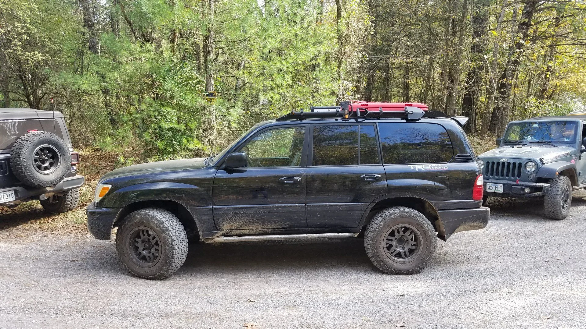

Icons fit. Front cap doesn’t.

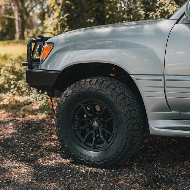

Found some evidence from an IG page under Kingschariot -
All thanks to @socalmtbiker
I wonder how the caps were added to the front.
I’m referring to the Vectors only!
...and I’m not a gambling man but I’d bet my left nut they are running spacers on the Vectors
(+25 offset doesn’t hang out the side like that)
Check out the pic below, the one above is the IG page preview.

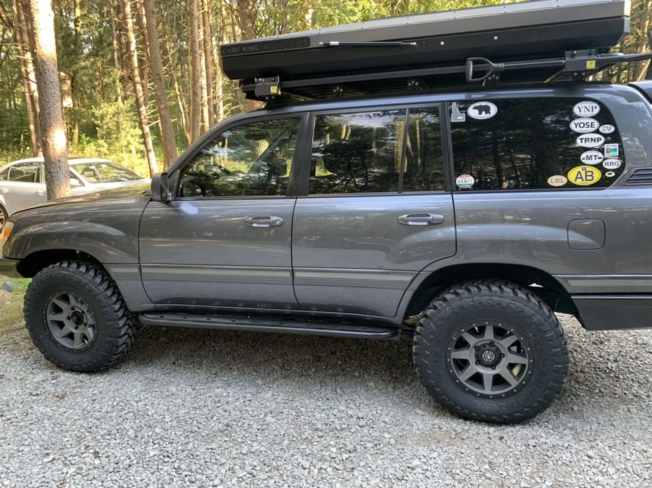

Thanks. 295/70-17 Toyo M/T, Icon 2.5 suspension. No spacers, pinch welds gone. No rubbing yet.
Thanks for sharing mate. It really helps clear out the spacer doubts we're having here. I think i might just pull the trigger on the Vectors.

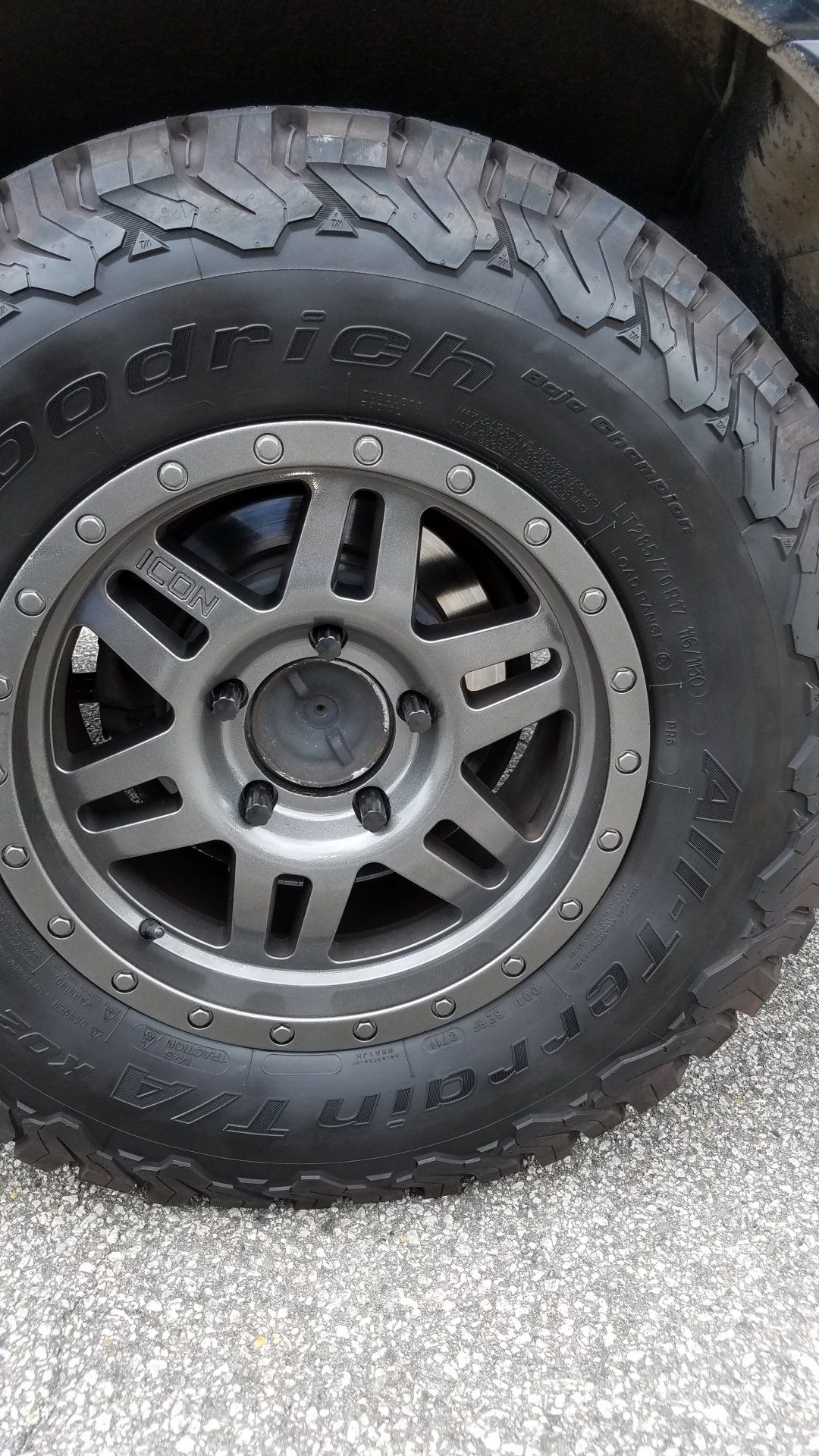

After making a bunch of calls across the US West, it seems like the Vectors are a few weeks out so I'm thinking of going with what @Dparo has on the LC on 17x8.5. I feel they're sharper looking compared to the 6 speeds. Got a quote for 4 plus 275/70/17 KO2s - $24xx out the door. I'll wait on it to see if a set of Vectors pops out of somewhere magically.
