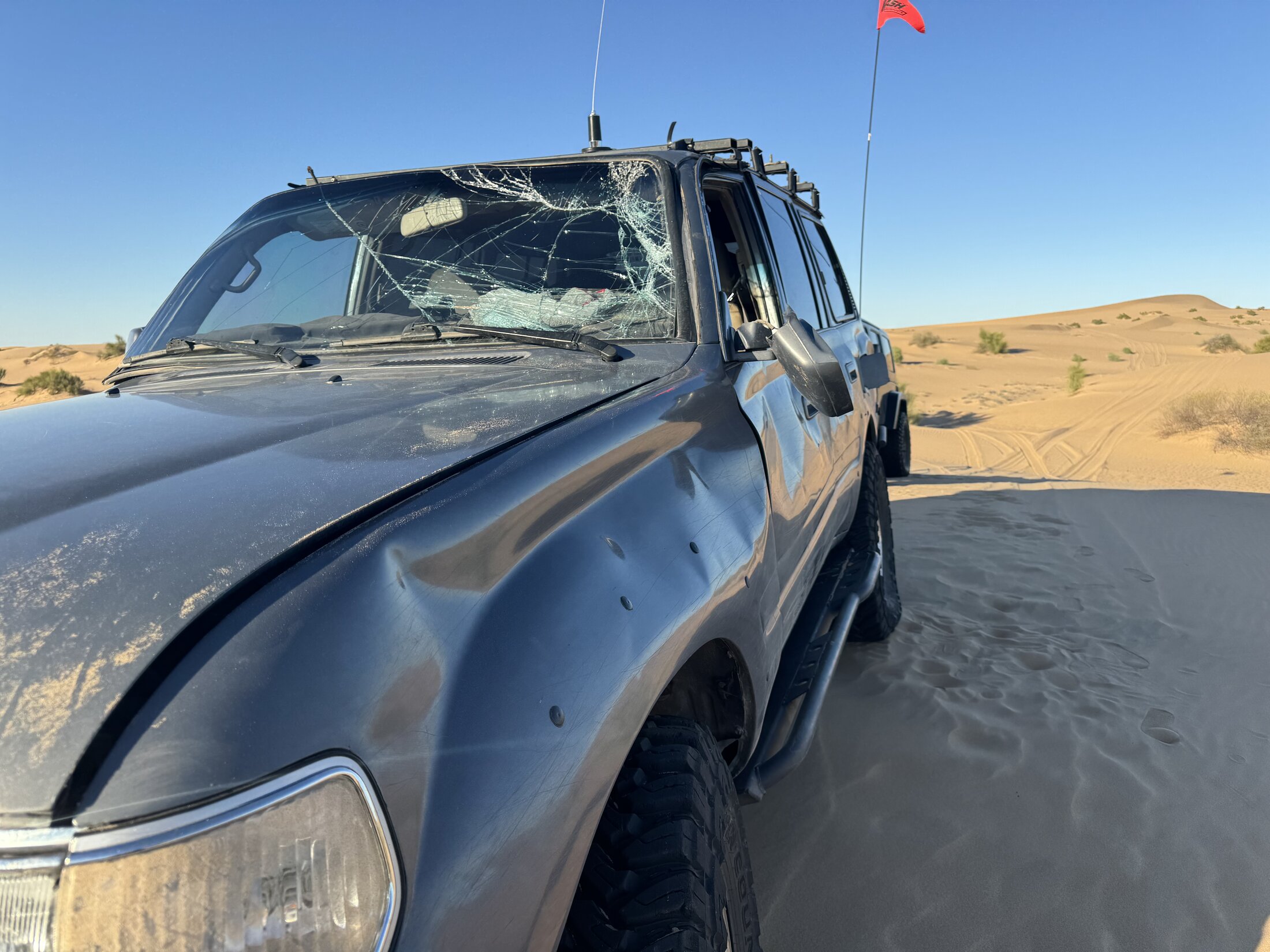

Well somehow I managed to roll my 96 in the dunes in Mexico. A soft rollover, landed on the wheels and finished the weekend with a cracked windshield. No one was hurt, all buckled in and gear was strapped down tight. Now for the reality of dealing with an incredible mess. 163k miles runs great, triple locked, 4.88's. I drove her home at 70 mph and it ran great. I'm thinking a donor vehicle is needed to make this right. Anyone got any leads on a donor or a stipped down cab in good shape? I'm not sure what's easier - putting a new cab on the existing rig or transferring all of the drivetrain to a donor rig. Any input is appreciated. Thanks.

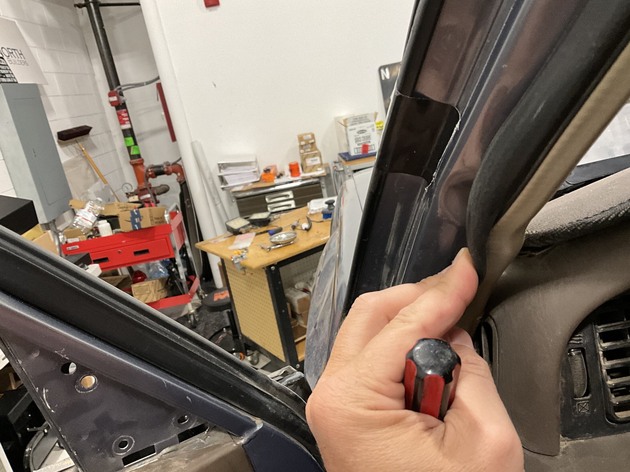

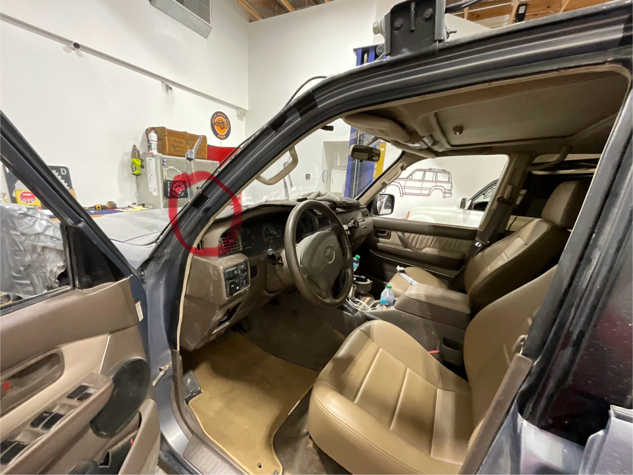

How bad is the A pillar? Hard to see in the pics. If it were me, I would start at one end or the other, pull interior panels, and take my time working the body back out. Seeing how "Bob" already autographed it for you, it just ads more character to its story.

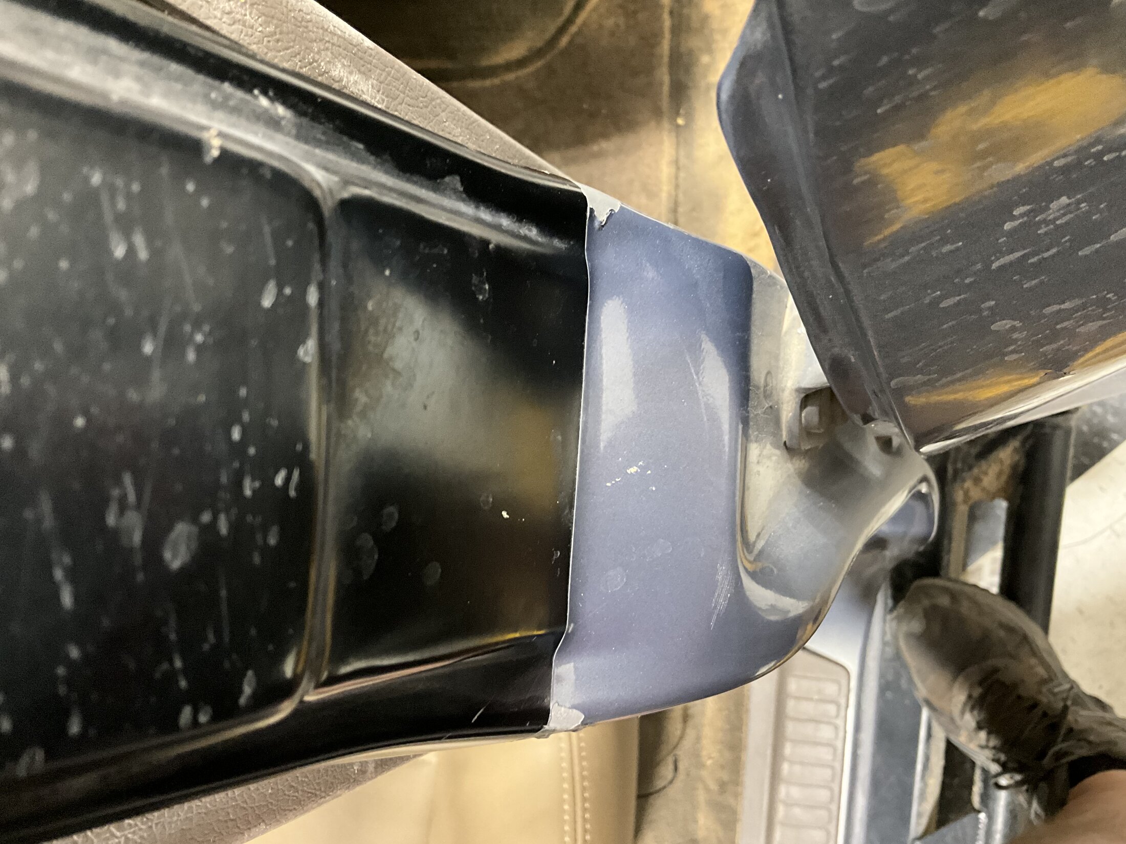

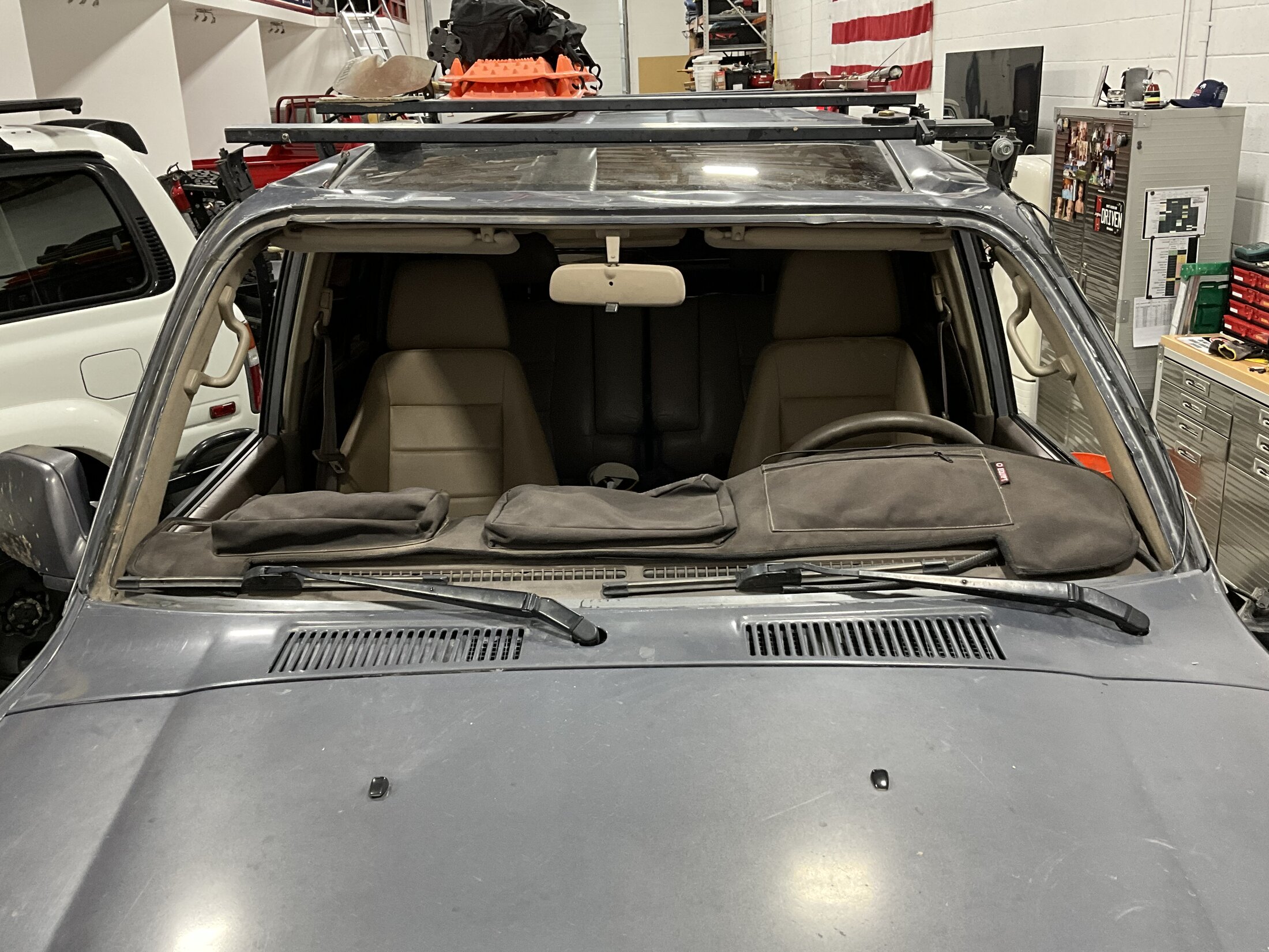

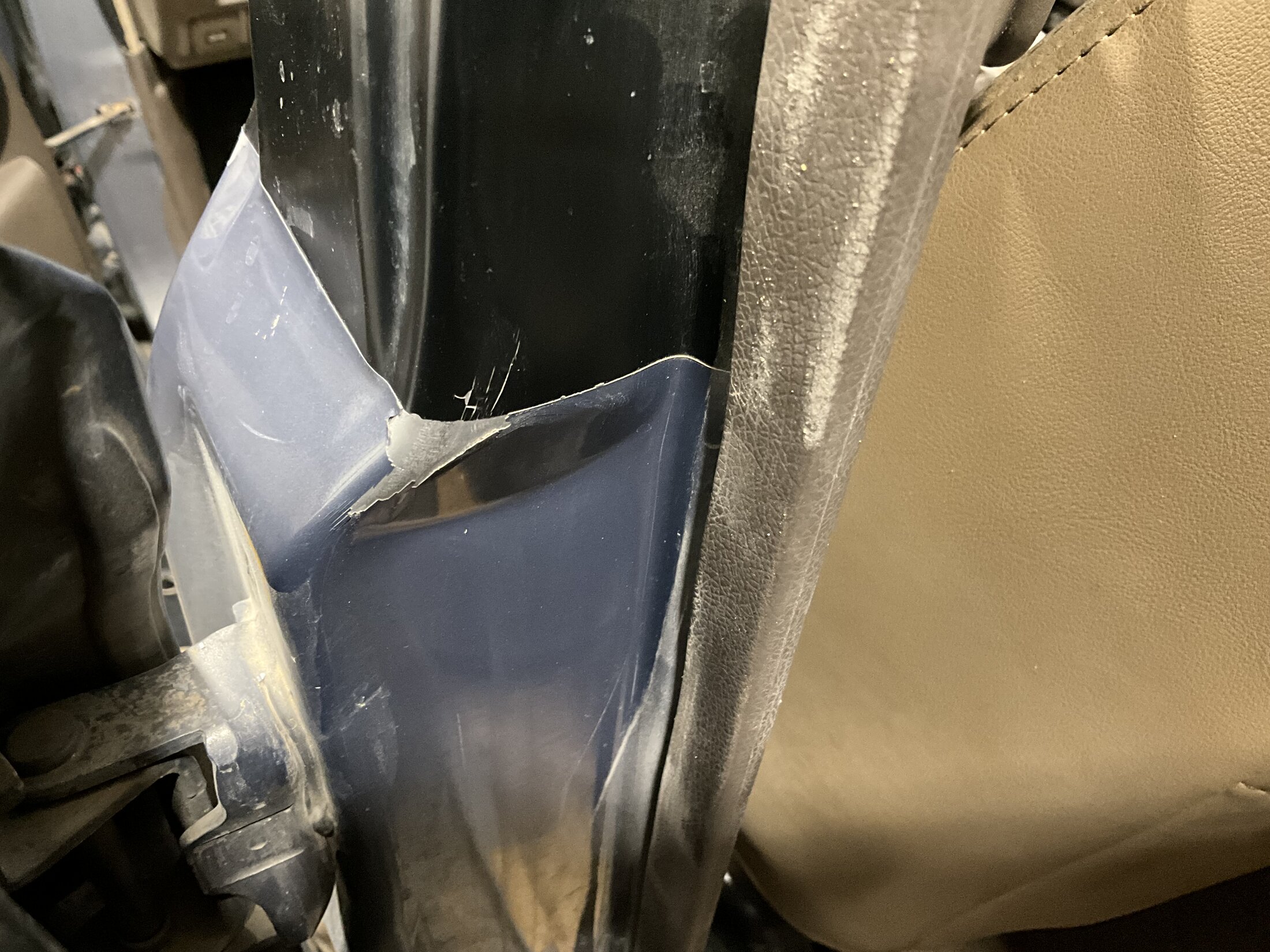

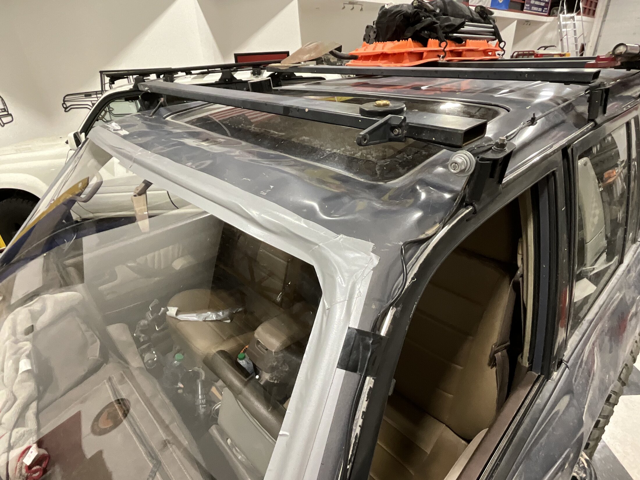

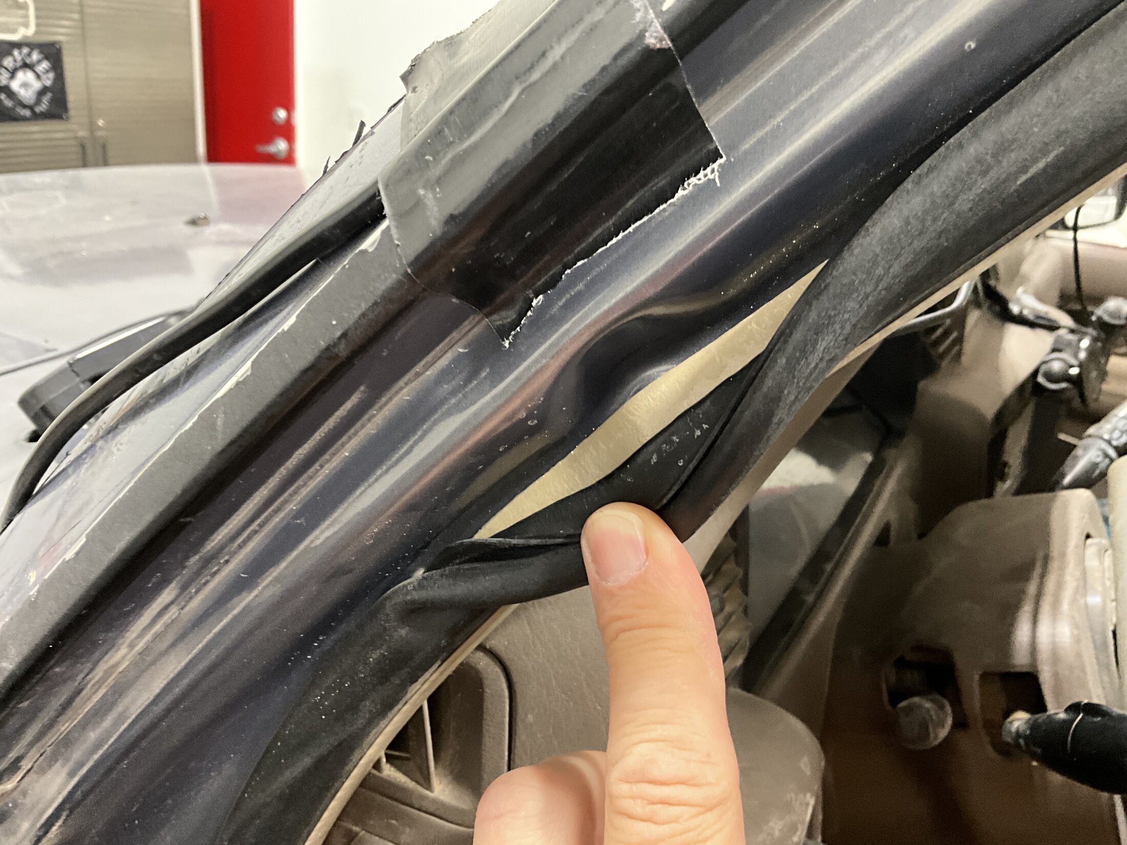

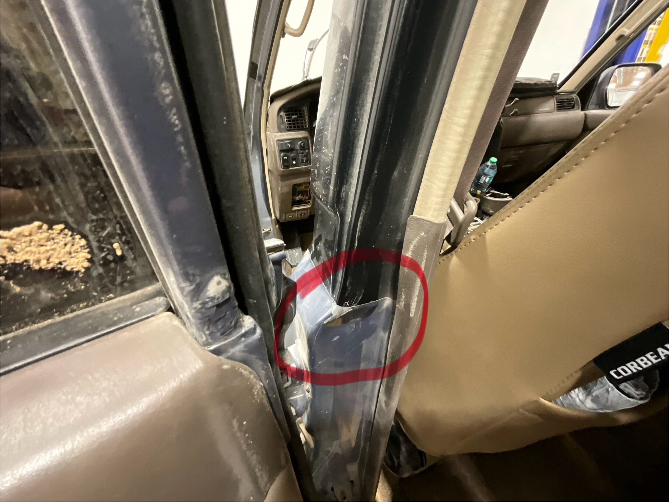

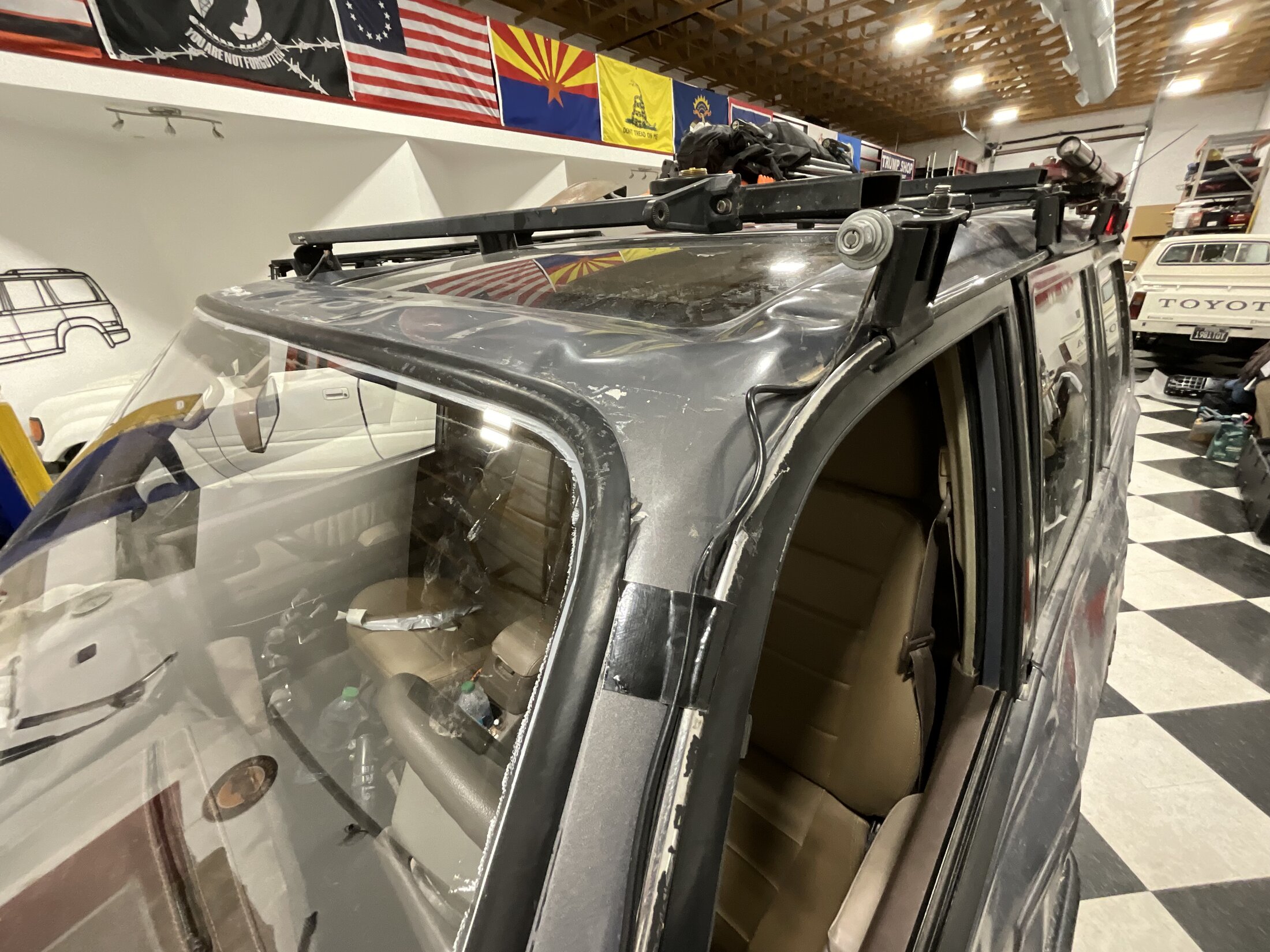

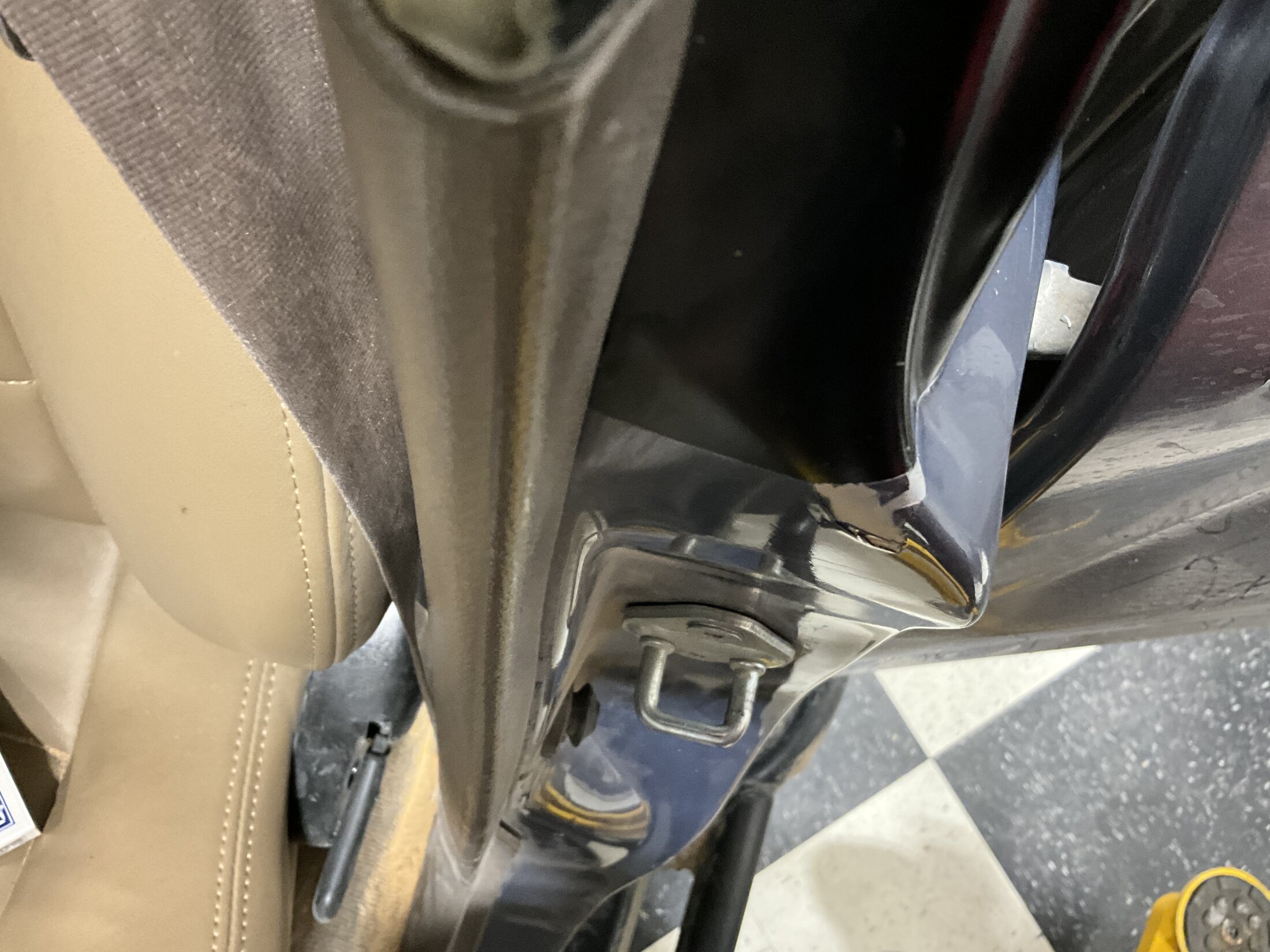

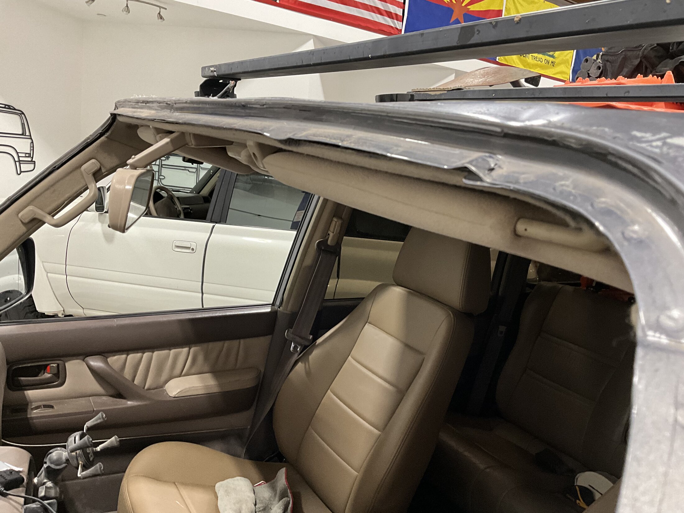

Ok - shop day. Here are some better pics. When I measure off my “light duty” 80 it looks like the actual windshield frame crushed only about 1/2”. My drivers A pillar deformed just a bit. Drivers B pillar flexed enough to crack the cheap repaint. I have a body man around the corner. He was pushing for a donor cab but now I’m thinking with a driver front fender, drivers doors, and a game plan to rework the crushed roof somehow, I just might be able to get this young lady presentable again. Appreciate the feedback!

Ok - So some creasing on both A and B pillars. It looks like the cab crushed minimally at the B pillar - only about 1/8 - 3/16”

I mostly agree with you. Looks to me like the sunroof option which we all have in the US gives you less cross members and therefore less “cab-crush” safety. At least that’s how I see it. If I can rebuild the top and add those non-US cross members (delete sunroof) I would think that would help a lot. Hoping someone on here will tell me that those A and B pillars can just be reinforced with some flat metal from the interior.
