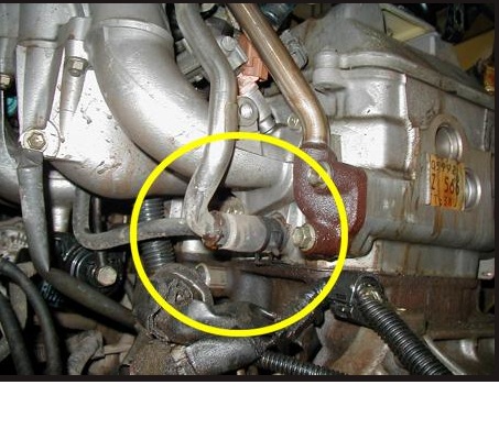

If it is the PHH, if it cracks and splits…..I believe you will lose a lot of engine coolant quickly, possibly like artery bleed quickly.
****...it's hard to see. I can't from top. I happened to be wedged between tire and wheel well looking at stuff and saw it
Is this it? Sorry, I have a 1-HDT and I believe the PHH is located elsewhere on the engine.
Have a look here…….
Here as well……
Here you go, explanation and coolant hose routing……
the hose you pointed out in one of your pictures is brown……it could fail at anytime.

Ya I learned my lesson took a wk to ship out my vent hose. Now that I've identified the hose the fsm will help. I was wayyyy off thinking it was a bypass hose looking at the fsm
I feel like any local auto store or hardware store should have that hose. I did make it home. Would this hose affect my heater not functioning how ir was a month ago when I did thermostat? Ima go shopping tomorrow at local stores
