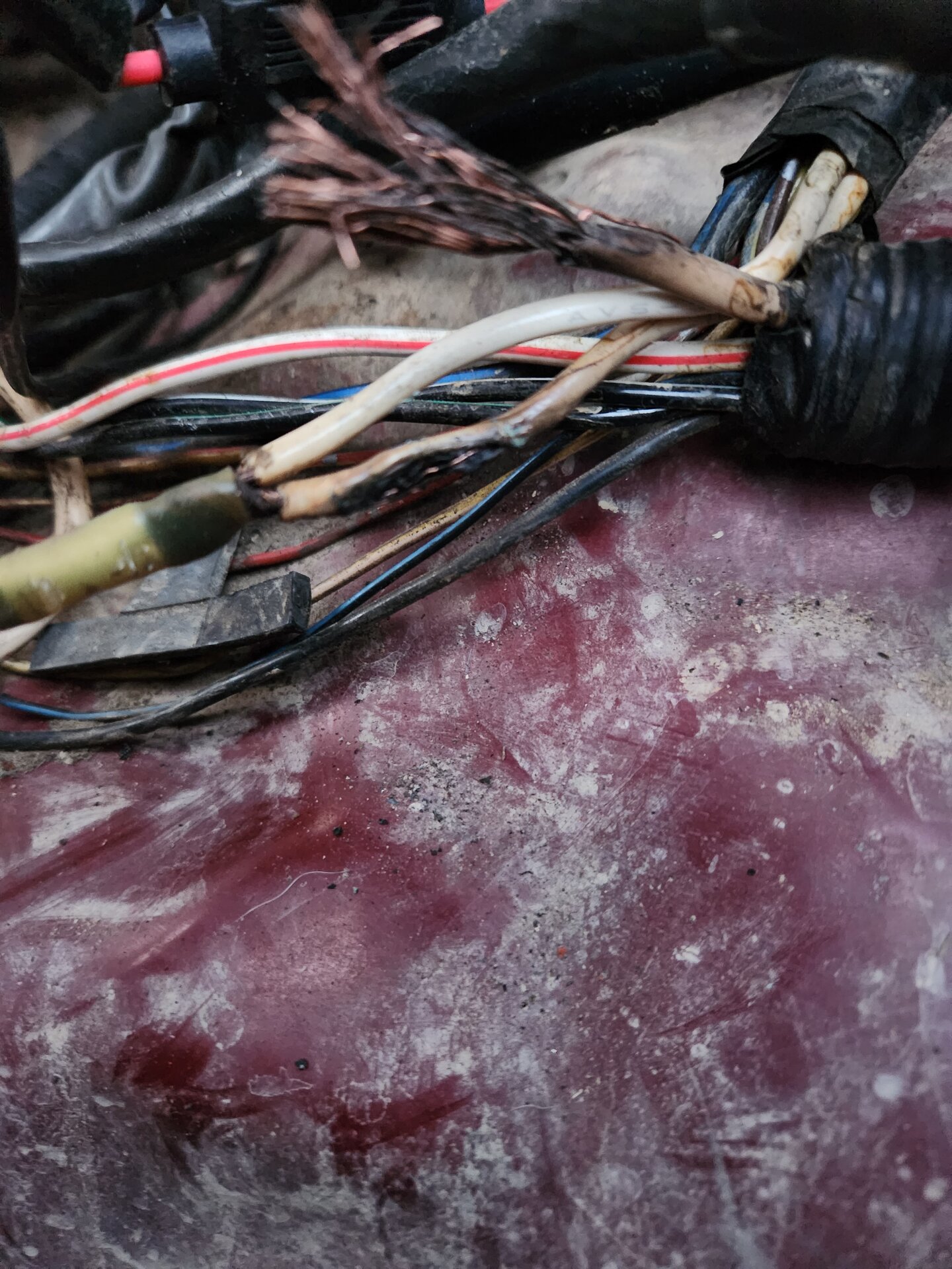

My s*** caught fire yesterday... im defeated. I understand the fsm. Everything points to the blue fusible link portion but is there supposed to be a harness from there to the engine fuse box? I can't find anything

Fusible links r in place, I did major repair today. I'm convinced. U can't kill a yota. I am in process of getting a new harness and fuse block cuz it looks like he did something weird in there to. Just wrong time of yr :/ I had to cut alot of burnt wires. But I did it the right way. Same.gauge wires, heat shrink connectors plus heat shrink over the connectors. I still have a battery draw when driving and come to a stop. But that's an issue for another day. I'm proud of myself. This was alot of work

The pictures you have show that the ground wires were the ones that got so hot they began to melt and catch on fire. This cannot happen in the stock configuration using the fusible links in their intended locations. It ONLY happens when people add aftermarket crap, wired directly to their batteries with improperly sized fusing, if any fuses are used at all.
Good work replacing wire with the right gauge, you get style points if you match the colors.

Did the fire/melting start at that butt connector??

So it wasn't ground ground wires, I chased and followed them. Tore the fuse box apart, it was 3 wires. One that goes to efi fuse, 1 that goes to the charge relay block and the 3rd one goes to a connector between fender and fuse box. I know what happened, or at least have an idea. I also upgraded the alternator wire to 4 gauge. And ran all 3 that were connected, separate to alternator. I stopped and looked at one in person yesterday to get an idea of what was missing. What I assume happened was my quick splice that I used to try and fix his wiring mess got bounced around because at one point my battery wasn't tied down enough and I didn't realize it. Which caused the metal on quick splice to go through plastic and likely grounded out causing wires to melt and connector to disintegrate. I cut all the burnt wiring out and using wire looms around the 3 on top of everything else. I am puzzled by why the fusible link didn't pop tho. Because after talking w u that part is correct. It's the wiring from alternator to fusebox that is issue

Huh for some reason I am seeing that white wire in my head as a ground (brown and white are common universal ground wire colors for Toyota) in that section of the loom that is spliced from the factory to like 3-4 things (like you said). I’d need to check.
Was going to say that butt connector looks like it was hand crimped with a cheap crimper, you really have to use a higher quality ratcheting crimper to make a good connection.
Let’s say that butt connector wasn’t crimped with a ratcheting crimper and that one of the crimps was poorly done, that could easily have caused an increase in resistance that created the heat and fire.
