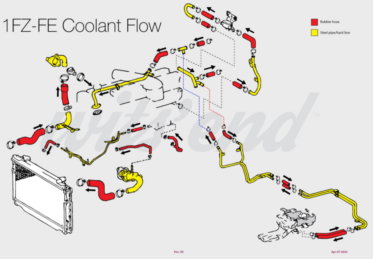

Don't wait for joey to ship you his hose, you could be waiting 6 months. If it's leaking and you need it get around use any coolant hose you have available. Any 5/8" coolant hose will work, its a common mod to use a small section of a 5/8" Green Stripe hose by gates. 5/8" White Stripe will work too it's just lighter duty. You can get this at any autoparts store.
If that hose blows out when driving you will lose all your coolant and overheat the engine.

You can run the bypass as shown in OPTION 2 as it's easier than trying to get the hose on the pipe coming down from the heater valve.
Below is how the entire cooling syctem circulates. Everything in red is a soft pipe.
There's two bolts to take it to remove the hard pipe.
Both 12mm, one is on the very back of the intake manifold, one near the top facing the valve cover.
You'll need a ratcheting wrench, and a lot of patience.
The hose itself is hard to reach, and probably best reached through the wheel well with front wheel off
