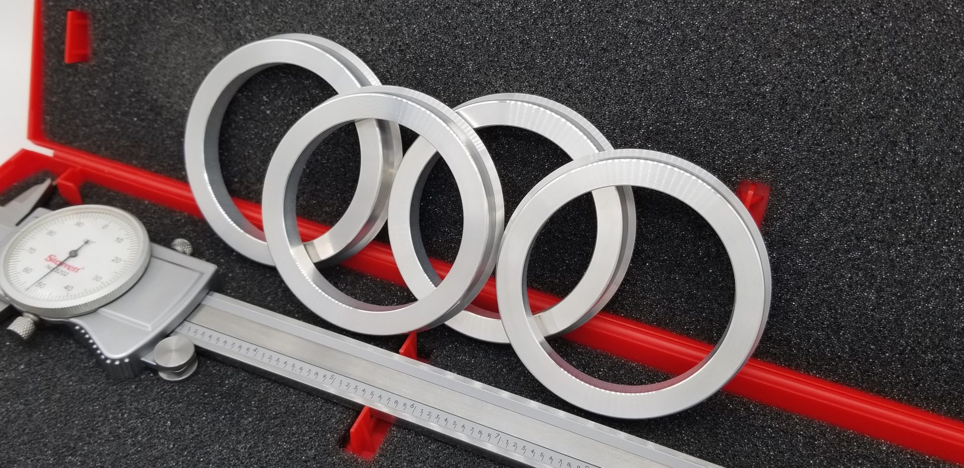

So just to verify, you guys are shaving down the hub surface by . 200" correct?
Carl shaved mine .160 and Cruzilla did .200 I beleive. There is a range that you can safely work with. I am not sure about those rings though. Ideally you would want to lathe the the hub nice and flat before pressing a ring on.
...and there's no need for a ring at al if we machine a bit more off the face, since there will already be a large enough "step" to center the rotor on without adding a ring. :) (thus the .200" dimension for V.2)
