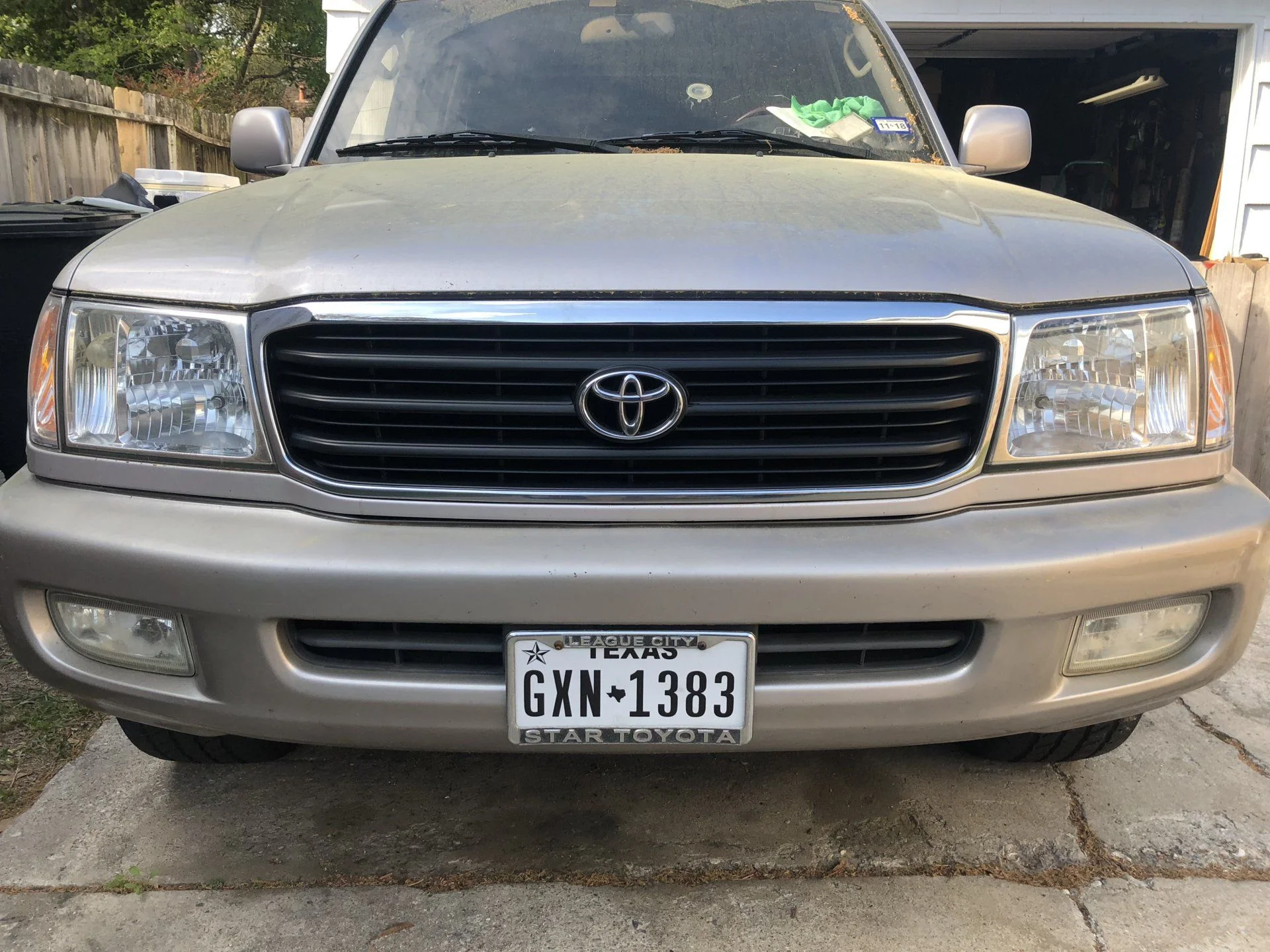

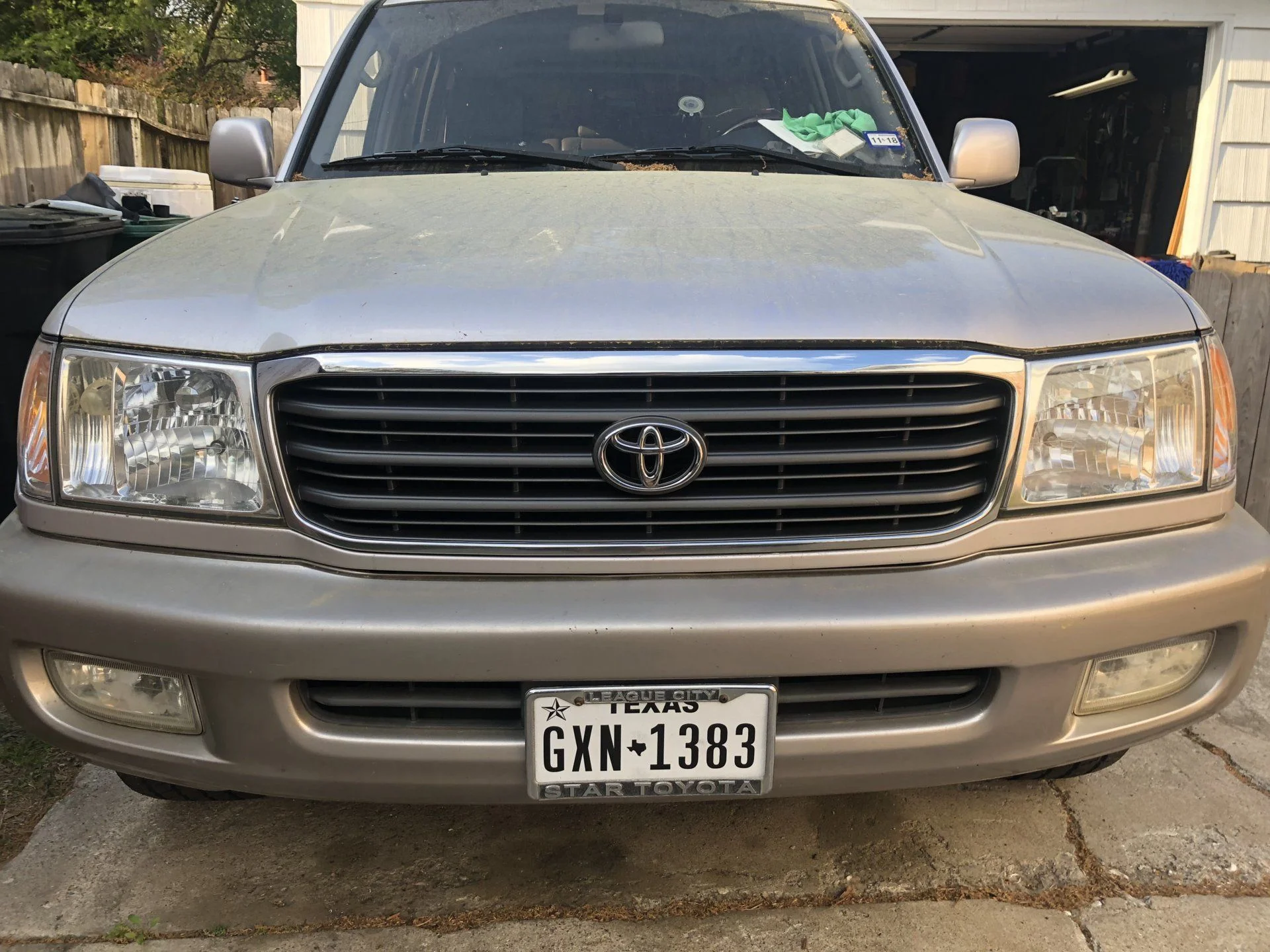

I changed the color of the grille from black to Anthricite Grey PlastiDip to update the look a tad

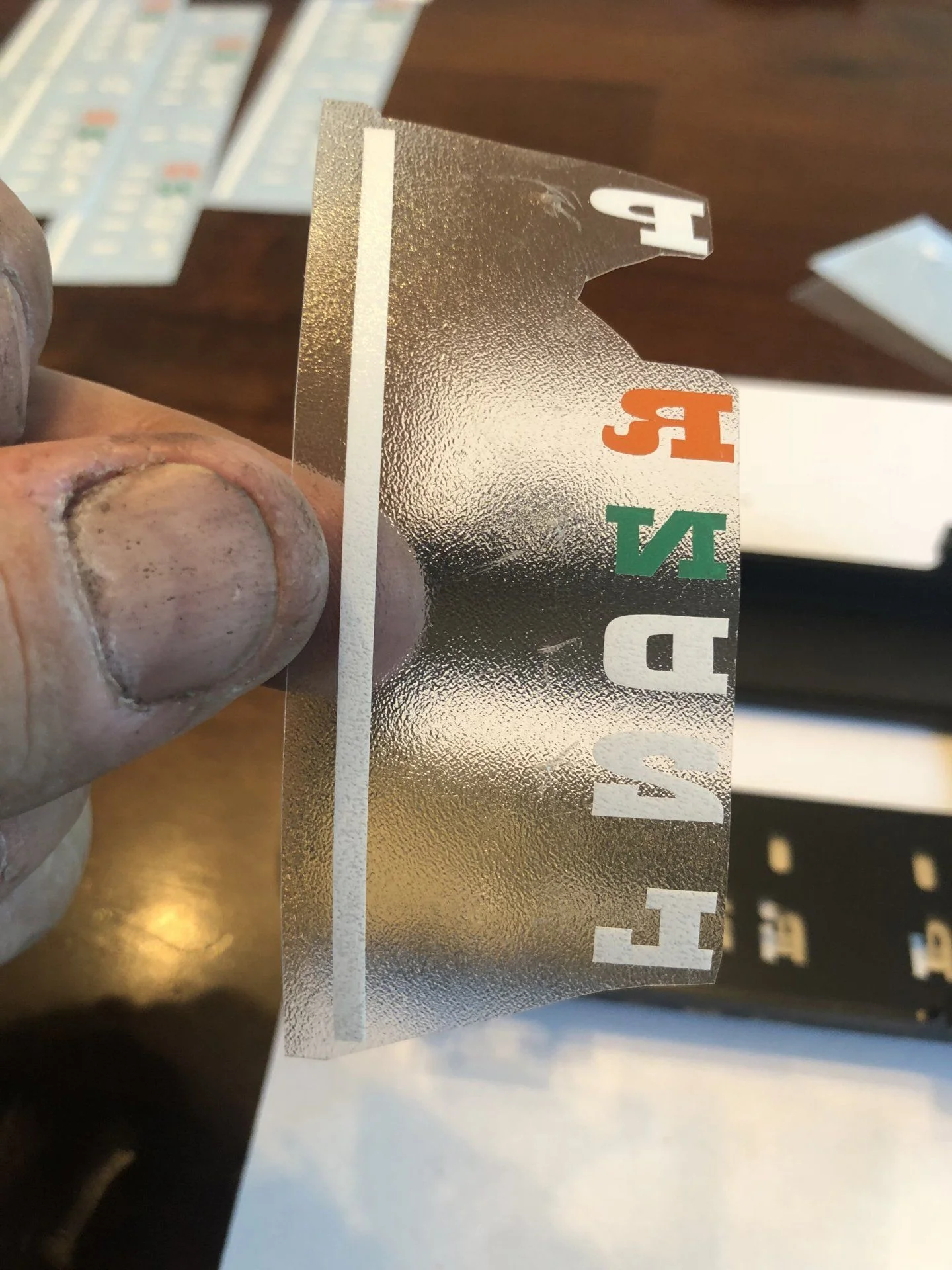

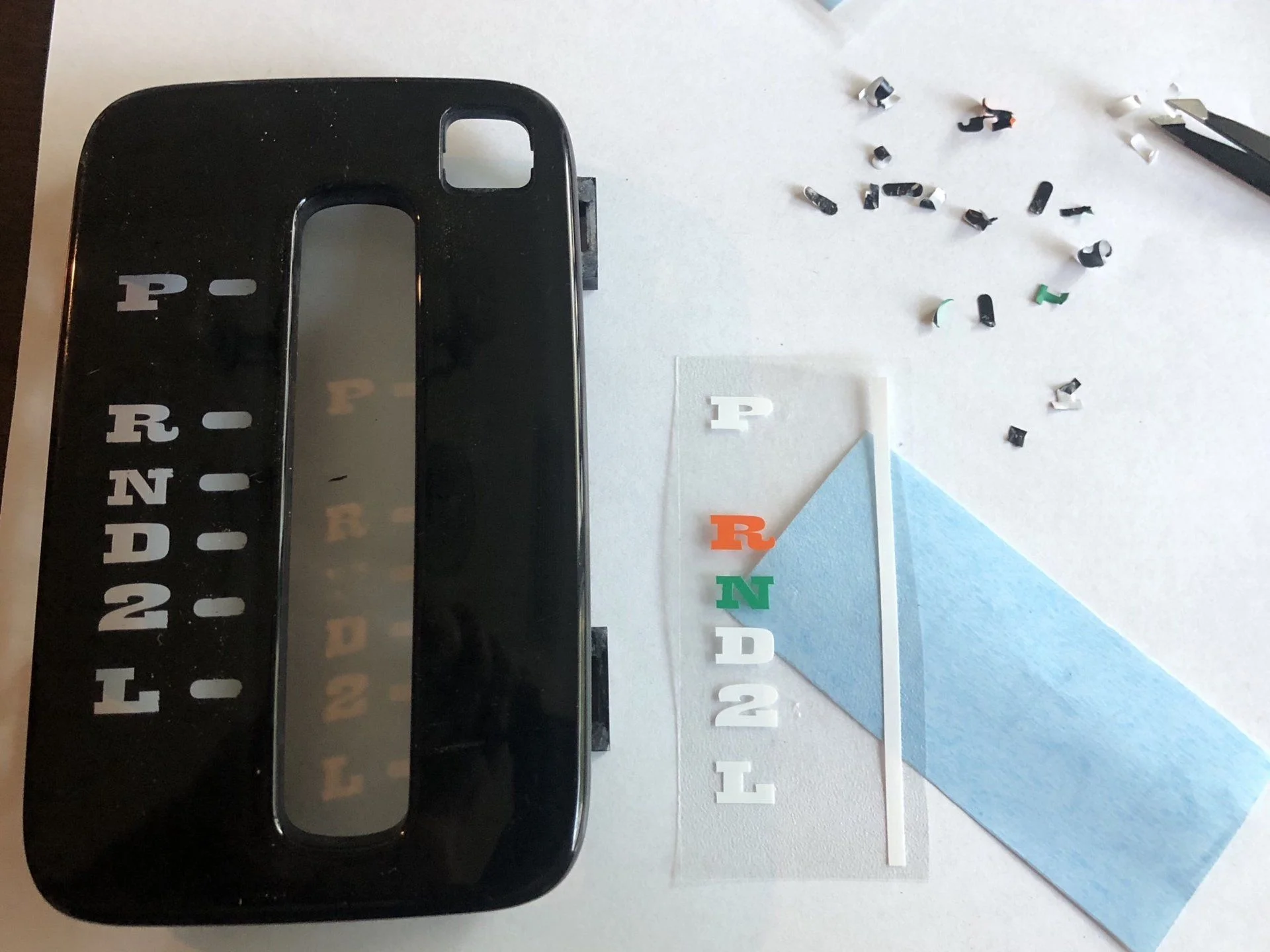

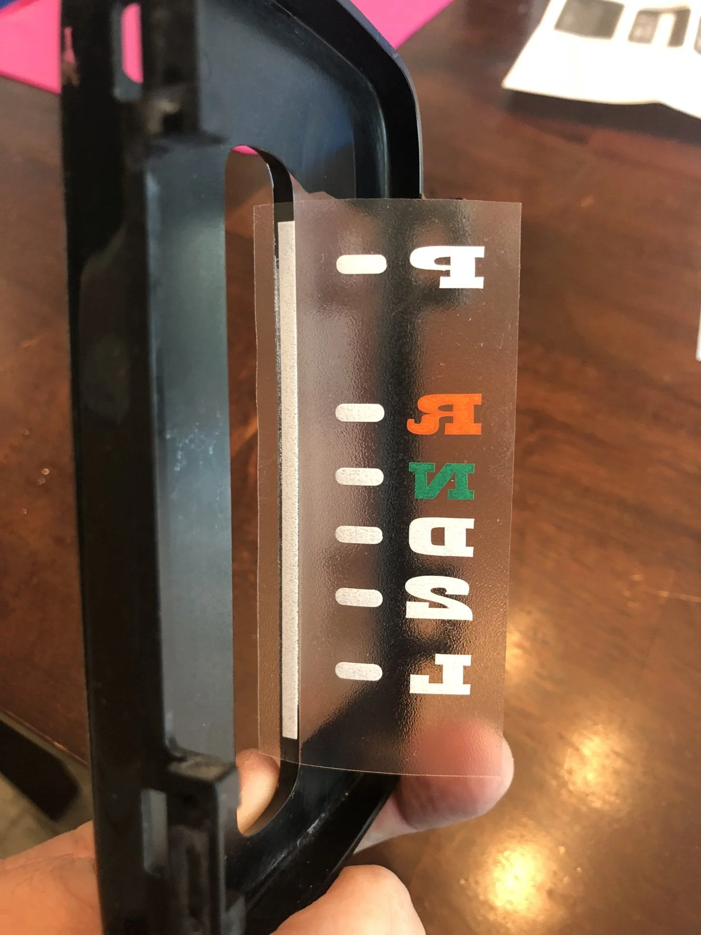

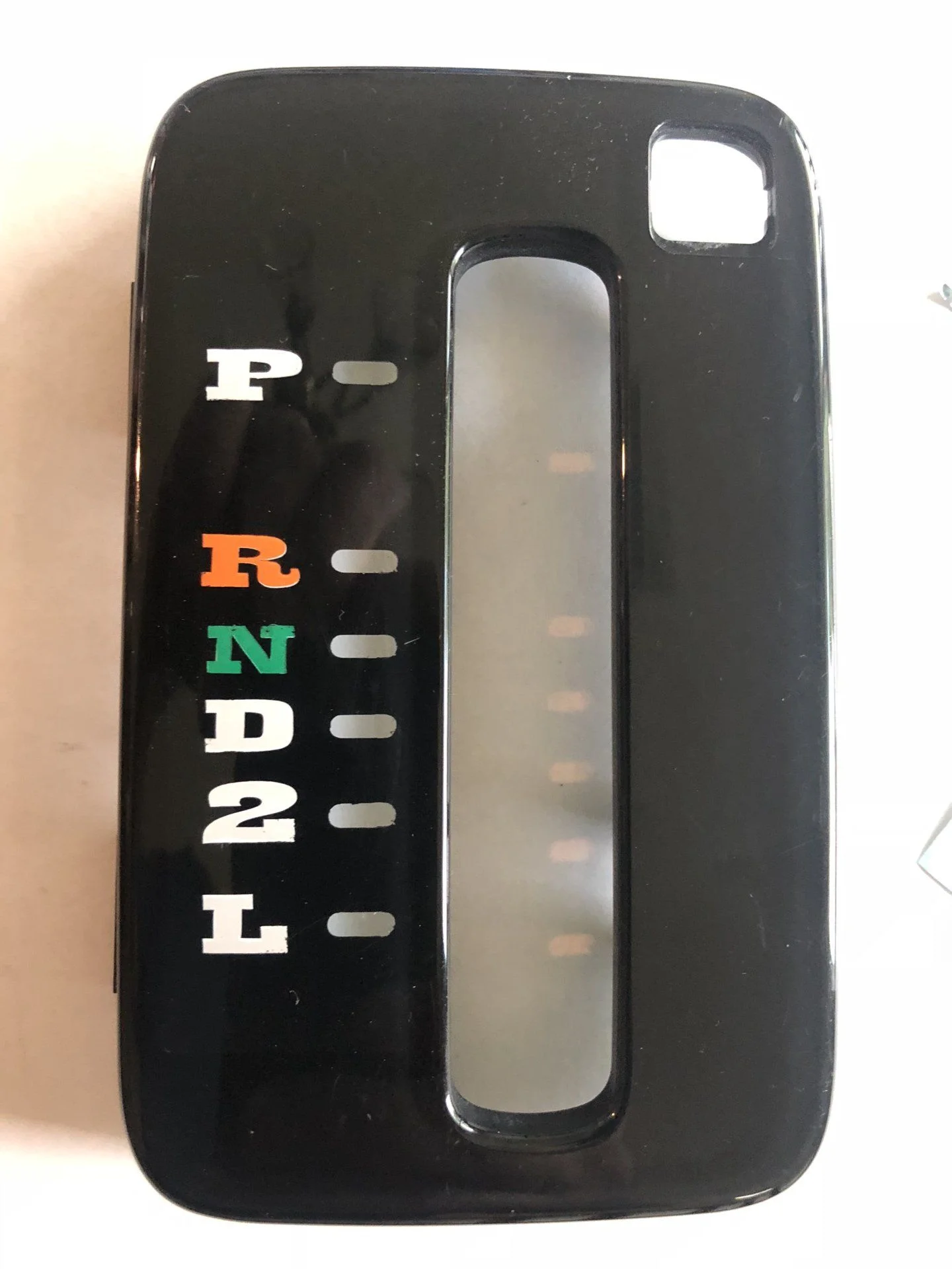

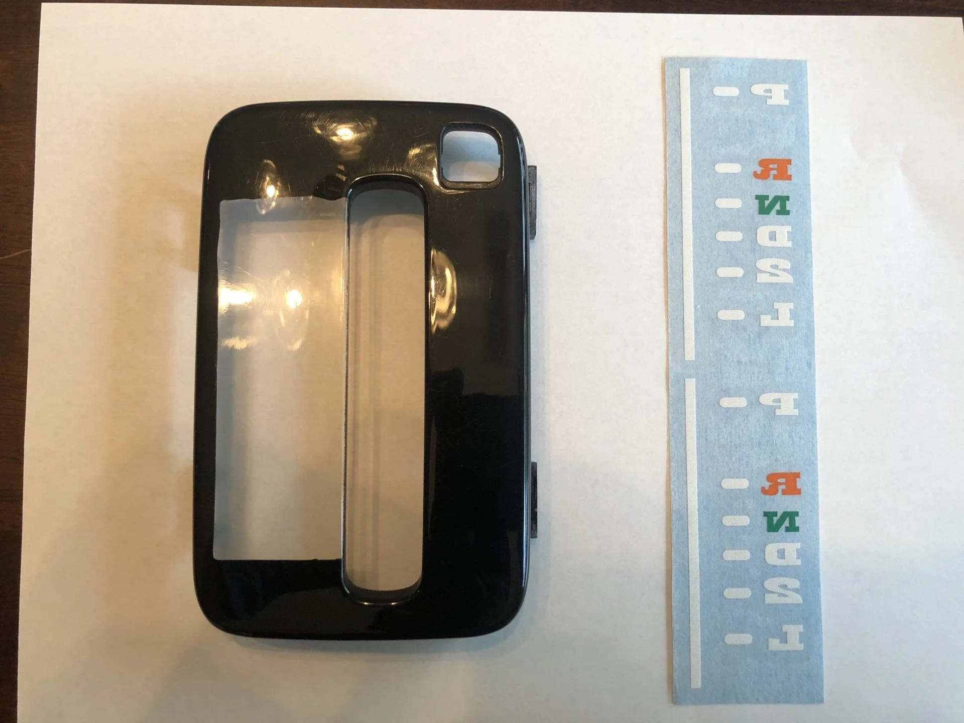

So I got the stickers back from my brother.
He sent me 5 different fonts; Land Cruiser emblem script, Arial Bold Italic, the Factory Font, Helvectica, and Playbill. I like the Playbill one so I used that.
I started by removing the decal area by soaking it in Purple Power for a couple hours and scrubbing with a toothbrush and wet sanding it with 1000 grit then polishing the whole piece.
Then I removed the vinyl sticker and used the alignment marks my brother made to line up with the bottom of the original decal and stuck it on.

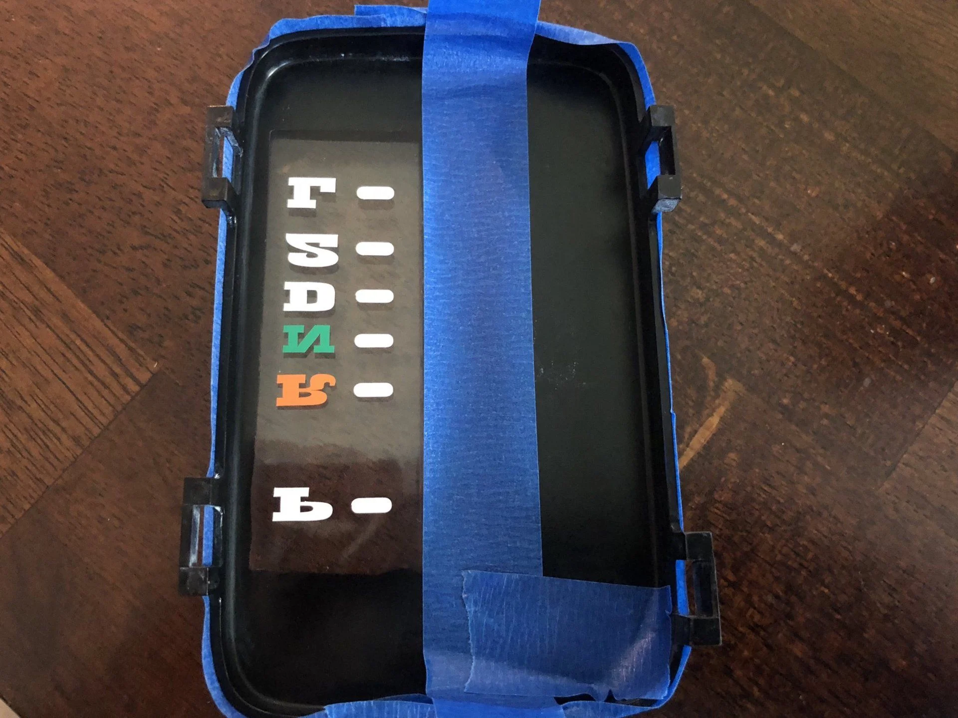

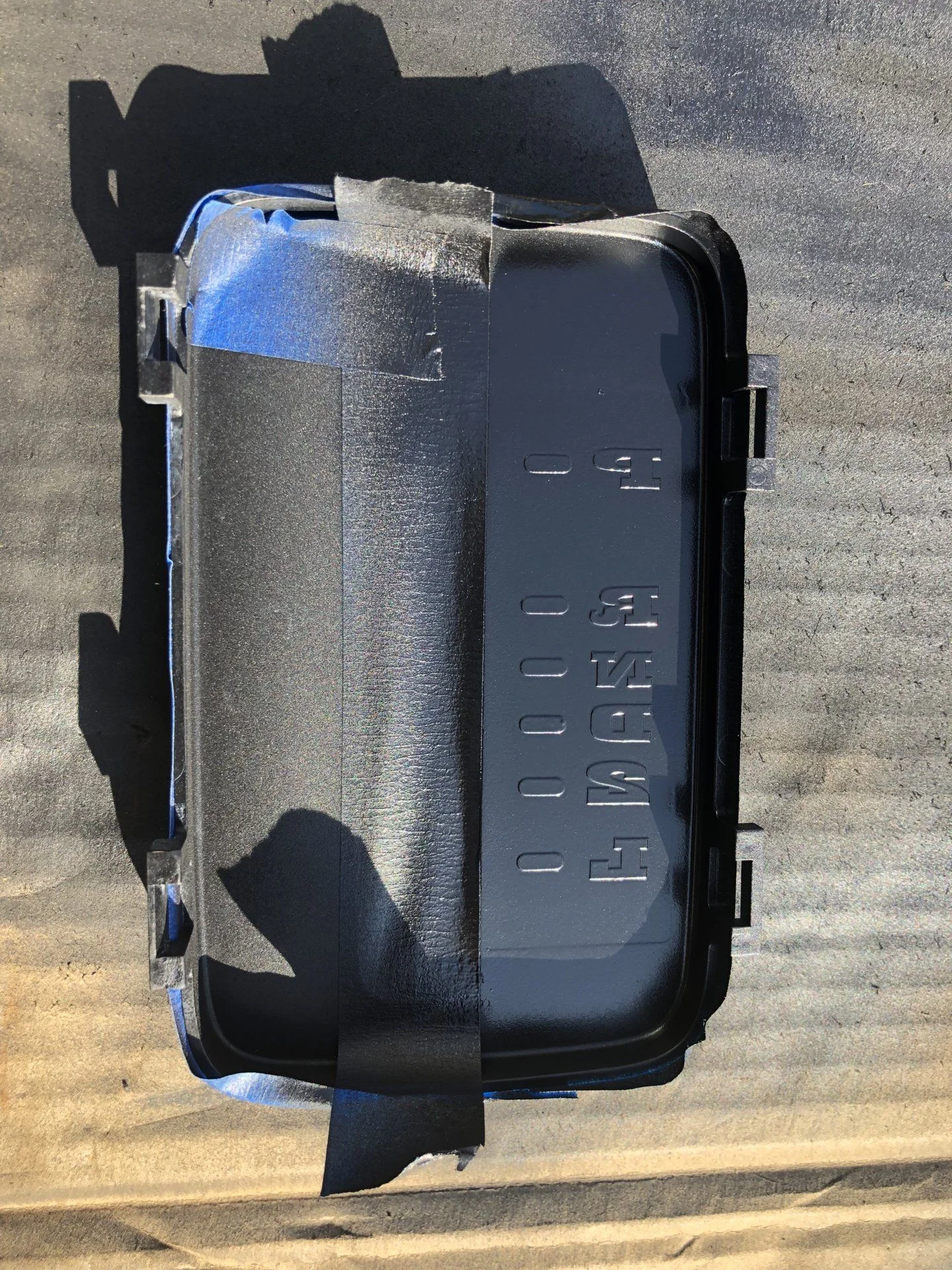

Then I taped it up for painting
And shot it black

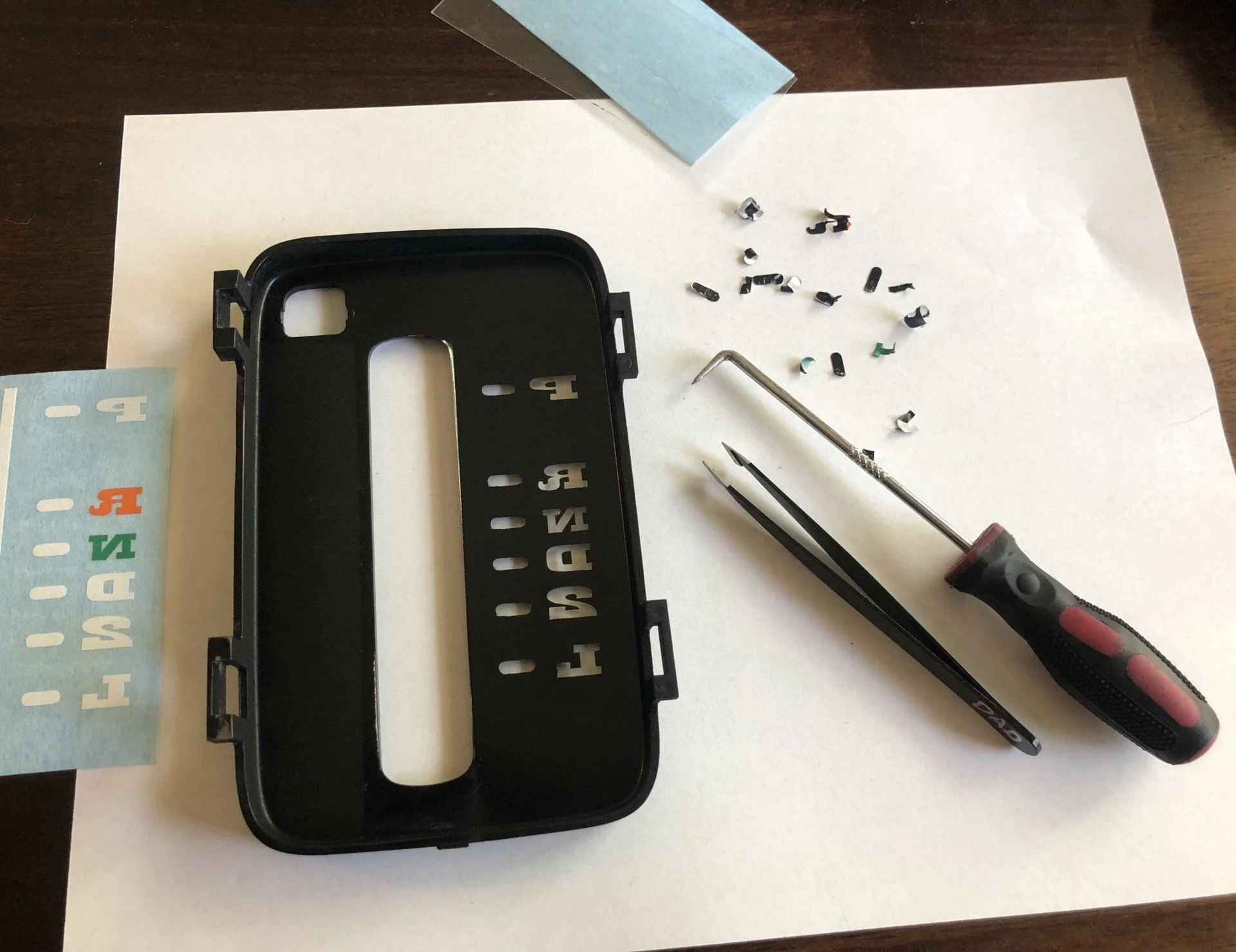

After it dried I took a dental style pick and scrapped of the decals
The prepped the second sticker
I put the second sticker on the alignment marks and maneuvered it until perfect. I cut out some of the extra vinyl so it would not peel the paint (advice from bro and he does this for a living).

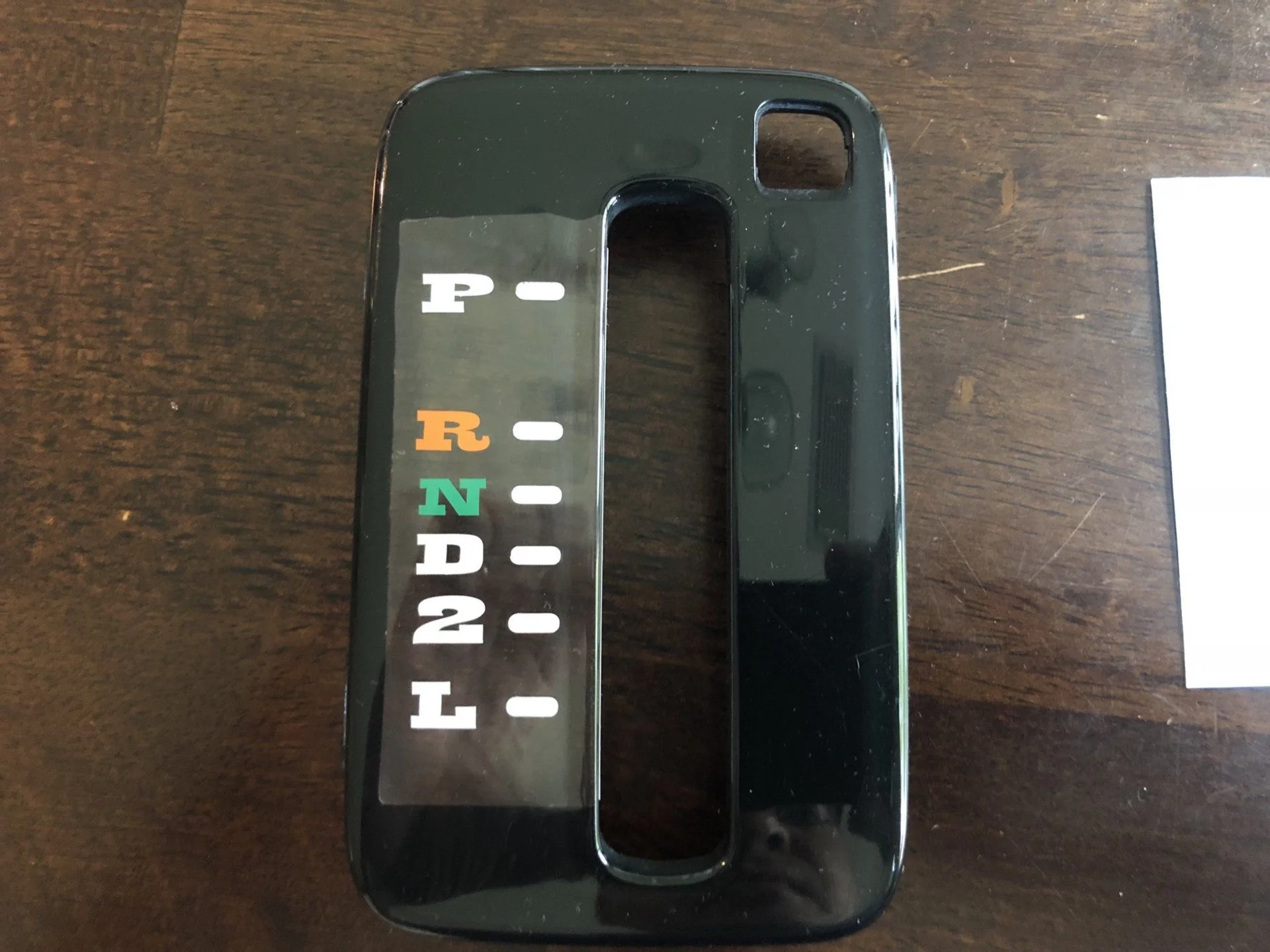

All done and looks great. The black colors are not exactly the same but it is very close.

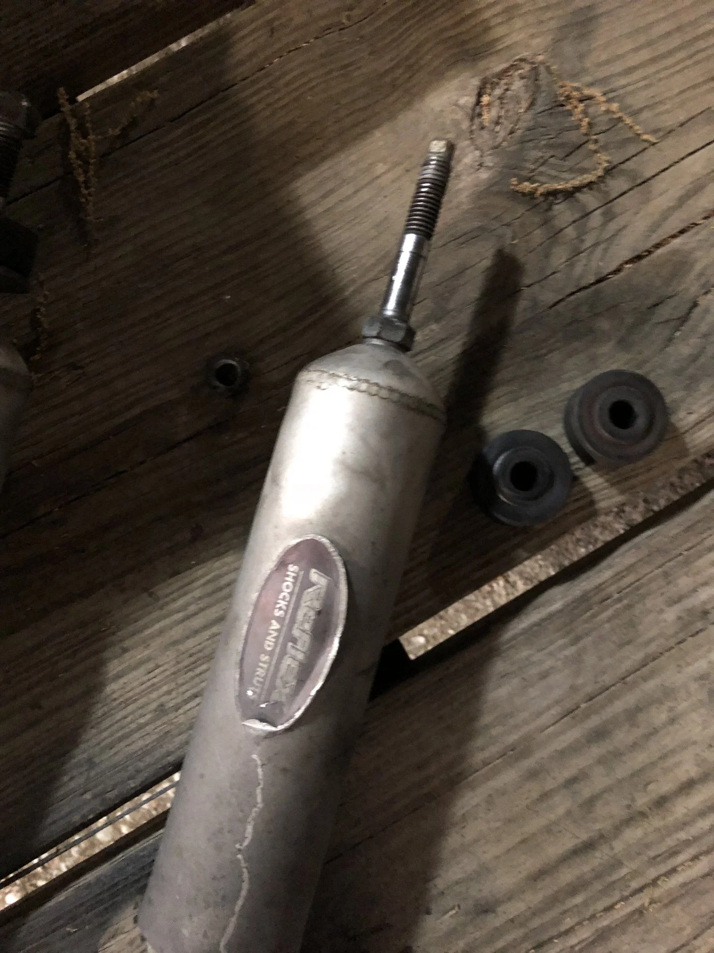

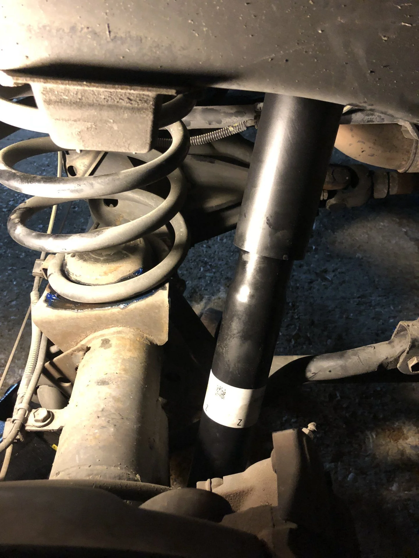

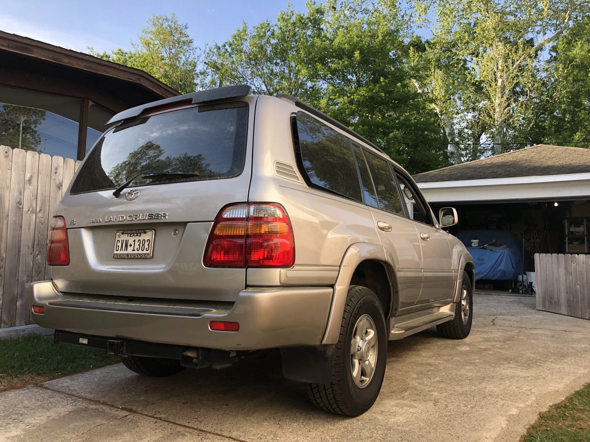

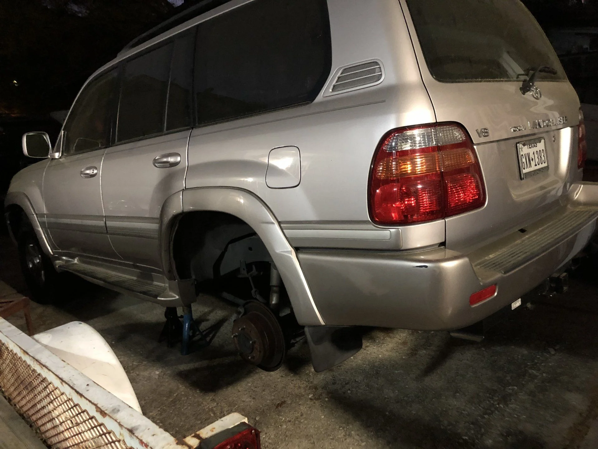

Last night around 8:30pm I decided to look at the rear suspension. Jacked it up, looked straight forward, so I grabbed a beer and started. A couple hours later, I was done. That top shock bolt was a little tough on the first one, but a ratcheting wrench made it easy. Had to hold the body of the shock with a strap wrench. They had been changed out before to “Reflex” brand. I put the 1” Poly spacers in too. I did not put the wheels on as it was around 11pm and the neighbors just had a baby and didn’t want noise... I can’t wait to put the wheels on and drop it...
The old shocks had a hex on the body to back it up which was nice. This is an extremely rust free truck.

While I was back there I cleaned out the diff breather and examined parts for wear. I think some sway bar bushings and all brake hoses are due for repair.

Well I need to continue road testing so I toll her to work today even though I haven’t cranked the front up and she made it (last time I tried, she didn’t). Those new rear shocks got all the ‘ass-heavy’ bounce out. The other shocks were replaced at around 120-130k miles which is awful life for any shock (I have 163k now).
I have ordered the Whiteline poly steering rack bushings as the steering feels mushy. The typical sweeping turns that set the VCS off did not this morning either due to the new shocks or the extreme rake. Also, ordered 5 new Brake Hoses.

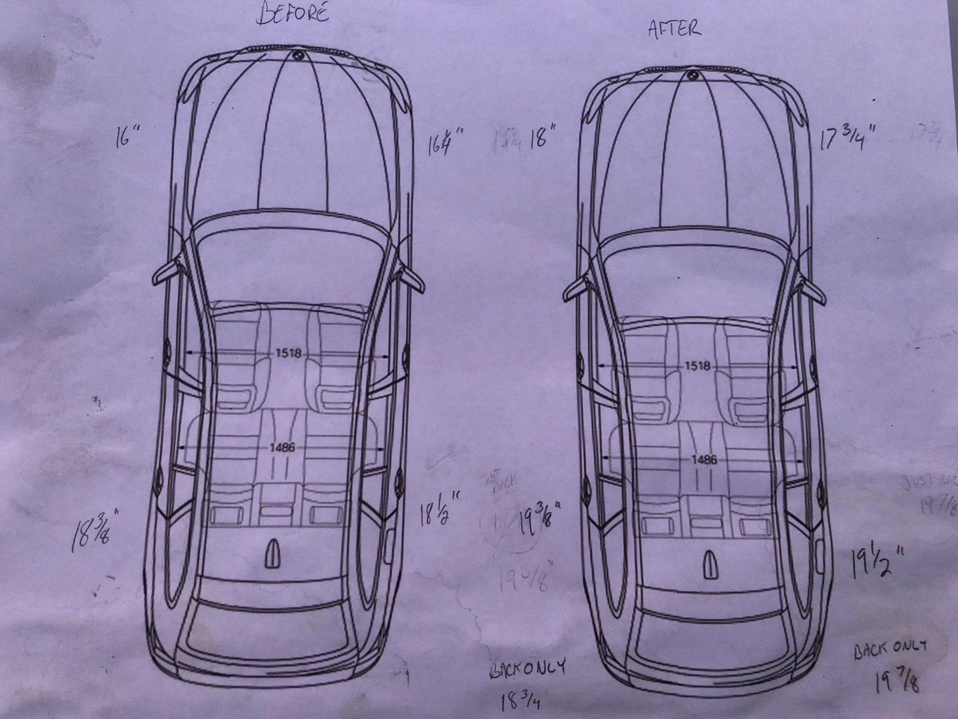

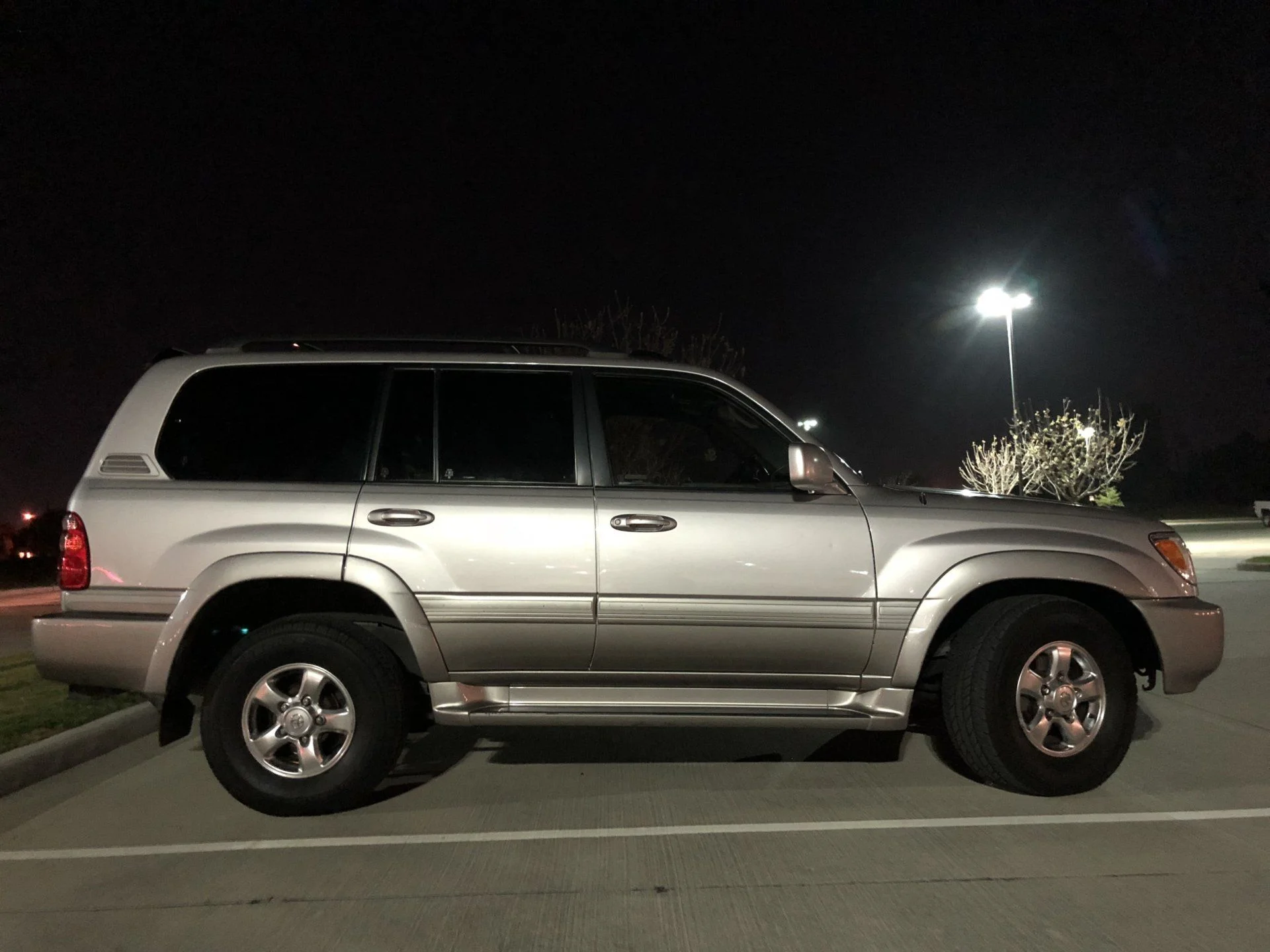

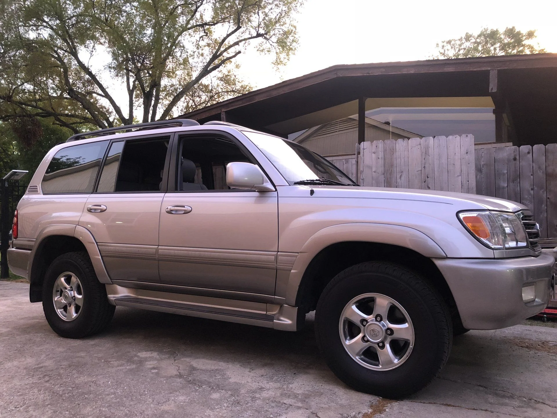

I got the front up some today. I think I need to index the torsion bars. They are cranked to the max. I got a full 2” on the driver side (that was sagging a 1/4” from the passenger side) and 1-3/4” on the passenger side. The back could not be a truer 1” lift. I also did the front shocks.
(Measurements done from 12 o’clock on the center cap straight up with a level to the bottom of the fender flare lip)
Confirmed I need front brake lines and sway bar bushings. I also feel play on the inner tie rods. I could not get the ball joints or wheel bearings to give me any substantial movement. All boots (BJ and CV) look great and dry. I sprayed them with 303.

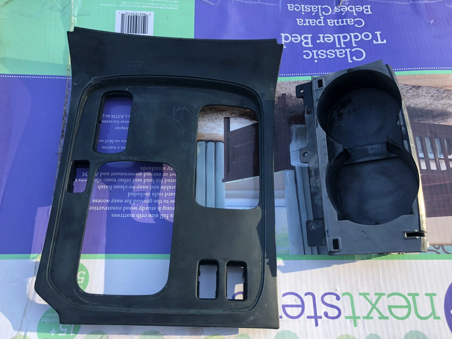

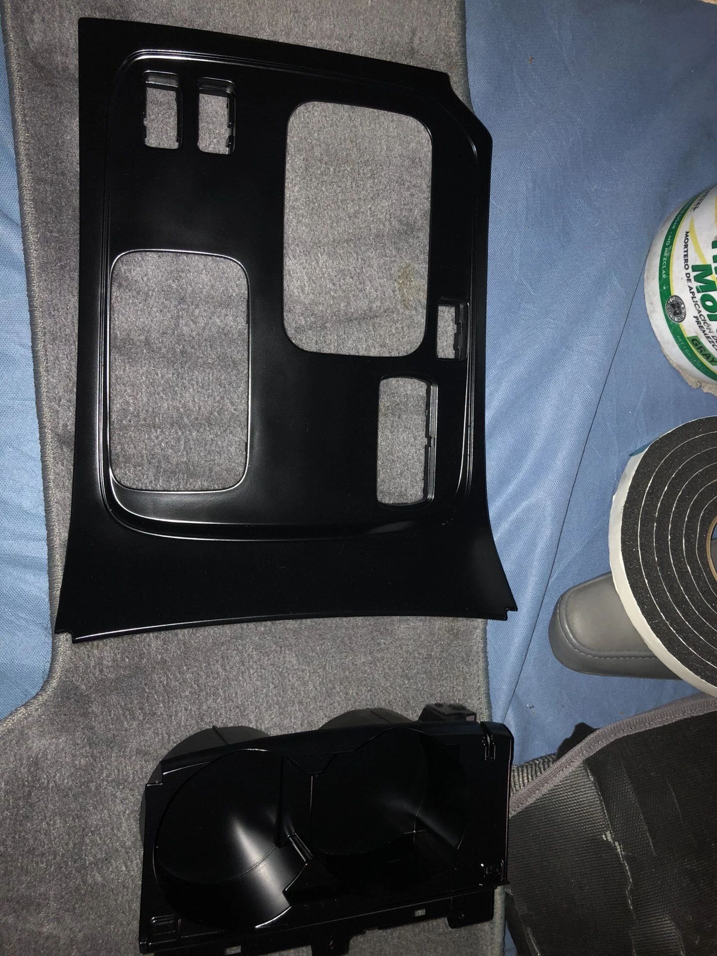

Nice day today. I re-primered the center console and painted semigloss black.

Looks nice. Check your tire pressure and remeasure and bring the drivers side down the 1/4" to match the other side and you'll need an alignment or you will start to scrub your tires.
