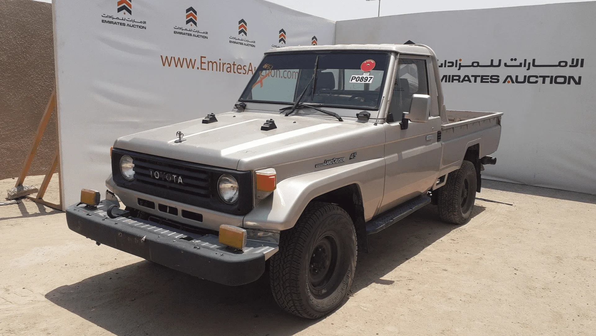

But the other day I was sitting with my older boy and chatting with a friend in Abu Dhabi over Whatsapp (he has an 80 he's putting back into service). I've be sharing a lot on my battles with the 93 model 80 here in the garage in Virginia. Anyways we sometimes chat about ads we'd noticed for cruisers and for some reason a string of mid-90s pickups had been going through Emirates Auction. I wasn't shopping. And I saw this lonely old fellow:

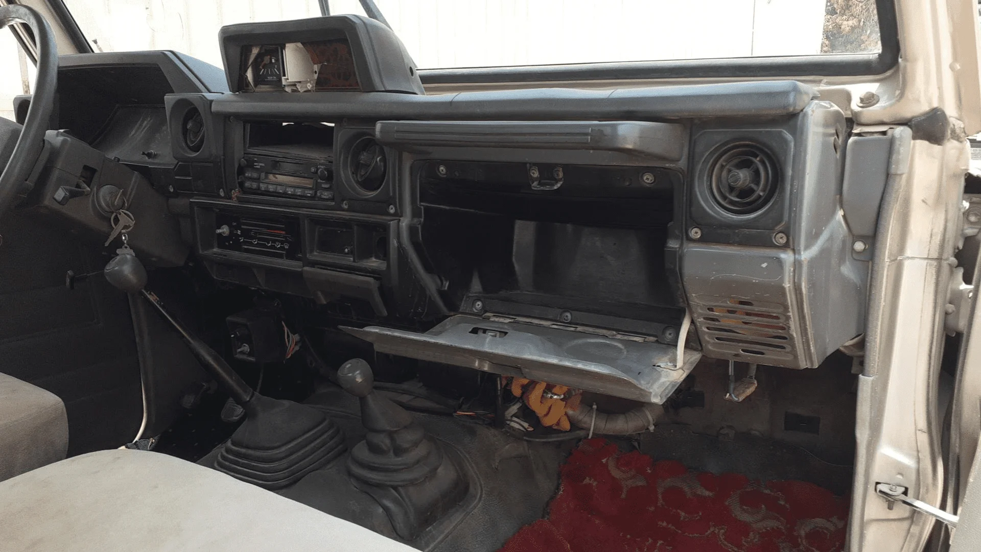

487K km (300K miles) on the clock, and that's a lot. But it has the fold-down windshield that I like, and it looked pretty straight from the photos. And perhaps most significantly it had AC, and some extra fittings in the cab under the dash that suggested it was a government truck, hopefully indicating it had regular maintenanc.
The bay engine did not look messed with:

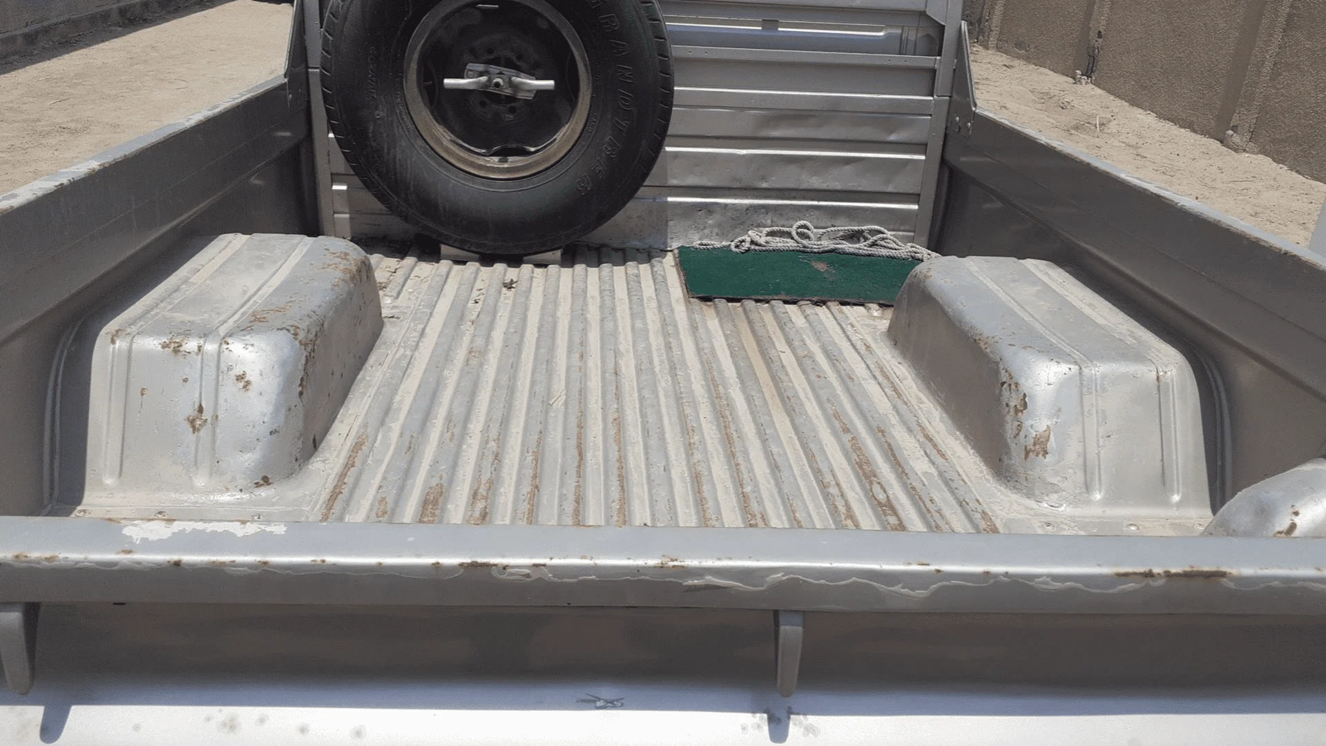

The bed looked pretty good:

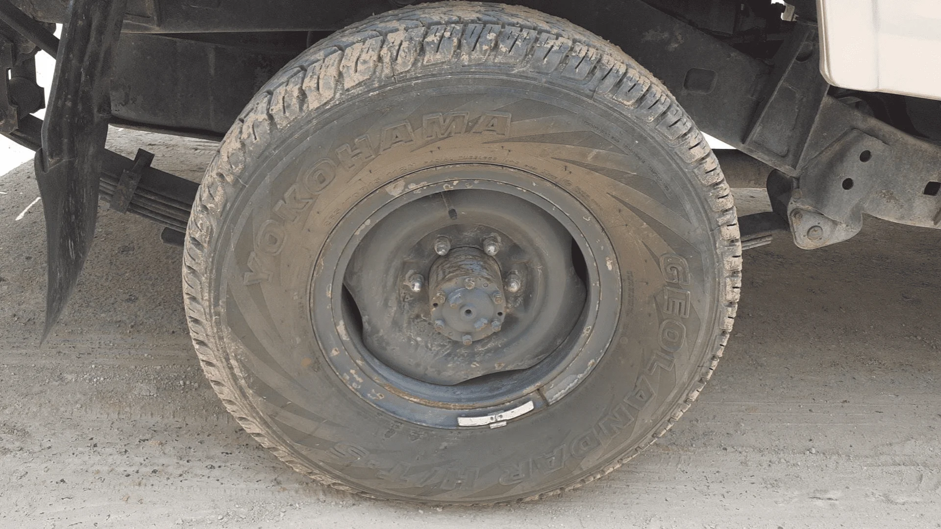

And surprisingly it even had Yokohama Geolanders on the split rims. Mostly what you see on these old pickups are really cheap tires, so this was quite unexpected. I'm sure they are out of date and need to be replaced, but someone had some budget with this thing.
I guess I kind of saw a diamond in the rough. The bidding stayed pretty slow until the last few minutes and I had some fun bidding in 100 AED increments (about 30 USD). The way they run these auctions is that if a certain number of bids come in in the last five minutes they extend the auction for another 30-40 minutes. Very annoying as a bidder, but probably they get a bit more money that way. The auction got extended and I put in my final bid and either the other bidders got bored or went to dinner or something, or I overbid, but I ended up being the high bidder. (I don't want to publish here what the price was, because I might end up selling this truck at some point, but if you are really curious, PM me.)
I like the look of this one. The telling will be when my mechanics get their hands on it and start going over it.

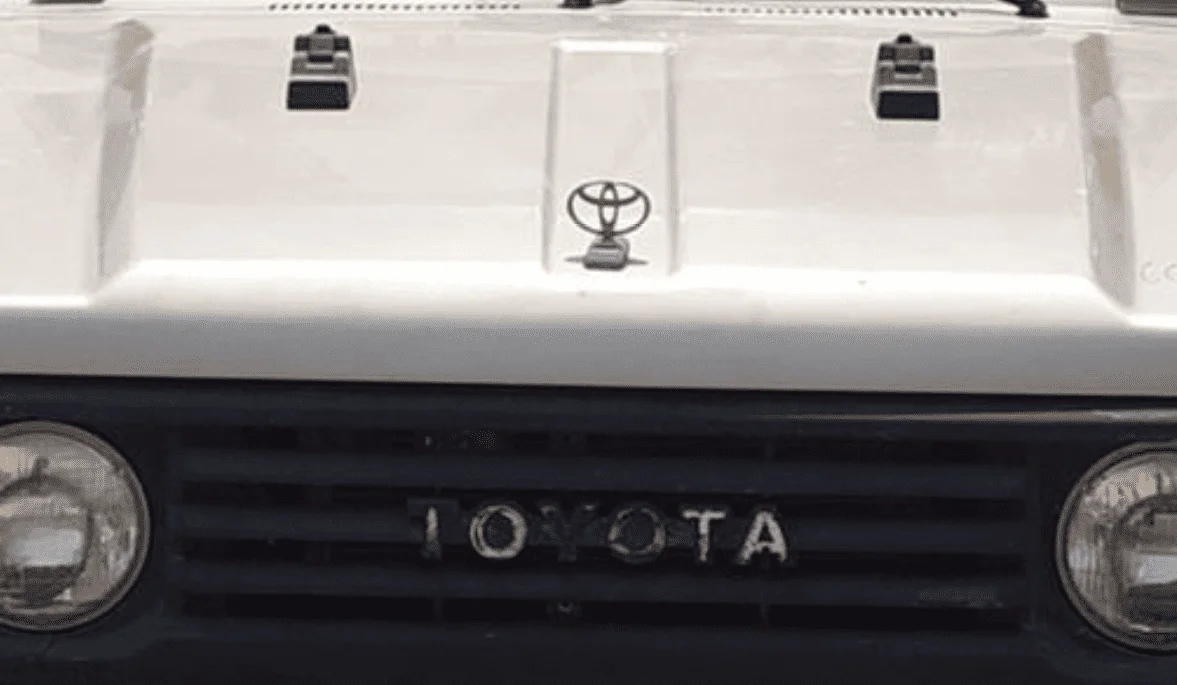

In case you were wondering about the name in the subject line...
I think I might actually black out the 'Y' and 'O' completely.

The existing bed is not terrible.... Maybe I will just let them do some body work on the existing bed if I cannot find a aluminum tray.... Thanks for the feedback!
Unless the bed has issues that are evident in the photo, why not clean it up and spray a bed liner type material?

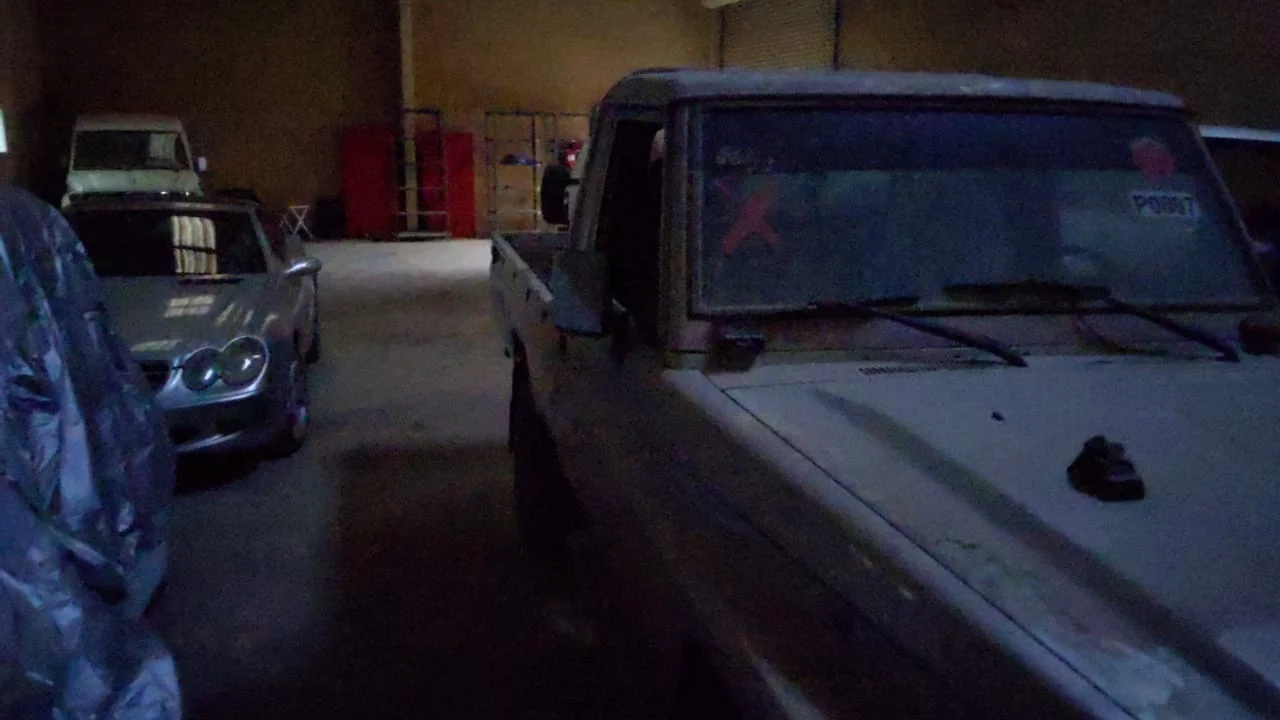

My younger boy reminded me that I have not posted much about 'Iota'. The guys had moved the truck into the warehouse space after sitting out since last September.

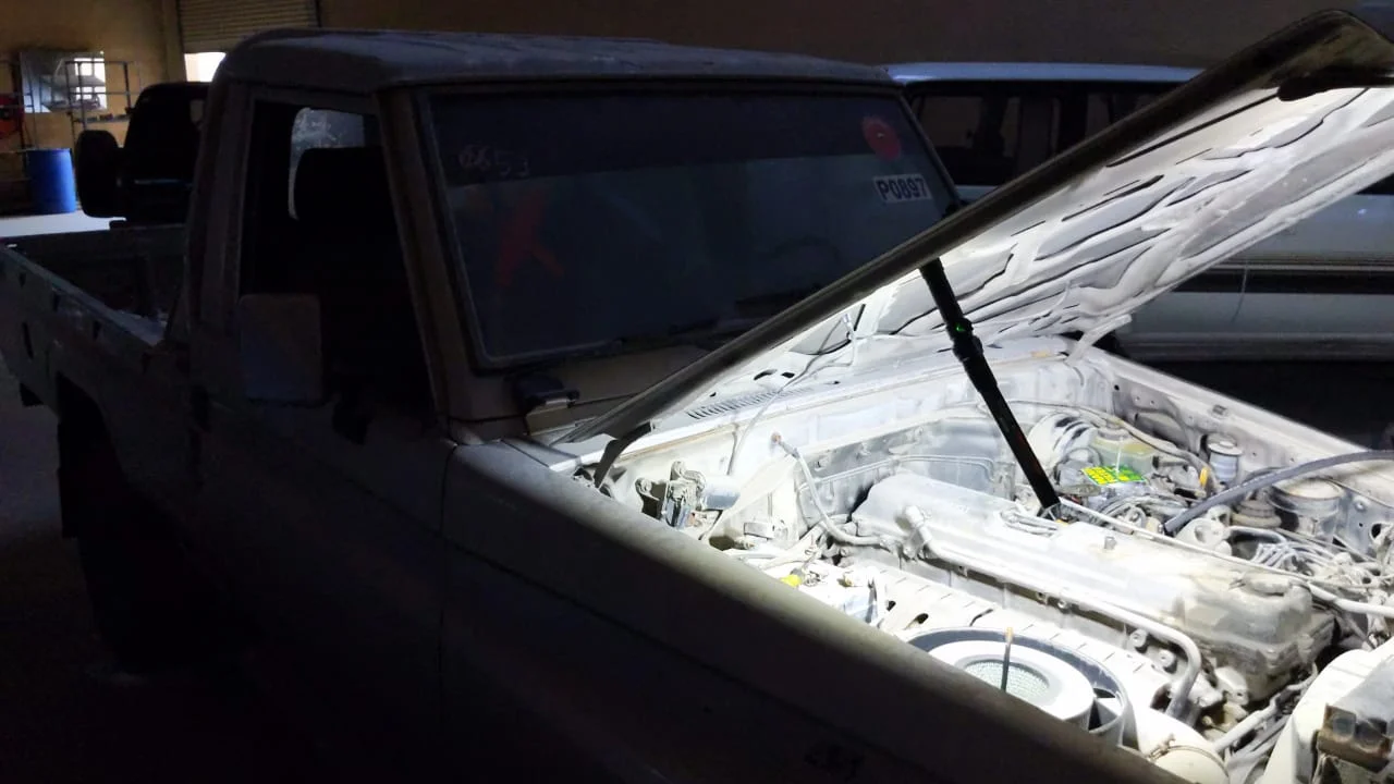

So at least the old fellow is out of the weather. I've started poking at it a bit. When I opened the hood I found the carb was missing. At first I was not sure if it had a carburetor when I bought it at auction, but it turned out that lacking any specific instructions the guys had gotten started on it. The carb is back in the truck now.
No we don't have power in the warehouse unit yet. This light is from a pair of fantastic Braun work lights.
Jobin (the owner) and Arjun (his foreman) told me that the were checking it over and found that the gas was bright red. The've drained the tank and now have rebuilt, at least partially, the carb, and they are getting ready to turn it over and see what we have. But this is a 1FZ that had been in government service an likely had received at least some maintenance so I'm hopful this will go well.

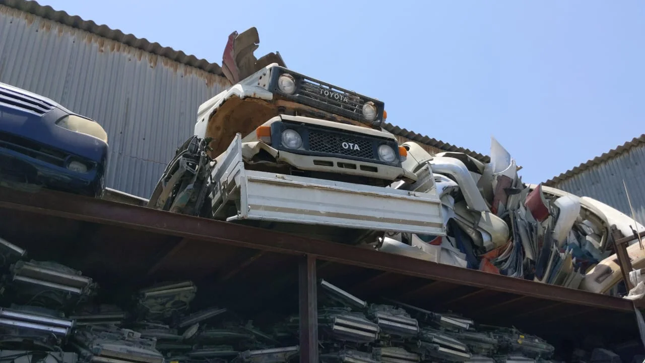

I've started thinking about what I want to do with this truck, changes wise. The tailgate is a mess with lots of filler. It needs to be replaced entirely. I've always liked the AUS drop-side trays and I'm mulling over swapping the bed out on this old pickup. During my trip to Sharjah last weekend I saw a couple of possible candidates.
You can see it peaking out behind there in the back. This is a steel tray, not aluminum. But it also seems to be old enough that it might be a direct swap in without having to worry about the frame rail spacing.
Then there is this fellow here. Aluminum. I spoke to the owner of the yard and he says he pulled it off a 2010 truck. I'm going to have to educate myself more on this. Both steel vs aluminum and the frame rail spacing. I expect to go back up to Sharjah on Saturday for a closer look. I've also got a list of other stuff I'm searching for including a new aircon / heater box for the troopy which was stripped out and used to get Golden Boy going and comfortable for the US weather conditions before we shipped it over.
Just in case you aren’t aware of this, remember that the 79 bed is 4” longer than the 75 bed, this extra length is in front of the front body mounts.
HI CT, all I knew was that the frames were different and the rear axel is in a different location. I did not know about the length. I'm going to study up (here) on all this.
I believe the added length in the frame was done between the rear cab mount and the front bed mount, I not sure on the exact extra length but I know the bed is 4” longer on the 79 and the cab I believe is also 4” longer, so if you add the empty space between the bed and cab total extra length should be around 9”-10”.
