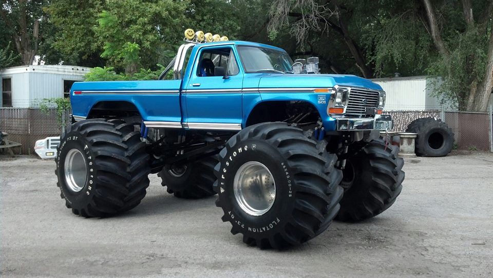

I see images of people putting 33" & 35" tires on them how can they not do 75 with regular tires? s*** s*** s***.
Wow! Look at this truck with big tires - do you think it will go 75?
If you want speed, get a sedan. :steer:
I was kind of kidding but I dont consider 75 exactly high speed.
Seems like that engine would be taxed by adding larger tires.
