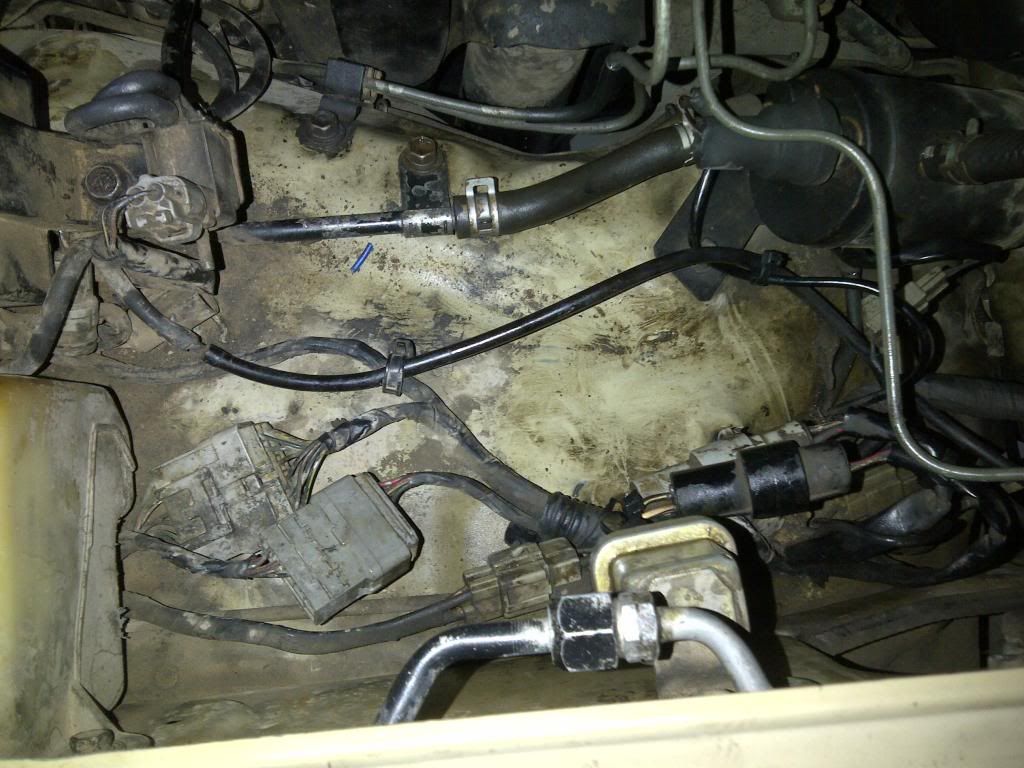

I'm going to try to get the wiring cleaned up tomorrow, and after taking a closer look at the current wiring I'm dreading the job.
Anyone know what this whole spaghetti mess is for? Its located on the DS inner fender.
A closer look.
Also, would greatly appreciate it if someone with a HZJ80 can snap a pic of their fuse box. This is what mine looks like
Much appreciated!
That wiring on the fender has almost certainly been added or modified by a previous owner.
Agreed, looks like some sort of knob on that box wrapped in tape.
Thanks guys. I did notice a set of xenon bulbs in the glove box when I got the truck. I am assuming the PO had them on as headlights at some point before removing them. Whats the best way to go about removing those wires without tripping anything? Or best to leave it be and just clean it up?
I'd start by tracing them and figuring out what it's for before I started removing it. It might be something that needs cleaning up rather than removal.
Got help from an electrician on this and we managed to clean up the area. Turns out that mess was some kind of mod the PO did for the heater block or glow plugs if I am not mistaken. We removed it altogether.

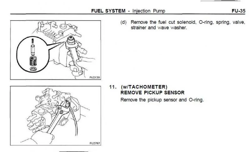

Ok so we hit a bit of a stumbling block when it came to installing the tacho pickup sensor. We cannot locate the bolt on the engine side of the fuel injection pump. I've attached a pic of it, with an arrow for reference which is where we expected to find the bolt. This is not a threaded bolted. (allen key bolt?). How do we remove this?
So I checked the part number, and lo and behold we discovered that there are two part numbers for the FIP housing: one for the tacho pickup sensor, and one without. Am I reading that correctly?
So either we can deduct two things: this rig came with a poverty pack and had no tacho on the gauge, and the PO went and installed a tacho gauge only to realize it didnt work. Or, it came with a tacho gauge, and the PO had the FIP housing changed at some point, and they installed the wrong housing?
Where do I go from here:crybaby:
I did reply in you thread in the Diesel section .. but the resume is, you can open your IP without rebuilding it .. usually you would like to do that due to the sickness " while I'm in there " coz diesel IP labor aren't cheap at all .. but maybe your Lab will open it change few seals, thread your IP body to accept tach sensor and you will be happy for less than 1K on labor and parts ..
