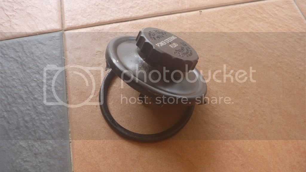

OK! I don't know if you guys facing the same problem as I am, this PS reservoir seems have leak on the lip of the tank.:confused: Any cure for this? Quite a frequent case for this reservoir tank.
The opening of the top cover.

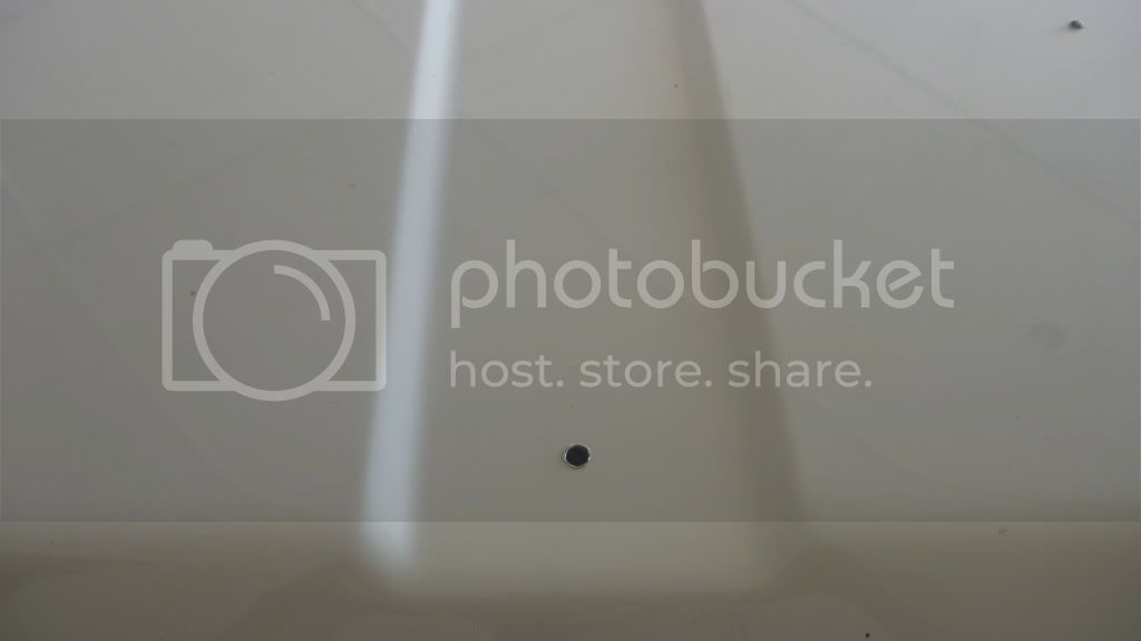

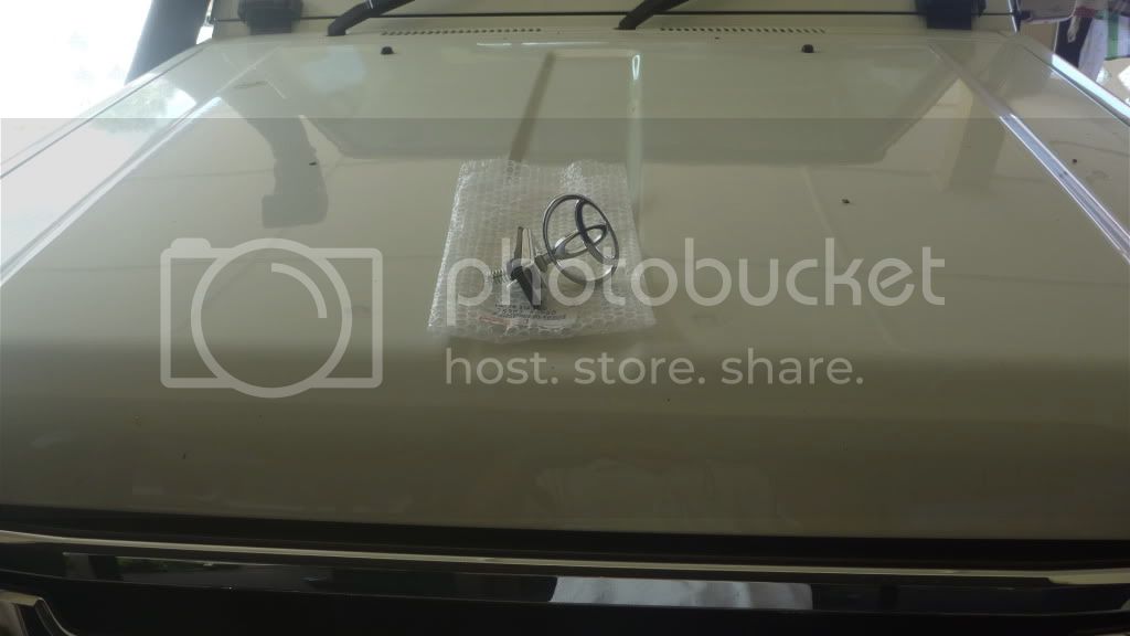

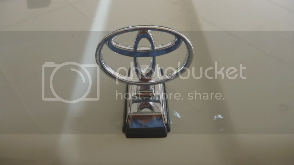

i have that emblem on the hood of my 75 pickup, i can go measure it for you tomorrow if you like...
