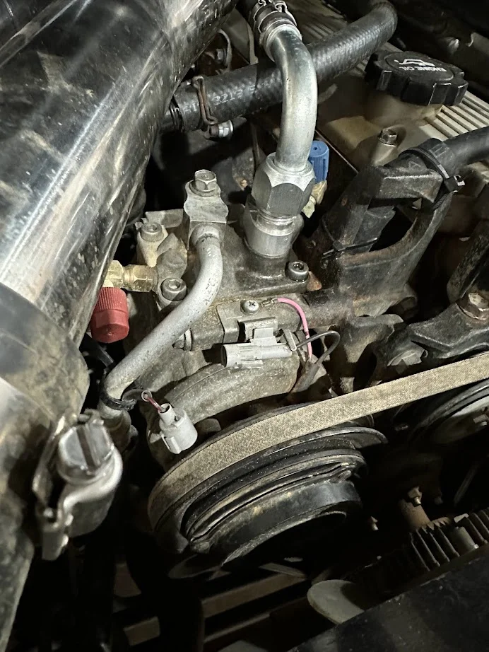

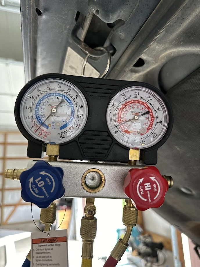

I bought this cruiser with a Turbo kit installed, and the AC lines never installed or rerouted. So I just finished hooking up the new hoses, installed a new drier, and added some oil to the suction side of the compressor. When I tried to run the compressor, the clutch was not kicking on when turned on. Fuse is good, so I hot wired it to attempt to charge the system. Pulled a vacuum, but both high and low sides stayed consistent with pressure. Should I look at maybe rebuilding this compressor or maybe I'm missing something here?

Just looking at your photo, you have an obvious leak leading to moisture visible at the fitting and the allen bolt. I have the same situation. I've been told this is a matter of replacing internal gaskets and O-rings. These are available from Radd Cruisers. A/C O-ring seal kit for Japanese vehicles - https://radd-cruisers.shoplightspeed.com/ac-o-ring-seal-kit-for-japanese-vehicles.html
That being said, it may not be that simple, and cracking into the compressor worries me. But your system isn't going to work with that leak, not for long anyway.

I do not recall the numbers for refrigerant and oil, but if your vacuum test was good, throw a charge in it and then test again. I believe the numbers are posted somewhere here on mud. Best of luck, :cheers:
I installed a new dryer with a Site glass, added the oil per the manual, and attempted to recharge again. Still same results, I think I may take the top cover off the compressor and inspect for damage?
