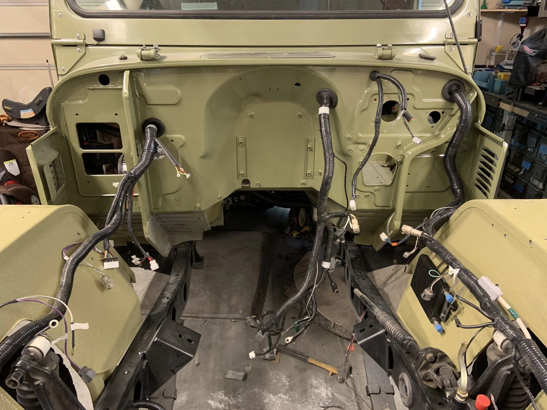

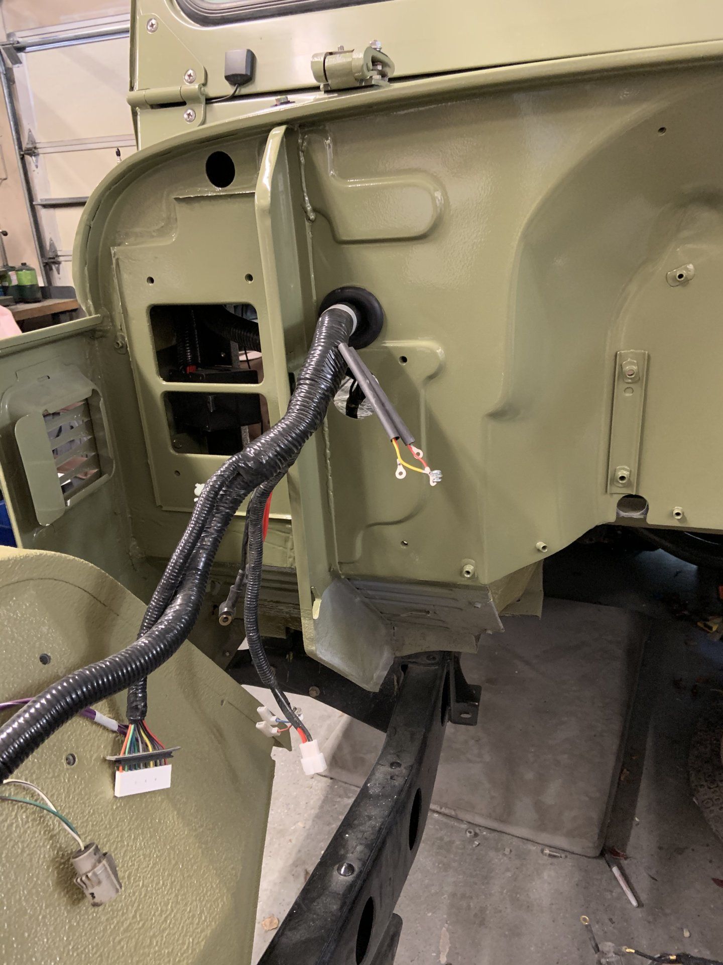

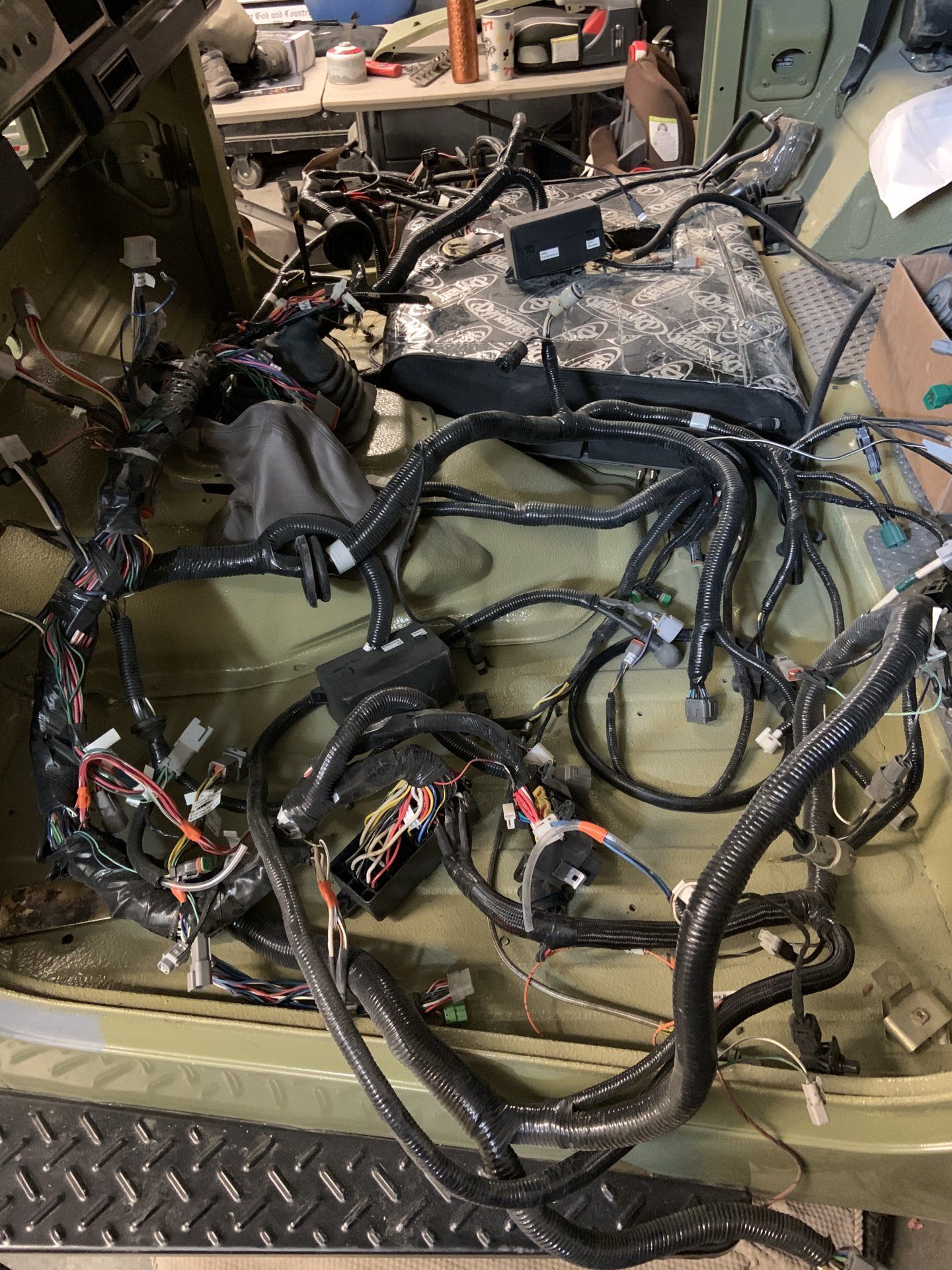

I’m working on re-installing the behemoth wiring harness and AC evaporator. There’s precious little room under this dash to routing everything is a not-so-fun chore.
sheesh:
View attachment 2131270View attachment 2131271View attachment 2131272View attachment 2131273
eeeeekkkkk! That gives me nightmares - currently finishing my very easy and very clean Coolerman wiring harness rebuilt in a '76 with just a few add-ons. This is nightmarish.
